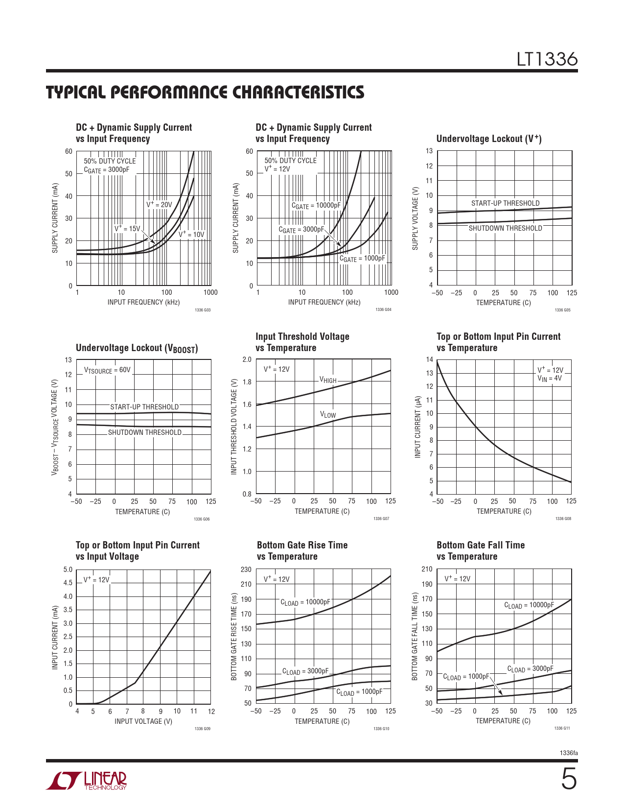

Typical perForMance characTerisTics. DC + Dynamic Supply Current. vs Input Frequency. Undervoltage Lockout (V+)
Typical perForMance characTerisTics DC + Dynamic Supply Current vs Input Frequency Undervoltage Lockout (V+)
LT1336
Typical perForMance characTerisTics DC + Dynamic Supply Current DC + Dynamic Supply Current vs Input Frequency vs Input Frequency Undervoltage Lockout (V+)
60 60 13 50% DUTY CYCLE 50% DUTY CYCLE C V+ = 12V 12 50 GATE = 3000pF 50 11 40 40 10 V+ = 20V CGATE = 10000pF START-UP THRESHOLD 9 30 30 V+ = 15V C 8 GATE = 3000pF SHUTDOWN THRESHOLD V+ = 10V 20 20 7 SUPPLY CURRENT (mA) SUPPLY CURRENT (mA) SUPPLY VOLTAGE (V) C 6 10 10 GATE = 1000pF 5 0 0 4 1 10 100 1000 1 10 100 1000 –50 –25 0 25 50 75 100 125 INPUT FREQUENCY (kHz) INPUT FREQUENCY (kHz) TEMPERATURE (C) 1336 G03 1336 G04 1336 G05
Input Threshold Voltage Top or Bottom Input Pin Current Undervoltage Lockout (VBOOST) vs Temperature vs Temperature
13 2.0 14 V V+ = 12V 12 TSOURCE = 60V 13 V+ = 12V 1.8 VHIGH VIN = 4V 12 11 10 1.6 11 START-UP THRESHOLD V VOLTAGE (V) LOW 10 9 1.4 9 8 SHUTDOWN THRESHOLD TSOURCE 8 7 1.2 – V INPUT CURRENT (µA) 7 6 6 V BOOST INPUT THRESHOLD VOLTAGE (V) 1.0 5 5 4 0.8 4 –50 –25 0 25 50 75 100 125 –50 –25 0 25 50 75 100 125 –50 –25 0 25 50 75 100 125 TEMPERATURE (C) TEMPERATURE (C) TEMPERATURE (C) 1336 G06 1336 G07 1336 G08
Top or Bottom Input Pin Current Bottom Gate Rise Time Bottom Gate Fall Time vs Input Voltage vs Temperature vs Temperature
5.0 230 210 V+ = 12V V+ = 12V V+ = 12V 4.5 210 190 4.0 190 C 170 LOAD = 10000pF CLOAD = 10000pF 3.5 170 150 3.0 150 130 2.5 130 110 2.0 110 90 INPUT CURRENT (mA) 1.5 C 90 CLOAD = 3000pF 70 LOAD = 3000pF 1.0 BOTTOM GATE RISE TIME (ns) BOTTOM GATE FALL TIME (ns) CLOAD = 1000pF 70 0.5 C 50 LOAD = 1000pF 0 50 30 4 5 6 7 8 9 10 11 12 –50 –25 0 25 50 75 100 125 –50 –25 0 25 50 75 100 125 INPUT VOLTAGE (V) TEMPERATURE (C) TEMPERATURE (C) 1336 G09 1336 G10 1336 G11 1336fa 5 Document Outline Features Applications Description Typical Application Absolute Maximum Ratings Pin Configuration Order Information Electrical Characteristics Typical Performance Characteristics Pin Functions Functional Diagram Test Circuit Timing Diagram Operation Applications Information Typical Applications Package Description Revision History Typical Application Related Parts
