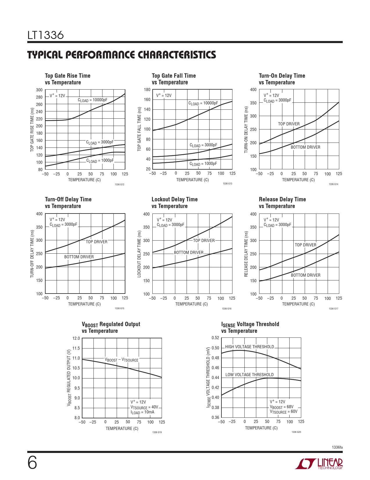

Typical perForMance characTerisTics. Top Gate Rise Time. Top Gate Fall Time. Turn-On Delay Time. vs Temperature
LT1336
Typical perForMance characTerisTics Top Gate Rise Time Top Gate Fall Time Turn-On Delay Time vs Temperature vs Temperature vs Temperature
300 180 400 280 V+ = 12V V+ = 12V V+ = 12V CLOAD = 10000pF 160 CLOAD = 3000pF 260 CLOAD = 10000pF 350 240 140 300 220 120 200 TOP DRIVER 100 250 180 160 80 CLOAD = 3000pF C 200 LOAD = 3000pF BOTTOM DRIVER TOP GATE RISE TIME (ns) 140 TOP GATE FALL TIME (ns) 60 TURN-ON DELAY TIME (ns) 120 150 40 100 CLOAD = 1000pF CLOAD = 1000pF 80 20 100 –50 –25 0 25 50 75 100 125 –50 –25 0 25 50 75 100 125 –50 –25 0 25 50 75 100 125 TEMPERATURE (C) TEMPERATURE (C) TEMPERATURE (C) 1336 G12 1336 G13 1336 G14
Turn-Off Delay Time Lockout Delay Time Release Delay Time vs Temperature vs Temperature vs Temperature
400 400 400 V+ = 12V V+ = 12V V+ = 12V C 350 LOAD = 3000pF C C 350 LOAD = 3000pF 350 LOAD = 3000pF 300 TOP DRIVER 300 TOP DRIVER 300 TOP DRIVER 250 250 BOTTOM DRIVER 250 BOTTOM DRIVER 200 200 200 TURN-OFF DELAY TIME (ns) LOCKOUT DELAY TIME (ns) RELEASE DELAY TIME (ns) BOTTOM DRIVER 150 150 150 100 100 100 –50 –25 0 25 50 75 100 125 –50 –25 0 25 50 75 100 125 –50 –25 0 25 50 75 100 125 TEMPERATURE (C) TEMPERATURE (C) TEMPERATURE (C) 1336 G15 1336 G16 1336 G17
VBOOST Regulated Output ISENSE Voltage Threshold vs Temperature vs Temperature
12.0 0.52 11.5 0.50 HIGH VOLTAGE THRESHOLD 11.0 V 0.48 BOOST – VTSOURCE 10.5 0.46 LOW VOLTAGE THRESHOLD 10.0 0.44 9.5 0.42 REGULATED OUTPUT (V) VOLTAGE THRESHOLD (mV) 9.0 0.40 V+ = 12V V BOOST V+ = 12V 8.5 VTSOURCE = 40V I SENSE 0.38 VBOOST = 68V ILOAD = 10mA VTSOURCE = 60V 8.0 0.36 –50 –25 0 25 50 75 100 125 –50 –25 0 25 50 75 100 125 TEMPERATURE (C) TEMPERATURE (C) 1336 G19 1336 G20 1336fa 6 Document Outline Features Applications Description Typical Application Absolute Maximum Ratings Pin Configuration Order Information Electrical Characteristics Typical Performance Characteristics Pin Functions Functional Diagram Test Circuit Timing Diagram Operation Applications Information Typical Applications Package Description Revision History Typical Application Related Parts
