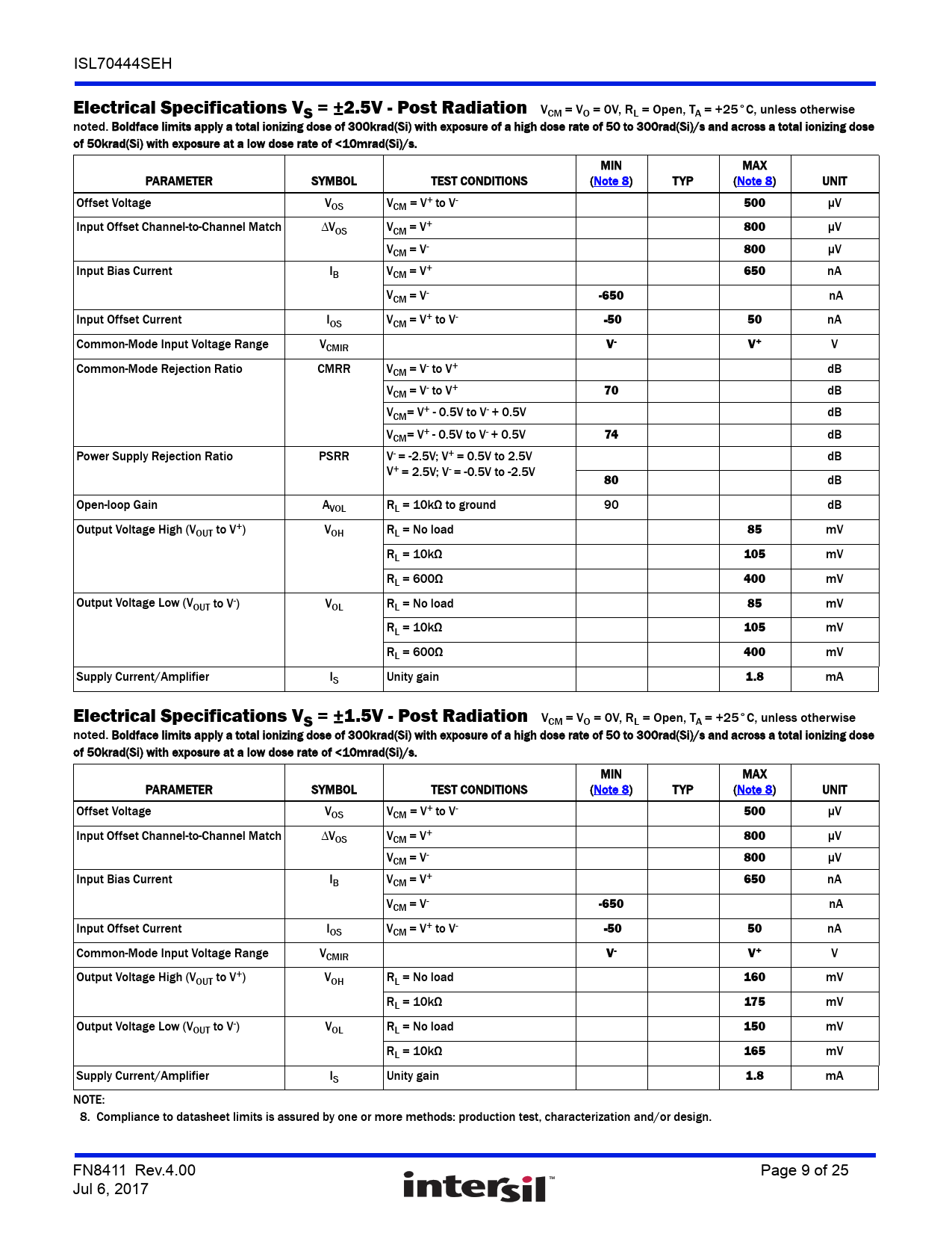

Description19MHz Radiation Hardened 40V Quad Rail-to-Rail Input - Output, Low-Power Operational Amplifiers
Pages / Page25 / 9 — link. to. page. 9. link. to. page. 9. link. to. page. 9. link. to. page. …
Revision2017-12-21
link. to. page. 9. link. to. page. 9. link. to. page. 9. link. to. page. 9. ISL70444SEH. Electrical. Specifications. VS. =. ±2.5V. -. Post. Radiation. VCM. =. VO. =. 0V,. RL. =. Open,
link to page 9 link to page 9 link to page 9 link to page 9 ISL70444SEH Electrical Specifications VS = ±2.5V - Post Radiation VCM = VO = 0V, RL = Open,
link to page 9 link to page 9 link to page 9 link to page 9 ISL70444SEH Electrical Specifications VS = ±2.5V - Post Radiation VCM = VO = 0V, RL = Open, TA = +25°C, unless otherwise noted. Boldface limits apply a total ionizing dose of 300krad(Si) with exposure of a high dose rate of 50 to 300rad(Si)/s and across a total ionizing dose of 50krad(Si) with exposure at a low dose rate of <10mrad(Si)/s. MIN MAX PARAMETER SYMBOL TEST CONDITIONS (Note 8) TYP (Note 8) UNIT Offset Voltage VOS VCM = V+ to V- 500 µV Input Offset Channel-to-Channel Match VOS VCM = V+ 800 µV VCM = V- 800 µV Input Bias Current IB VCM = V+ 650 nA VCM = V- -650 nA Input Offset Current IOS VCM = V+ to V- -50 50 nA Common-Mode Input Voltage Range VCMIR V- V+ V Common-Mode Rejection Ratio CMRR VCM = V- to V+ dB VCM = V- to V+ 70 dB VCM= V+ - 0.5V to V- + 0.5V dB VCM= V+ - 0.5V to V- + 0.5V 74 dB Power Supply Rejection Ratio PSRR V- = -2.5V; V+ = 0.5V to 2.5V dB V+ = 2.5V; V- = -0.5V to -2.5V 80 dB Open-loop Gain AVOL RL = 10kΩ to ground 90 dB Output Voltage High (VOUT to V+) VOH RL = No load 85 mV RL = 10kΩ 105 mV RL = 600Ω 400 mV Output Voltage Low (VOUT to V-) VOL RL = No load 85 mV RL = 10kΩ 105 mV RL = 600Ω 400 mV Supply Current/Amplifier IS Unity gain 1.8 mA Electrical Specifications VS = ±1.5V - Post Radiation VCM = VO = 0V, RL = Open, TA = +25°C, unless otherwise noted. Boldface limits apply a total ionizing dose of 300krad(Si) with exposure of a high dose rate of 50 to 300rad(Si)/s and across a total ionizing dose of 50krad(Si) with exposure at a low dose rate of <10mrad(Si)/s. MIN MAX PARAMETER SYMBOL TEST CONDITIONS (Note 8) TYP (Note 8) UNIT Offset Voltage VOS VCM = V+ to V- 500 µV Input Offset Channel-to-Channel Match VOS VCM = V+ 800 µV VCM = V- 800 µV Input Bias Current IB VCM = V+ 650 nA VCM = V- -650 nA Input Offset Current IOS VCM = V+ to V- -50 50 nA Common-Mode Input Voltage Range VCMIR V- V+ V Output Voltage High (VOUT to V+) VOH RL = No load 160 mV RL = 10kΩ 175 mV Output Voltage Low (VOUT to V-) VOL RL = No load 150 mV RL = 10kΩ 165 mV Supply Current/Amplifier IS Unity gain 1.8 mA NOTE: 8. Compliance to datasheet limits is assured by one or more methods: production test, characterization and/or design. FN8411 Rev.4.00 Page 9 of 25 Jul 6, 2017 Document Outline Related Literature Features Applications Table of Contents Pin Configuration Pin Descriptions Ordering Information Absolute Maximum Ratings Thermal Information Recommended Operating Conditions Electrical Specifications VS = ±18V Electrical Specifications VS = ±2.5V Electrical Specifications VS = ±1.5V Electrical Specifications VS = ±18V - Post Radiation Electrical Specifications VS = ±2.5V - Post Radiation Electrical Specifications VS = ±1.5V - Post Radiation Typical Performance Curves Post High Dose Rate Radiation Characteristics Post Low Dose Rate Radiation Characteristics Applications Information Functional Description Operating Voltage Range Input Performance Input ESD Diode Protection Output Short-Circuit Current Limiting Output Phase Reversal Power Dissipation Unused Channel Configuration Die Characteristics Die Dimensions Interface Materials Glassivation Top Metallization Backside Finish Process Assembly Related Information Substrate Potential Additional Information Worst Case Current Density Transistor Count Weight of Packaged Device Lid Characteristics Metallization Mask Layout Revision History About Intersil Package Outline Drawing
