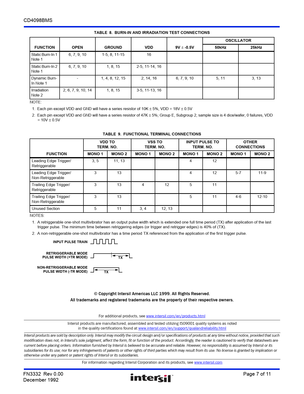

TABLE 8. BURN-IN AND IRRADIATION TEST CONNECTIONS. OSCILLATOR. FUNCTION. OPEN. GROUND. VDD. -0.5V. 50kHz. 25kHz
CD4098BMS
TABLE 8. BURN-IN AND IRRADIATION TEST CONNECTIONS OSCILLATOR FUNCTION OPEN GROUND VDD 9V
-0.5V 50kHz 25kHz
Static Burn-In 1 6, 7, 9, 10 1-5, 8, 11-15 16 Note 1 Static Burn-In 2 6, 7, 9, 10 1, 8, 15 2-5, 11-14, 16 Note 1 Dynamic Burn- - 1, 4, 8, 12, 15 2, 14, 16 6, 7, 9, 10 5, 11 3, 13 In Note 1 Irradiation 2, 6, 7, 9, 10, 14 1, 8, 15 3-5, 11-13, 16 Note 2 NOTE: 1. Each pin except VDD and GND will have a series resistor of 10K 5%, VDD = 18V 0.5V 2. Each pin except VDD and GND will have a series resistor of 47K 5%; Group E, Subgroup 2, sample size is 4 dice/wafer, 0 failures, VDD = 10V 0.5V
TABLE 9. FUNCTIONAL TERMINAL CONNECTIONS VDD TO VSS TO INPUT PULSE TO OTHER TERM. NO. TERM. NO. TERM. NO. CONNECTIONS FUNCTION MONO 1 MONO 2 MONO 1 MONO 2 MONO 1 MONO 2 MONO 1 MONO 2
Leading Edge Trigger/ 3, 5 11, 13 4 12 Retriggerable Leading Edge Trigger/ 3 13 4 12 5-7 11-9 Non-Retriggerable Trailing Edge Trigger/ 3 13 4 12 5 11 Retriggerable Trailing Edge Trigger/ 3 13 5 11 4-6 12-10 Non-Retriggerable Unused Section 5 11 3, 4 12, 13 NOTES: 1. A retriggerable one-shot multivibrator has an output pulse width which is extended one full time period (TX) after application of the last trigger pulse. The minimum time between retriggering edges (or trigger and retrigger edges) is 40% of (TX). 2. A non-retriggerable one-shot multivibrator has a time period TX referenced from the application of the first trigger pulse.
INPUT PULSE TRAIN RETRIGGERABLE MODE PULSE WIDTH (+TR MODE) TX NON-RETRIGGERABLE MODE PULSE WIDTH (-TR MODE) TX
