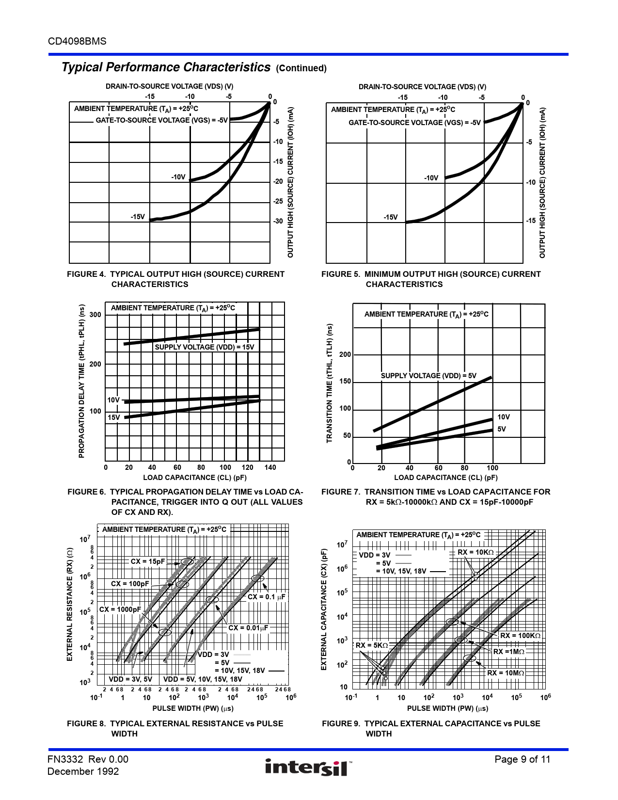

Typical Performance Characteristics. (Continued). DRAIN-TO-SOURCE VOLTAGE (VDS) (V). -15. -10. AMBIENT TEMPERATURE (T. A) = +25oC
CD4098BMS
Typical Performance Characteristics (Continued) DRAIN-TO-SOURCE VOLTAGE (VDS) (V) DRAIN-TO-SOURCE VOLTAGE (VDS) (V) -15 -10 -5 0 -15 -10 -5 0 0 0 AMBIENT TEMPERATURE (T ) A) = +25oC A) AMBIENT TEMPERATURE (TA) = +25oC A GATE-TO-SOURCE VOLTAGE (VGS) = -5V -5 (m m GATE-TO-SOURCE VOLTAGE (VGS) = -5V ) ( IOH) -10 (IOH T ( -5 T N EN E -15 RR URR C -10V ) CU ) -20 -10V -10 RCE U URCE -25 O (S -15V -15V -30 -15 HIGH UT TP OU OUTPUT HIGH (SO FIGURE 4. TYPICAL OUTPUT HIGH (SOURCE) CURRENT FIGURE 5. MINIMUM OUTPUT HIGH (SOURCE) CURRENT CHARACTERISTICS CHARACTERISTICS s) AMBIENT TEMPERATURE (TA) = +25oC (n 300 AMBIENT TEMPERATURE (TA) = +25oC LH) tP SUPPLY VOLTAGE (VDD) = 15V HL, LH) (ns) T tP 200 ( E 200 HL, t T TIM SUPPLY VOLTAGE (VDD) = 5V (t Y 150 LA 10V N DE 100 100 IO 10V T 15V A G 5V A 50 TRANSITION TIME OP R P 0 0 20 40 60 80 100 120 140 0 20 40 60 80 100 LOAD CAPACITANCE (CL) (pF) LOAD CAPACITANCE (CL) (pF) FIGURE 6. TYPICAL PROPAGATION DELAY TIME vs LOAD CA- FIGURE 7. TRANSITION TIME vs LOAD CAPACITANCE FOR PACITANCE, TRIGGER INTO Q OUT (ALL VALUES RX = 5k -10000k AND CX = 15pF-10000pF OF CX AND RX). AMBIENT TEMPERATURE (TA) = +25oC AMBIENT TEMPERATURE (T 107 A) = +25oC ) 8 ) 107 6 RX = 10K 4 VDD = 3V ) ( CX = 15pF ) (pF = 5V 2 X 106 = 10V, 15V, 18V 106 (C 8 CX = 100pF E 6 ANCE (RX 4 CX = 0.1
F 105 ANC 2 IST S CX = 1000pF E 105 ACIT 8 104 6 4 CX = 0.01
F 2 RX = 100K 103 104 RX = 5K 8 VDD = 3V RX =1M 6 EXTERNAL R TERNAL CAP 4 = 5V X 102 E 2 = 10V, 15V, 18V RX = 10M 103 VDD = 3V, 5V VDD = 5V, 10V, 15V, 18V 2 4 6 8 2 4 6 8 2 4 6 8 2 4 6 8 2 4 6 8 2 4 6 8 2 4 6 8 10 10-1 1 10 102 103 104 105 106 10-1 1 102 103 104 105 10 106 PULSE WIDTH (PW) (
s) PULSE WIDTH (PW) (
s) FIGURE 8. TYPICAL EXTERNAL RESISTANCE vs PULSE FIGURE 9. TYPICAL EXTERNAL CAPACITANCE vs PULSE WIDTH WIDTH
