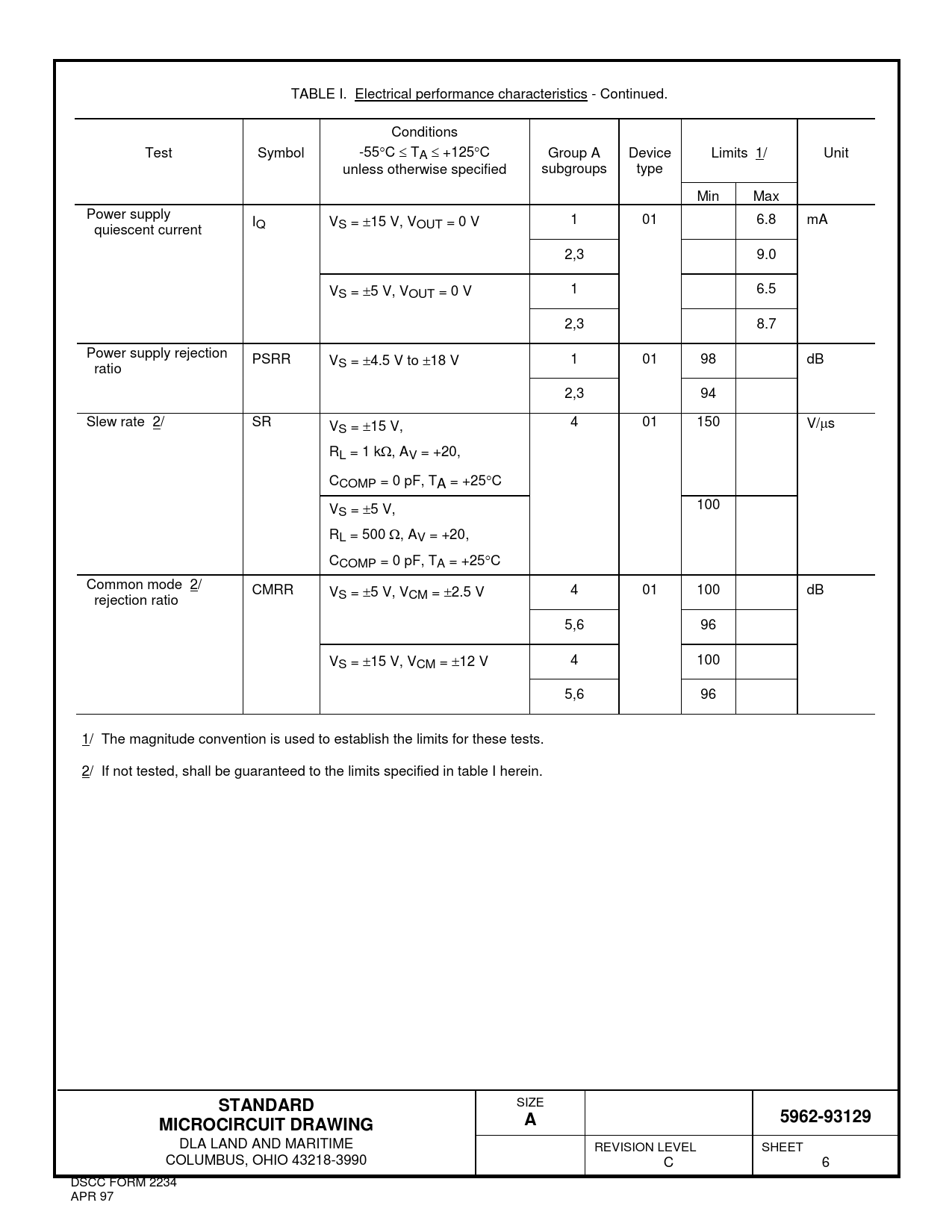

STANDARD 5962-93129 MICROCIRCUIT DRAWING
TABLE I. Electrical performance characteristics - Continued. Conditions Test Symbol -55°C ≤ TA ≤ +125°C Group A Device Limits 1/ Unit unless otherwise specified subgroups type Min Max Power supply I quiescent current Q VS = ±15 V, VOUT = 0 V 1 01 6.8 mA 2,3 9.0 VS = ±5 V, VOUT = 0 V 1 6.5 2,3 8.7 Power supply rejection PSRR V ratio S = ±4.5 V to ±18 V 1 01 98 dB 2,3 94 Slew rate 2/ SR V 4 01 150 V/µs S = ±15 V, RL = 1 kΩ, AV = +20, CCOMP = 0 pF, TA = +25°C V 100 S = ±5 V, RL = 500 Ω, AV = +20, CCOMP = 0 pF, TA = +25°C Common mode 2/ CMRR V rejection ratio S = ±5 V, VCM = ±2.5 V 4 01 100 dB 5,6 96 VS = ±15 V, VCM = ±12 V 4 100 5,6 96 1/ The magnitude convention is used to establish the limits for these tests. 2/ If not tested, shall be guaranteed to the limits specified in table I herein.
