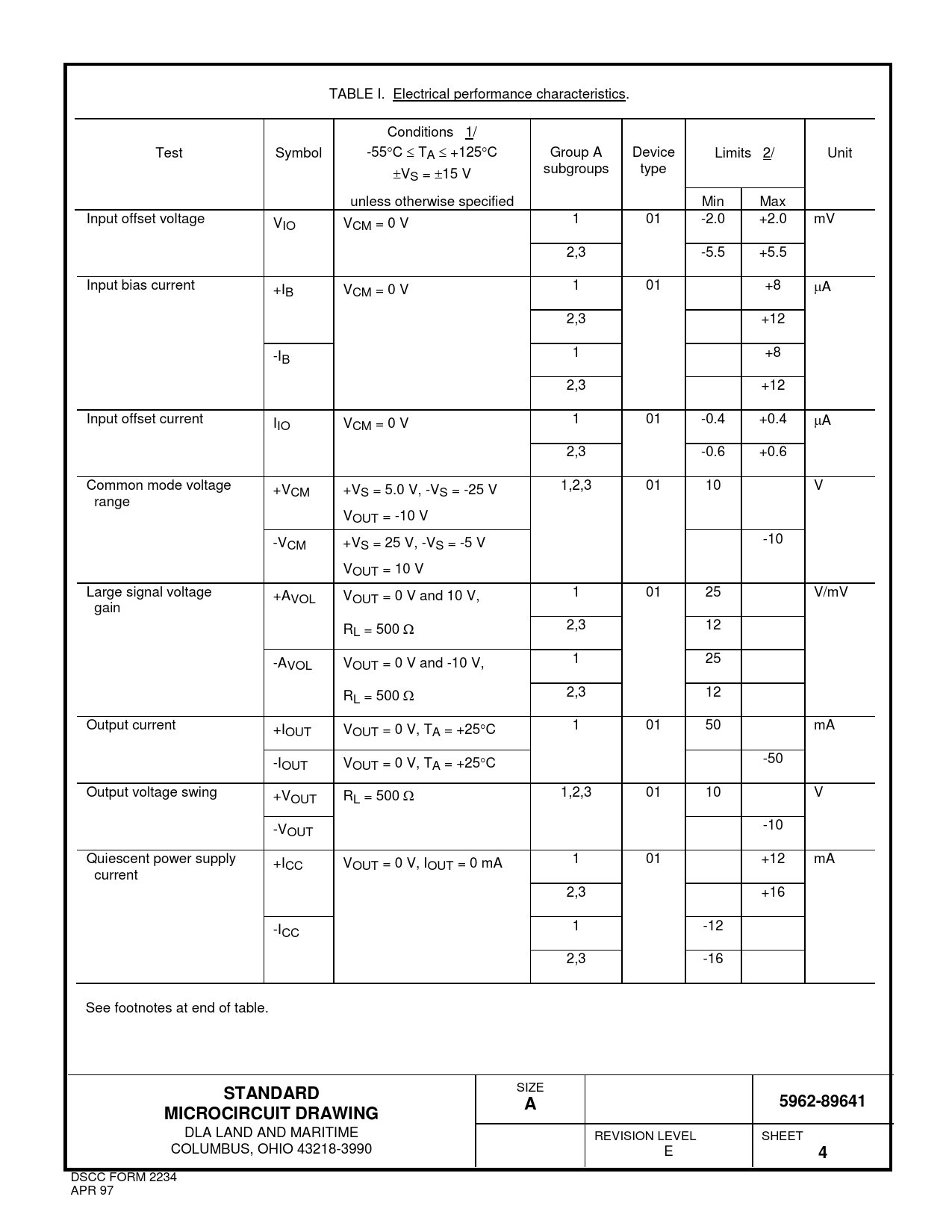

STANDARD. 5962-89641. MICROCIRCUIT DRAWING
STANDARD 5962-89641 MICROCIRCUIT DRAWING
TABLE I. Electrical performance characteristics. Conditions 1/ Test Symbol -55°C ≤ TA ≤ +125°C Group A Device Limits 2/ Unit ±V subgroups type S = ±15 V unless otherwise specified Min Max Input offset voltage VIO VCM = 0 V 1 01 -2.0 +2.0 mV 2,3 -5.5 +5.5 Input bias current +IB VCM = 0 V 1 01 +8 µA 2,3 +12 -IB 1 +8 2,3 +12 Input offset current IIO VCM = 0 V 1 01 -0.4 +0.4 µA 2,3 -0.6 +0.6 Common mode voltage +V 1,2,3 01 10 V CM +VS = 5.0 V, -VS = -25 V range VOUT = -10 V -V -10 CM +VS = 25 V, -VS = -5 V VOUT = 10 V Large signal voltage +AVOL VOUT = 0 V and 10 V, 1 01 25 V/mV gain RL = 500 Ω 2,3 12 -AVOL VOUT = 0 V and -10 V, 1 25 RL = 500 Ω 2,3 12 Output current +IOUT VOUT = 0 V, TA = +25°C 1 01 50 mA -IOUT VOUT = 0 V, TA = +25°C -50 Output voltage swing +VOUT RL = 500 Ω 1,2,3 01 10 V -VOUT -10 Quiescent power supply +ICC VOUT = 0 V, IOUT = 0 mA 1 01 +12 mA current 2,3 +16 -ICC 1 -12 2,3 -16 See footnotes at end of table.
