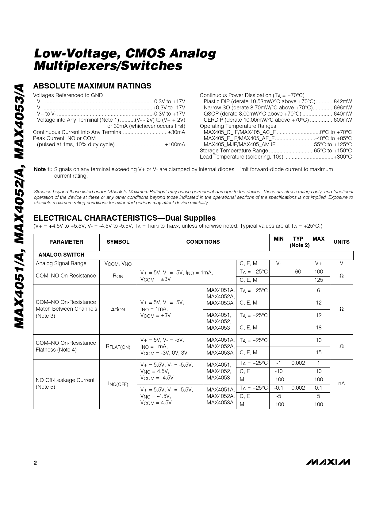

Low-Voltage, CMOS Analog Multiplexers/Switches. ABSOLUTE MAXIMUM RATINGS. Note 1:. ELECTRICAL CHARACTERISTICS—Dual Supplies
Low-Voltage, CMOS Analog Multiplexers/Switches ABSOLUTE MAXIMUM RATINGS Note 1: ELECTRICAL CHARACTERISTICS—Dual Supplies
Voltages Referenced to GND Continuous Power Dissipation (TA = +70°C) V+ ..-0.3V to +17V Plastic DIP (derate 10.53mW/°C above +70°C) ..842mW V-..+0.3V to -17V Narrow SO (derate 8.70mW/°C above +70°C)..696mW V+ to V- ..-0.3V to +17V QSOP (derate 8.00mW/°C above +70°C) ...640mW Voltage into Any Terminal (Note 1) ..(V- - 2V) to (V+ + 2V) CERDIP (derate 10.00mW/°C above +70°C) ..800mW or 30mA (whichever occurs first) Operating Temperature Ranges Continuous Current into Any Terminal..±30mA MAX405_C_ E/MAX405_AC_E ...0°C to +70°C Peak Current, NO or COM MAX405_E_ E/MAX405_AE_E...-40°C to +85°C (pulsed at 1ms, 10% duty cycle) ...±100mA MAX405_MJE/MAX405_AMJE ..-55°C to +125°C Storage Temperature Range ...-65°C to +150°C Lead Temperature (soldering, 10s) ...+300°C
Note 1:
Signals on any terminal exceeding V+ or V- are clamped by internal diodes. Limit forward-diode current to maximum current rating. Stresses beyond those listed under “Absolute Maximum Ratings” may cause permanent damage to the device. These are stress ratings only, and functional operation of the device at these or any other conditions beyond those indicated in the operational sections of the specifications is not implied. Exposure to absolute maximum rating conditions for extended periods may affect device reliability.
(V+ = +4.5V to +5.5V, V- = -4.5V to -5.5V, TA = TMIN to TMAX, unless otherwise noted. Typical values are at TA = +25°C.)
MIN TYP MAX PARAMETER SYMBOL CONDITIONS UNITS (Note 2) ANALOG SWITCH
Analog Signal Range VCOM, VNO C, E, M V- V+ V V+ = 5V, V- = -5V, I TA = +25°C 60 100 COM–NO On-Resistance R NO = 1mA, ON Ω VCOM = ±3V C, E, M 125 MAX4051A, TA = +25°C 6 MAX4052A, COM–NO On-Resistance V+ = 5V, V- = -5V, MAX4053A C, E, M 12 Match Between Channels ∆RON INO = 1mA, Ω (Note 3) VCOM = ±3V MAX4051, TA = +25°C 12
MAX4051/A, MAX4052/A, MAX4053/A
MAX4052, MAX4053 C, E, M 18 V+ = 5V, V- = -5V, MAX4051A, TA = +25°C 10 COM–NO On-Resistance RFLAT(ON) INO = 1mA, MAX4052A, Ω Flatness (Note 4) VCOM = -3V, 0V, 3V MAX4053A C, E, M 15 V+ = 5.5V, V- = -5.5V, MAX4051, TA = +25°C -1 0.002 1 VNO = 4.5V, MAX4052, C, E -10 10 VCOM = -4.5V MAX4053 NO Off-Leakage Current M -100 100 INO(OFF) nA (Note 5) V+ = 5.5V, V- = -5.5V, MAX4051A, TA = +25°C -0.1 0.002 0.1 VNO = -4.5V, MAX4052A, C, E -5 5 VCOM = 4.5V MAX4053A M -100 100
