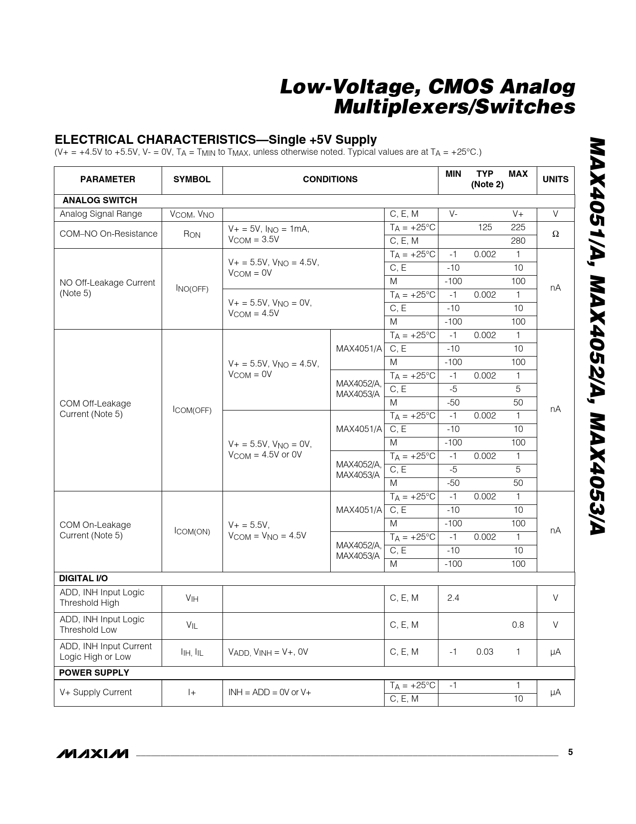

Low-Voltage, CMOS Analog. Multiplexers/Switches. MAX4051/A, MAX4052/A, MAX4053/A
Low-Voltage, CMOS Analog Multiplexers/Switches MAX4051/A, MAX4052/A, MAX4053/A
Low-Voltage, CMOS Analog Multiplexers/Switches MAX4051/A, MAX4052/A, MAX4053/A ELECTRICAL CHARACTERISTICS—Single +5V Supply
(V+ = +4.5V to +5.5V, V- = 0V, TA = TMIN to TMAX, unless otherwise noted. Typical values are at TA = +25°C.)
MIN TYP MAX PARAMETER SYMBOL CONDITIONS UNITS (Note 2) ANALOG SWITCH
Analog Signal Range VCOM, VNO C, E, M V- V+ V V+ = 5V, I TA = +25°C 125 225 COM–NO On-Resistance R NO = 1mA, ON Ω VCOM = 3.5V C, E, M 280 TA = +25°C -1 0.002 1 V+ = 5.5V, VNO = 4.5V, C, E -10 10 VCOM = 0V NO Off-Leakage Current M -100 100 INO(OFF) nA (Note 5) TA = +25°C -1 0.002 1 V+ = 5.5V, VNO = 0V, C, E -10 10 VCOM = 4.5V M -100 100 TA = +25°C -1 0.002 1 MAX4051/A C, E -10 10 V+ = 5.5V, VNO = 4.5V, M -100 100 VCOM = 0V TA = +25°C -1 0.002 1 MAX4052/A, C, E -5 5 MAX4053/A COM Off-Leakage M -50 50 ICOM(OFF) nA Current (Note 5) TA = +25°C -1 0.002 1 MAX4051/A C, E -10 10 V+ = 5.5V, VNO = 0V, M -100 100 VCOM = 4.5V or 0V TA = +25°C -1 0.002 1 MAX4052/A, C, E -5 5 MAX4053/A M -50 50 TA = +25°C -1 0.002 1 MAX4051/A C, E -10 10 COM On-Leakage V+ = 5.5V, M -100 100 ICOM(ON) nA Current (Note 5) VCOM = VNO = 4.5V TA = +25°C -1 0.002 1 MAX4052/A, C, E -10 10 MAX4053/A M -100 100
DIGITAL I/O
ADD, INH Input Logic VIH C, E, M 2.4 V Threshold High ADD, INH Input Logic VIL C, E, M 0.8 V Threshold Low ADD, INH Input Current IIH, IIL VADD, VINH = V+, 0V C, E, M -1 0.03 1 µA Logic High or Low
POWER SUPPLY
TA = +25°C -1 1 V+ Supply Current I+ INH = ADD = 0V or V+ µA C, E, M 10
