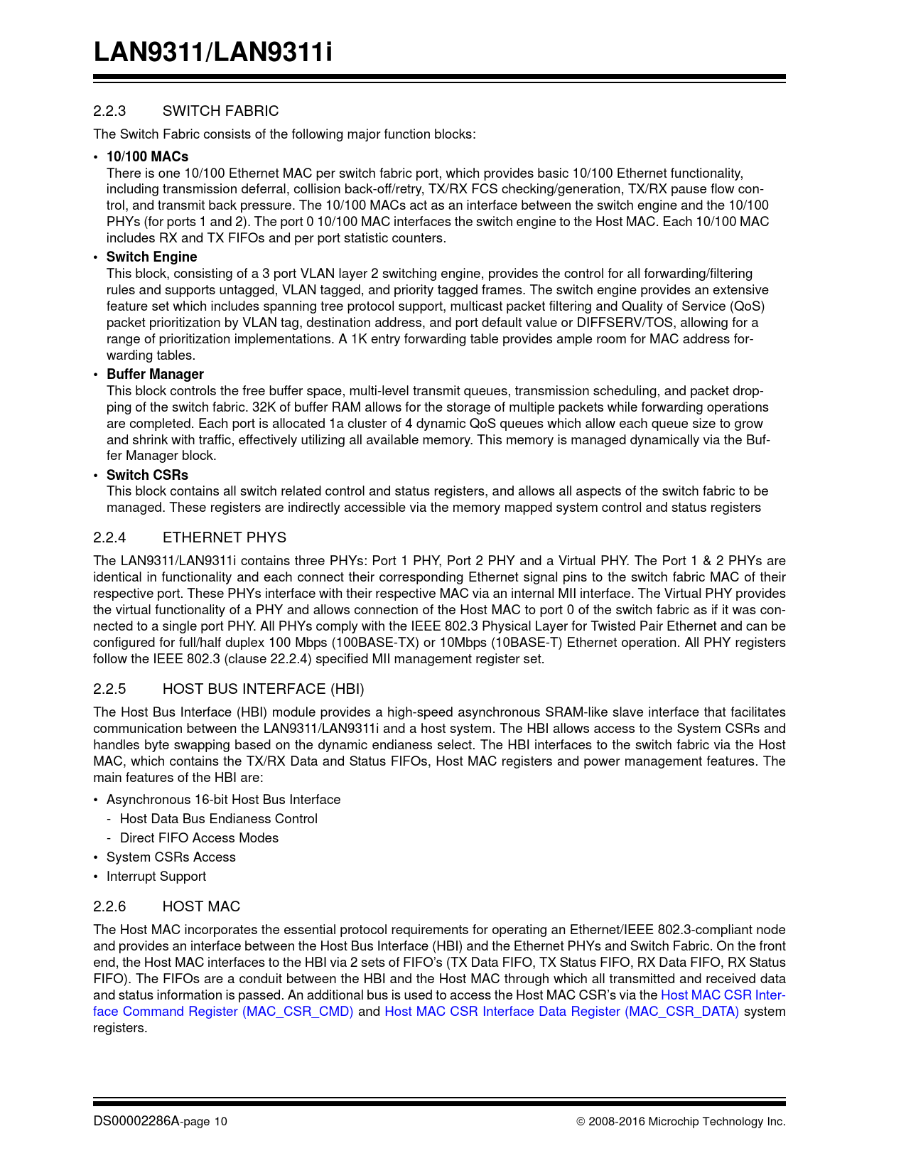

2.2.3 SWITCH FABRIC The Switch Fabric consists of the following major function blocks: •
10/100 MACs
There is one 10/100 Ethernet MAC per switch fabric port, which provides basic 10/100 Ethernet functionality, including transmission deferral, collision back-off/retry, TX/RX FCS checking/generation, TX/RX pause flow con- trol, and transmit back pressure. The 10/100 MACs act as an interface between the switch engine and the 10/100 PHYs (for ports 1 and 2). The port 0 10/100 MAC interfaces the switch engine to the Host MAC. Each 10/100 MAC includes RX and TX FIFOs and per port statistic counters. •
Switch Engine
This block, consisting of a 3 port VLAN layer 2 switching engine, provides the control for all forwarding/filtering rules and supports untagged, VLAN tagged, and priority tagged frames. The switch engine provides an extensive feature set which includes spanning tree protocol support, multicast packet filtering and Quality of Service (QoS) packet prioritization by VLAN tag, destination address, and port default value or DIFFSERV/TOS, allowing for a range of prioritization implementations. A 1K entry forwarding table provides ample room for MAC address for- warding tables. •
Buffer Manager
This block controls the free buffer space, multi-level transmit queues, transmission scheduling, and packet drop- ping of the switch fabric. 32K of buffer RAM allows for the storage of multiple packets while forwarding operations are completed. Each port is allocated 1a cluster of 4 dynamic QoS queues which allow each queue size to grow and shrink with traffic, effectively utilizing all available memory. This memory is managed dynamically via the Buf- fer Manager block. •
Switch CSRs
This block contains all switch related control and status registers, and allows all aspects of the switch fabric to be managed. These registers are indirectly accessible via the memory mapped system control and status registers 2.2.4 ETHERNET PHYS The LAN9311/LAN9311i contains three PHYs: Port 1 PHY, Port 2 PHY and a Virtual PHY. The Port 1 & 2 PHYs are identical in functionality and each connect their corresponding Ethernet signal pins to the switch fabric MAC of their respective port. These PHYs interface with their respective MAC via an internal MII interface. The Virtual PHY provides the virtual functionality of a PHY and allows connection of the Host MAC to port 0 of the switch fabric as if it was con- nected to a single port PHY. All PHYs comply with the IEEE 802.3 Physical Layer for Twisted Pair Ethernet and can be configured for full/half duplex 100 Mbps (100BASE-TX) or 10Mbps (10BASE-T) Ethernet operation. All PHY registers follow the IEEE 802.3 (clause 22.2.4) specified MII management register set. 2.2.5 HOST BUS INTERFACE (HBI) The Host Bus Interface (HBI) module provides a high-speed asynchronous SRAM-like slave interface that facilitates communication between the LAN9311/LAN9311i and a host system. The HBI allows access to the System CSRs and handles byte swapping based on the dynamic endianess select. The HBI interfaces to the switch fabric via the Host MAC, which contains the TX/RX Data and Status FIFOs, Host MAC registers and power management features. The main features of the HBI are: • Asynchronous 16-bit Host Bus Interface - Host Data Bus Endianess Control - Direct FIFO Access Modes • System CSRs Access • Interrupt Support 2.2.6 HOST MAC The Host MAC incorporates the essential protocol requirements for operating an Ethernet/IEEE 802.3-compliant node and provides an interface between the Host Bus Interface (HBI) and the Ethernet PHYs and Switch Fabric. On the front end, the Host MAC interfaces to the HBI via 2 sets of FIFO’s (TX Data FIFO, TX Status FIFO, RX Data FIFO, RX Status FIFO). The FIFOs are a conduit between the HBI and the Host MAC through which all transmitted and received data and status information is passed. An additional bus is used to access the Host MAC CSR’s via the Host MAC CSR Inter- face Command Register (MAC_CSR_CMD) and Host MAC CSR Interface Data Register (MAC_CSR_DATA) system registers. DS00002286A-page 10  2008-2016 Microchip Technology Inc. Document Outline 1.0 Preface 1.1 General Terms 1.2 Buffer Types TABLE 1-1: Buffer Types 1.3 Register Nomenclature TABLE 1-2: Register Bit Types 2.0 Introduction 2.1 General Description 2.2 Block Diagram FIGURE 2-1: Internal LAN9311/LAN9311i Block Diagram 2.2.1 System Clocks/Reset/PME Controller 2.2.2 System Interrupt Controller 2.2.3 Switch Fabric 2.2.4 Ethernet PHYs 2.2.5 Host Bus Interface (HBI) 2.2.6 Host MAC 2.2.7 EEPROM Controller/Loader 2.2.8 1588 Time Stamp 2.2.9 GPIO/LED Controller 2.3 System Configuration FIGURE 2-2: System Block Diagram 3.0 Pin Description and Configuration 3.1 Pin Diagrams 3.1.1 128-VTQFP Pin Diagram FIGURE 3-1: LAN9311 128-VTQFP Pin Assignments (TOP VIEW) 3.1.2 128-XVTQFP Pin Diagram FIGURE 3-2: LAN9311/LAN9311i 128-XVTQFP Pin Assignments (TOP VIEW) 3.2 Pin Descriptions TABLE 3-1: LAN Port 1 Pins TABLE 3-2: LAN Port 2 Pins TABLE 3-3: LAN Port 1 & 2 Power and Common Pins TABLE 3-4: Host Bus Interface Pins TABLE 3-5: EEPROM Pins TABLE 3-6: Dedicated Configuration Strap Pins TABLE 3-7: Miscellaneous Pins TABLE 3-8: PLL Pins TABLE 3-9: Core and I/O Power and Ground Pins TABLE 3-10: No-Connect Pins 4.0 Clocking, Resets, and Power Management 4.1 Clocks 4.2 Resets TABLE 4-1: Reset Sources and Affected LAN9311/LAN9311i Circuitry 4.2.1 Chip-Level Resets 4.2.2 Multi-Module Resets 4.2.3 Single-Module Resets 4.2.4 Configuration Straps TABLE 4-2: Soft-Strap Configuration Strap Definitions TABLE 4-3: Hard-Strap Configuration Strap Definitions 4.3 Power Management FIGURE 4-1: PME and PME_INT Signal Generation 4.3.1 Port 1 & 2 PHY Power Management 4.3.2 Host MAC Power Management 5.0 System Interrupts 5.1 Functional Overview 5.2 Interrupt Sources FIGURE 5-1: Functional Interrupt Register Hierarchy 5.2.1 1588 Time Stamp Interrupts 5.2.2 Switch Fabric Interrupts 5.2.3 Ethernet PHY Interrupts 5.2.4 GPIO Interrupts 5.2.5 Host MAC Interrupts 5.2.6 Power Management Interrupts 5.2.7 General Purpose Timer Interrupt 5.2.8 Software Interrupt 5.2.9 Device Ready Interrupt 6.0 Switch Fabric 6.1 Functional Overview 6.2 Switch Fabric CSRs 6.2.1 Switch Fabric CSR Writes FIGURE 6-1: Switch Fabric CSR Write Access Flow Diagram 6.2.2 Switch Fabric CSR Reads FIGURE 6-2: Switch Fabric CSR Read Access Flow Diagram 6.2.3 Flow Control Enable Logic TABLE 6-1: Switch Fabric Flow Control Enable Logic 6.3 10/100 Ethernet MACs 6.3.1 Receive MAC 6.3.2 Transmit MAC 6.4 Switch Engine (SWE) 6.4.1 MAC Address Lookup Table FIGURE 6-3: ALR Table Entry Structure 6.4.2 Forwarding Rules 6.4.3 Transmit Priority Queue Selection FIGURE 6-4: Switch Engine Transmit Queue Selection FIGURE 6-5: Switch Engine Transmit Queue Calculation 6.4.4 VLAN Support TABLE 6-2: VLAN Table Entry Structure 6.4.5 Spanning Tree Support TABLE 6-3: Spanning Tree States 6.4.6 Ingress Flow Metering and Coloring TABLE 6-4: Typical Ingress Rate Settings FIGURE 6-6: Switch Engine Ingress Flow Priority Selection FIGURE 6-7: Switch Engine Ingress Flow Priority Calculation 6.4.7 Broadcast Storm Control TABLE 6-5: Typical Broadcast Rate Settings 6.4.8 IPv4 IGMP Support 6.4.9 Port Mirroring 6.4.10 Host CPU Port Special Tagging 6.4.11 Counters 6.5 Buffer Manager (BM) 6.5.1 Packet Buffer Allocation 6.5.2 Random Early Discard (RED) 6.5.3 Transmit Queues 6.5.4 Transmit Priority Queue Servicing 6.5.5 Egress Rate Limiting (Leaky Bucket) TABLE 6-6: Typical Egress Rate Settings 6.5.6 Adding, Removing, and Changing VLAN Tags FIGURE 6-8: Hybrid Port Tagging and Un-tagging 6.5.7 Counters 6.6 Switch Fabric Interrupts 7.0 Ethernet PHYs 7.1 Functional Overview 7.1.1 PHY Addressing TABLE 7-1: Default PHY Serial MII Addressing 7.2 Port 1 & 2 PHYs FIGURE 7-1: Port x PHY Block Diagram 7.2.1 100BASE-TX Transmit FIGURE 7-2: 100BASE-TX Transmit Data Path TABLE 7-2: 4B/5B Code Table 7.2.2 100BASE-TX Receive FIGURE 7-3: 100BASE-TX Receive Data Path 7.2.3 10BASE-T Transmit 7.2.4 10BASE-T Receive 7.2.5 PHY Auto-negotiation 7.2.6 HP Auto-MDIX FIGURE 7-4: Direct Cable Connection vs. Cross-Over Cable Connection 7.2.7 MII MAC Interface 7.2.8 PHY Management Control TABLE 7-3: PHY Interrupt Sources 7.2.9 PHY Power-Down Modes 7.2.10 PHY Resets 7.2.11 LEDs 7.2.12 Required Ethernet Magnetics 7.3 Virtual PHY 7.3.1 Virtual PHY Auto-Negotiation 7.3.2 Virtual PHY Resets 8.0 Host Bus Interface (HBI) 8.1 Functional Overview 8.2 Host Memory Mapping 8.3 Host Data Bus 8.3.1 16-Bit Bus Writes 8.3.2 16-Bit Bus Read 8.4 Host Endianess FIGURE 8-1: Little Endian Byte Ordering FIGURE 8-2: Big Endian Byte Ordering 8.5 Host Interface Timing 8.5.1 Special Situations 8.5.2 Special Restrictions on Back-to Back Write-Read Cycles TABLE 8-1: Read After Write Timing Rules 8.5.3 Special Restrictions on Back-to-Back Read Cycles TABLE 8-2: Read After Read Timing Rules 8.5.4 PIO Reads FIGURE 8-3: Functional Timing for PIO Read Operation 8.5.5 PIO Burst Reads FIGURE 8-4: Functional Timing for PIO Burst Read Operation 8.5.6 RX Data FIFO Direct PIO Reads FIGURE 8-5: Functional Timing for RX Data FIFO Direct PIO Read Operation 8.5.7 RX Data FIFO Direct PIO Burst Reads FIGURE 8-6: Functional Timing for RX Data FIFO Direct PIO Burst Read Operation 8.5.8 PIO Writes FIGURE 8-7: Functional Timing for PIO Write Operation 8.5.9 TX Data FIFO Direct PIO Writes FIGURE 8-8: Functional Timing for TX Data FIFO Direct PIO Write Operation 8.6 HBI Interrupts 9.0 Host MAC 9.1 Functional Overview 9.2 Flow Control 9.2.1 Full-Duplex Flow Control 9.2.2 Half-Duplex Flow Control (Backpressure) 9.3 Virtual Local Area Network (VLAN) Support FIGURE 9-1: VLAN Frame 9.4 Address Filtering TABLE 9-1: Address Filtering Modes 9.4.1 Perfect Filtering 9.4.2 Hash Only Filtering 9.4.3 Hash Perfect Filtering 9.4.4 Inverse Filtering 9.5 Wake-up Frame Detection TABLE 9-2: Wake-Up Frame Filter Register Structure TABLE 9-3: Filter i Byte Mask Bit Definitions TABLE 9-4: Filter i Command Bit Definitions TABLE 9-5: Filter i Offset Bit Definitions TABLE 9-6: Filter i CRC-16 Bit Definitions 9.5.1 Magic Packet Detection 9.6 Host MAC Address TABLE 9-7: EEPROM Byte Ordering and Register Correlation FIGURE 9-2: Example EEPROM MAC Address Setup 9.7 FIFOs 9.7.1 TX/RX FIFOs 9.7.2 MIL FIFOs 9.7.3 FIFO Memory Allocation Configuration TABLE 9-8: TX/RX FIFO Configurable Sizes TABLE 9-9: Valid TX/RX FIFO Allocations 9.8 TX Data Path Operation FIGURE 9-3: Simplified Host TX Flow Diagram 9.8.1 TX Buffer Format FIGURE 9-4: TX Buffer Format 9.8.2 TX Command Format TABLE 9-10: TX Command 'A' Format TABLE 9-11: TX Command 'B' Format 9.8.3 TX Data Format TABLE 9-12: TX DATA Start Offset 9.8.4 TX Status Format 9.8.5 Calculating Actual TX Data FIFO Usage 9.8.6 Transmit Examples FIGURE 9-5: TX Example 1 FIGURE 9-6: TX Example 2 9.8.7 Transmitter Errors 9.8.8 Stopping and Starting the Transmitter 9.9 RX Data Path Operation 9.9.1 RX Slave PIO Operation FIGURE 9-7: Host Receive Routine Using Interrupts FIGURE 9-8: Host Receive Routine Using Polling 9.9.2 RX Packet Format FIGURE 9-9: RX Packet Format 9.9.3 RX Status Format 9.9.4 Stopping and Starting the Receiver 9.9.5 Receiver Errors 10.0 Serial Management 10.1 Functional Overview 10.2 I2C/Microwire Master EEPROM Controller TABLE 10-1: I2C/Microwire Master Serial Management Pins Characteristics 10.2.1 EEPROM Controller Operation FIGURE 10-1: EEPROM Access Flow Diagram 10.2.2 I2C EEPROM TABLE 10-2: I2C EEPROM Size Ranges FIGURE 10-2: I2C Cycle FIGURE 10-3: I2C EEPROM Addressing FIGURE 10-4: I2C EEPROM Byte Read FIGURE 10-5: I2C EEPROM Sequential Byte Reads FIGURE 10-6: I2C EEPROM Byte Write 10.2.3 Microwire EEPROM TABLE 10-3: Microwire EEPROM Size Ranges TABLE 10-4: Microwire Command Set for 7 Address Bits TABLE 10-5: Microwire Command Set for 9 Address Bits TABLE 10-6: Microwire Command Set for 11 Address Bits FIGURE 10-7: EEPROM ERASE Cycle FIGURE 10-8: EEPROM ERAL Cycle FIGURE 10-9: EEPROM EWDS Cycle FIGURE 10-10: EEPROM EWEN Cycle FIGURE 10-11: EEPROM READ Cycle FIGURE 10-12: EEPROM WRITE Cycle FIGURE 10-13: EEPROM WRAL Cycle 10.2.4 EEPROM Loader TABLE 10-7: EEPROM Contents Format Overview FIGURE 10-14: EEPROM Loader Flow Diagram TABLE 10-8: EEPROM Configuration Bits 11.0 IEEE 1588 Hardware Time Stamp Unit 11.1 Functional Overview 11.1.1 IEEE 1588 11.1.2 Block Diagram FIGURE 11-1: IEEE 1588 Block Diagram 11.2 IEEE 1588 Time Stamp TABLE 11-1: IEEE 1588 Message Type Detection FIGURE 11-2: IEEE 1588 Message Time Stamp Point TABLE 11-2: Time Stamp Capture Delay 11.2.1 Capture Locking 11.2.2 PTP Message Detection TABLE 11-3: PTP Multicast Addresses 11.3 IEEE 1588 Clock TABLE 11-4: Typical IEEE 1588 Clock Addend Values 11.4 IEEE 1588 Clock/Events 11.5 IEEE 1588 GPIOs 11.6 IEEE 1588 Interrupts 12.0 General Purpose Timer & Free-Running Clock 12.1 General Purpose Timer 12.2 Free-Running Clock 13.0 GPIO/LED Controller 13.1 Functional Overview 13.2 GPIO Operation 13.2.1 GPIO IEEE 1588 Timestamping 13.2.2 GPIO Interrupts 13.3 LED Operation TABLE 13-1: LED Operation as a Function of LED_CFG[9:8] 14.0 Register Descriptions FIGURE 14-1: LAN9311/LAN9311i Base Register Memory Map 14.1 TX/RX FIFO Ports 14.1.1 TX/RX Data FIFO’s 14.1.2 TX/RX Status FIFO’s 14.1.3 Direct FIFO Access Mode 14.2 System Control and Status Registers TABLE 14-1: System Control and Status Registers 14.2.1 Interrupts 14.2.2 Host MAC & FIFO’s TABLE 14-2: Backpressure Duration Bit Mapping 14.2.3 GPIO/LED 14.2.4 EEPROM 14.2.5 IEEE 1588 14.2.6 Switch Fabric TABLE 14-3: Switch Fabric CSR to SWITCH_CSR_DIRECT_DATA Address Range Map 14.2.7 PHY Management Interface (PMI) 14.2.8 Virtual PHY TABLE 14-4: Virtual PHY MII Serially Adressable Register Index TABLE 14-5: Emulated Link Partner Pause Flow Control Ability Default Values 14.2.9 Miscellaneous 14.3 Host MAC Control and Status Registers TABLE 14-6: Host MAC Adressable Registers 14.3.1 Host MAC Control Register (HMAC_CR) 14.3.2 Host MAC Address High Register (HMAC_ADDRH) 14.3.3 Host MAC Address Low Register (HMAC_ADDRL) 14.3.4 Host MAC Multicast Hash Table High Register (HMAC_HASHH) 14.3.5 Host MAC Multicast Hash Table Low Register (HMAC_HASHL) 14.3.6 Host MAC MII Access Register (HMAC_MII_ACC) 14.3.7 Host MAC MII Data Register (HMAC_MII_DATA) 14.3.8 Host MAC Flow Control Register (HMAC_FLOW) 14.3.9 Host MAC VLAN1 Tag Register (HMAC_VLAN1) 14.3.10 Host MAC VLAN2 Tag Register (HMAC_VLAN2) 14.3.11 Host MAC Wake-up Frame Filter Register (HMAC_WUFF) 14.3.12 Host MAC Wake-up Control and Status Register (HMAC_WUCSR) 14.4 Ethernet PHY Control and Status Registers 14.4.1 Virtual PHY Registers 14.4.2 Port 1 & 2 PHY Registers TABLE 14-7: Port 1 & 2 PHY MII Serially Adressable Registers TABLE 14-8: 10BASE-T Full Duplex Advertisement Default Value TABLE 14-9: 10BASE-T Half Duplex Advertisement Bit Default Value TABLE 14-10: MODE[2:0] Definitions TABLE 14-11: Auto-MDIX Enable and Auto-MDIX State Bit Functionality 14.5 Switch Fabric Control and Status Registers TABLE 14-12: Indirectly Accessible Switch Control and Status Registers 14.5.1 General Switch CSRs 14.5.2 Switch Port 0, Port 1, and Port 2 CSRs 14.5.3 Switch Engine CSRs TABLE 14-13: Metering/Color Table Register Descriptions 14.5.4 Buffer Manager CSRs 15.0 Operational Characteristics 15.1 Absolute Maximum Ratings* 15.2 Operating Conditions** 15.3 Power Consumption TABLE 15-1: Supply and Current (10BASE-T Full-Duplex) TABLE 15-2: Supply and Current (100BASE-TX Full-Duplex) 15.4 DC Specifications TABLE 15-3: I/O Buffer Characteristics TABLE 15-4: 100BASE-TX Transceiver Characteristics TABLE 15-5: 10BASE-T Transceiver Characteristics 15.5 AC Specifications 15.5.1 Equivalent Test Load FIGURE 15-1: Output Equivalent Test Load 15.5.2 Reset and Configuration Strap Timing FIGURE 15-2: nRST Reset Pin Timing TABLE 15-6: nRST Reset Pin Timing Values 15.5.3 Power-On Configuration Strap Valid Timing FIGURE 15-3: Power-On Configuration Strap Latching Timing TABLE 15-7: Power-On Configuration Strap Latching Timing Values 15.5.4 PIO Read Cycle Timing FIGURE 15-4: PIO Read Cycle Timing TABLE 15-8: PIO Read Cycle Timing Values 15.5.5 PIO Burst Read Cycle Timing FIGURE 15-5: PIO Burst Read Cycle Timing TABLE 15-9: PIO Burst Read Cycle Timing Values 15.5.6 RX Data FIFO Direct PIO Read Cycle Timing FIGURE 15-6: RX Data FIFO Direct PIO Read Cycle Timing TABLE 15-10: RX Data FIFO Direct PIO Read Cycle Timing Values 15.5.7 RX Data FIFO Direct PIO Burst Read Cycle Timing FIGURE 15-7: RX Data FIFO Direct PIO Burst Read Cycle Timing TABLE 15-11: RX Data FIFO Direct PIO Burst Read Cycle Timing Values 15.5.8 PIO Write Cycle Timing FIGURE 15-8: PIO Write Cycle Timing TABLE 15-12: PIO Write Cycle Timing Values 15.5.9 TX Data FIFO Direct PIO Write Cycle Timing FIGURE 15-9: TX Data FIFO Direct PIO Write Cycle Timing TABLE 15-13: TX Data FIFO Direct PIO Write Cycle Timing Values 15.5.10 Microwire Timing FIGURE 15-10: Microwire Timing TABLE 15-14: Microwire Timing Values 15.6 Clock Circuit TABLE 15-15: LAN9311/LAN9311iCrystal Specifications 16.0 Package Outlines 16.1 128-VTQFP Package Outline FIGURE 16-1: 128-vTQFP, 14x14x1.0mm body, 0.4mm Pitch FIGURE 16-2: 128-VTQFP Recommended PCB Land Pattern 16.2 128-XVTQFP Package Outline FIGURE 16-3: 128-XVTQFP 14x14x1.0mm Body, 0.4mm Pitch Appendix A: Data sheet Revision History The Microchip Web Site Customer Change Notification Service Customer Support Product Identification System Worldwide Sales and Service
