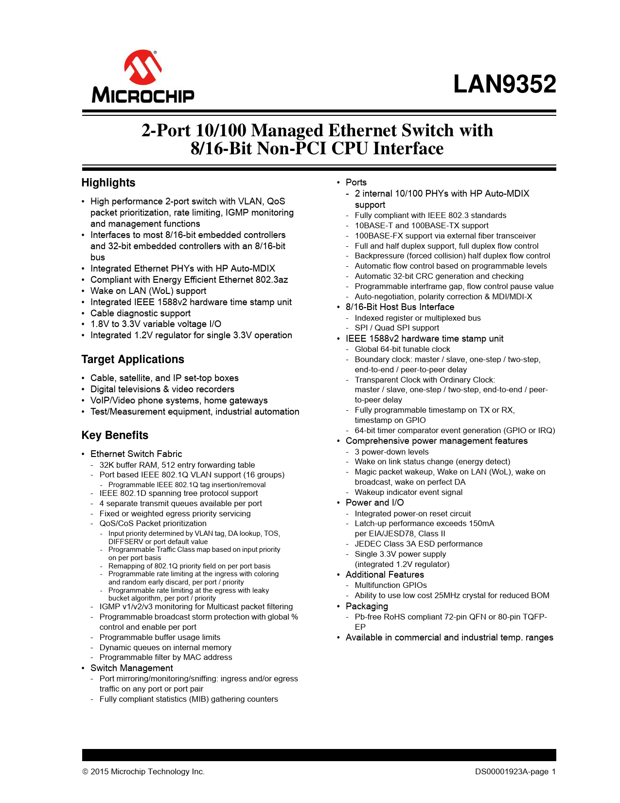

LAN9352. 2-Port 10/100 Managed Ethernet Switch with. 8/16-Bit Non-PCI CPU Interface. Highlights. Target Applications
LAN9352 2-Port 10/100 Managed Ethernet Switch with 8/16-Bit Non-PCI CPU Interface Highlights
• Ports - 2 internal 10/100 PHYs with HP Auto-MDIX • High performance 2-port switch with VLAN, QoS support packet prioritization, rate limiting, IGMP monitoring - Fully compliant with IEEE 802.3 standards and management functions - 10BASE-T and 100BASE-TX support • Interfaces to most 8/16-bit embedded controllers - 100BASE-FX support via external fiber transceiver and 32-bit embedded controllers with an 8/16-bit - Full and half duplex support, full duplex flow control bus - Backpressure (forced collision) half duplex flow control • Integrated Ethernet PHYs with HP Auto-MDIX - Automatic flow control based on programmable levels • Compliant with Energy Efficient Ethernet 802.3az - Automatic 32-bit CRC generation and checking • Wake on LAN (WoL) support - Programmable interframe gap, flow control pause value - Auto-negotiation, polarity correction & MDI/MDI-X • Integrated IEEE 1588v2 hardware time stamp unit • 8/16-Bit Host Bus Interface • Cable diagnostic support - Indexed register or multiplexed bus • 1.8V to 3.3V variable voltage I/O - SPI / Quad SPI support • Integrated 1.2V regulator for single 3.3V operation • IEEE 1588v2 hardware time stamp unit - Global 64-bit tunable clock
Target Applications
- Boundary clock: master / slave, one-step / two-step, end-to-end / peer-to-peer delay • Cable, satellite, and IP set-top boxes - Transparent Clock with Ordinary Clock: • Digital televisions & video recorders master / slave, one-step / two-step, end-to-end / peer- • VoIP/Video phone systems, home gateways to-peer delay • Test/Measurement equipment, industrial automation - Fully programmable timestamp on TX or RX, timestamp on GPIO - 64-bit timer comparator event generation (GPIO or IRQ)
Key Benefits
• Comprehensive power management features • Ethernet Switch Fabric - 3 power-down levels - 32K buffer RAM, 512 entry forwarding table - Wake on link status change (energy detect) - Port based IEEE 802.1Q VLAN support (16 groups) - Magic packet wakeup, Wake on LAN (WoL), wake on - Programmable IEEE 802.1Q tag insertion/removal broadcast, wake on perfect DA - IEEE 802.1D spanning tree protocol support - Wakeup indicator event signal - 4 separate transmit queues available per port • Power and I/O - Fixed or weighted egress priority servicing - Integrated power-on reset circuit - QoS/CoS Packet prioritization - Latch-up performance exceeds 150mA - Input priority determined by VLAN tag, DA lookup, TOS, per EIA/JESD78, Class II DIFFSERV or port default value - JEDEC Class 3A ESD performance - Programmable Traffic Class map based on input priority on per port basis - Single 3.3V power supply - Remapping of 802.1Q priority field on per port basis (integrated 1.2V regulator) - Programmable rate limiting at the ingress with coloring • Additional Features and random early discard, per port / priority - Multifunction GPIOs - Programmable rate limiting at the egress with leaky bucket algorithm, per port / priority - Ability to use low cost 25MHz crystal for reduced BOM - IGMP v1/v2/v3 monitoring for Multicast packet filtering • Packaging - Programmable broadcast storm protection with global % - Pb-free RoHS compliant 72-pin QFN or 80-pin TQFP- control and enable per port EP - Programmable buffer usage limits • Available in commercial and industrial temp. ranges - Dynamic queues on internal memory - Programmable filter by MAC address • Switch Management - Port mirroring/monitoring/sniffing: ingress and/or egress traffic on any port or port pair - Fully compliant statistics (MIB) gathering counters 2015 Microchip Technology Inc. DS00001923A-page 1 Document Outline Highlights Target Applications Key Benefits 1.0 Preface TABLE 1-1: General Terms TABLE 1-2: Buffer Types TABLE 1-3: Register Nomenclature 2.0 General Description FIGURE 2-1: Internal Block Diagram 3.0 Pin Descriptions and Configuration FIGURE 3-1: 72-QFN Pin Assignments (Top View) TABLE 3-1: 72-QFN Package Pin Assignments FIGURE 3-2: 80-TQFP-EP Pin Assignments (Top View) TABLE 3-2: 80-TQFP-EP Package Pin Assignments TABLE 3-3: LAN Port A Pin Descriptions TABLE 3-4: LAN Port B Pin Descriptions TABLE 3-5: LAN Port A & B Power and Common Pin Descriptions TABLE 3-6: Host Bus Pin Descriptions TABLE 3-7: SPI/SQI Pin Descriptions TABLE 3-8: EEPROM Pin Descriptions TABLE 3-9: GPIO, LED & Configuration Strap Pin Descriptions TABLE 3-10: Miscellaneous Pin Descriptions TABLE 3-11: JTAG Pin Descriptions TABLE 3-12: Core and I/O Power Pin Descriptions 4.0 Power Connections FIGURE 4-1: Power Connections - Regulators Enabled FIGURE 4-2: Power Connections - Regulators Disabled 5.0 Register Map FIGURE 5-1: Register Address Map TABLE 5-1: System Control and Status Registers TABLE 5-2: Read After Write Timing Rules TABLE 5-3: Read After Read Timing Rules 6.0 Clocks, Resets, and Power Management TABLE 6-1: Reset Sources and Affected Device Functionality FIGURE 6-1: PME Pin and PME Interrupt Signal Generation TABLE 6-2: Power Management States 7.0 Configuration Straps TABLE 7-1: Soft-Strap Configuration Strap Definitions TABLE 7-2: Hard-Strap Configuration Strap Definitions TABLE 7-3: HBI Strap Mapping 8.0 System Interrupts FIGURE 8-1: Functional Interrupt Hierarchy TABLE 8-1: Interrupt Registers 9.0 Host Bus Interface FIGURE 9-1: Little Endian Ordering FIGURE 9-2: Big Endian Ordering FIGURE 9-3: Multiplexed Addressing with Dual Phase Latching - 16-Bit Read FIGURE 9-4: Multiplexed Addressing with Dual Phase Latching - 16-Bit Read Without ALEHI FIGURE 9-5: Multiplexed Addressing with Dual Phase Latching - 16-Bit Write FIGURE 9-6: Multiplexed Addressing with Dual Phase Latching - 16-Bit Write Without ALEHI FIGURE 9-7: Multiplexed Addressing with Dual Phase Latching - 16-Bit Reads and Writes Constant Address FIGURE 9-8: Multiplexed Addressing with Dual Phase Latching - 8-Bit Reads FIGURE 9-9: Multiplexed Addressing with Dual Phase Latching - 8-Bit Reads Without ALEHI FIGURE 9-10: Multiplexed Addressing with Dual Phase Latching - 8-Bit Write FIGURE 9-11: Multiplexed Addressing with Dual Phase Latching - 8-Bit Write Without ALEHI FIGURE 9-12: Multiplexed Addressing with Dual Phase Latching - 8-Bit Reads and Writes Constant Address FIGURE 9-13: Multiplexed Addressing with Single Phase Latching - 16-Bit Read FIGURE 9-14: Multiplexed Addressing with Single Phase Latching - 16-Bit Write FIGURE 9-15: Multiplexed Addressing with Single Phase Latching - 16-Bit Reads and Writes Constant Address FIGURE 9-16: Multiplexed Addressing with Single Phase Latching - 8-Bit Read FIGURE 9-17: Multiplexed Addressing with Single Phase Latching - 8-Bit Write FIGURE 9-18: Multiplexed Addressing with Single Phase Latching - 8-Bit Reads and Writes Constant Address FIGURE 9-19: Multiplexed Addressing RD_WR / ENB Control Mode Example - 16- Bit Read FIGURE 9-20: Multiplexed Addressing RD_WR / ENB Control Mode Example - 16- Bit Write FIGURE 9-21: Multiplexed Addressing Read Cycle Timing TABLE 9-1: Multiplexed Addressing Read Cycle Timing Values FIGURE 9-22: Multiplexed Addressing Write Cycle Timing TABLE 9-2: Multiplexed Addressing Write Cycle Timing Values TABLE 9-3: Host Bus Interface Indexed Address Mode Register Map FIGURE 9-23: Little Endian Ordering FIGURE 9-24: Big Endian Ordering FIGURE 9-25: Indexed Addressing Configuration Register Access - 16-Bit Write/ Read FIGURE 9-26: Indexed Addressing Configuration Register Access - 8-Bit Write/ Read FIGURE 9-27: Indexed Addressing Index Register Access - 16-Bit Write/Read FIGURE 9-28: Indexed Addressing Index Register Access - 8-Bit Write/Read FIGURE 9-29: Indexed Addressing Internal Register Data Access - 16-Bit Read FIGURE 9-30: Indexed Addressing Internal Register Data Access - 16-Bit Write FIGURE 9-31: Indexed Addressing Internal Register Data Access - 16-Bit Reads/ Writes Constant Address FIGURE 9-32: Indexed Addressing Internal Register Data Access - 8-Bit Read FIGURE 9-33: Indexed Addressing Internal Register Data Access - 8-Bit Write FIGURE 9-34: Indexed Addressing Internal Register Data Access - 8-Bit Reads/ Writes Constant Address FIGURE 9-35: Indexed Addressing FIFO Direct Select Access - 16-Bit Read FIGURE 9-36: Indexed Addressing FIFO Direct Select Access - 16-Bit Write FIGURE 9-37: Indexed Addressing FIFO Direct Select Access - 16-Bit Burst Read FIGURE 9-38: Indexed Addressing FIFO Direct Select Access - 8-Bit Read FIGURE 9-39: Indexed Addressing FIFO Direct Select Access - 8-Bit Write FIGURE 9-40: Indexed Addressing FIFO Direct Select Access - 8-Bit Burst Read FIGURE 9-41: Indexed Addressing RD_WR / ENB Control Mode Example - 16-Bit Write/Read FIGURE 9-42: Indexed Addressing Read Cycle Timing TABLE 9-4: Indexed Addressing Read Cycle Timing Values FIGURE 9-43: Indexed Addressing FIFO Direct Select Burst Read Cycle Timing TABLE 9-5: Indexed Addressing FIFO Direct Select Burst Read Cycle Timing Values FIGURE 9-44: Indexed Addressing Write Cycle Timing TABLE 9-6: Indexed Addressing Write Cycle Timing Values 10.0 SPI/SQI Slave TABLE 10-1: SPI Instructions TABLE 10-2: SQI Instructions FIGURE 10-1: Enable SQI FIGURE 10-2: SPI Mode Reset SQI FIGURE 10-3: SQI Mode Reset SQI FIGURE 10-4: SPI Read FIGURE 10-5: SPI Fast Read FIGURE 10-6: SQI Fast Read FIGURE 10-7: SPI Dual Output Read FIGURE 10-8: SPI Quad Output Read FIGURE 10-9: SPI Dual I/O Read FIGURE 10-10: SPI Quad I/O Read FIGURE 10-11: SPI Write FIGURE 10-12: SQI Write FIGURE 10-13: SPI Dual Data Write FIGURE 10-14: SPI Quad Data Write FIGURE 10-15: SPI Dual Address / Data Write FIGURE 10-16: SPI Quad Address / Data Write FIGURE 10-17: SPI/SQI Input Timing FIGURE 10-18: SPI/SQI Output Timing TABLE 10-3: SPI/SQI Timing Values 11.0 Host MAC FIGURE 11-1: VLAN Frame TABLE 11-1: Address Filtering Modes TABLE 11-2: Wakeup Frame Filter Register Structure TABLE 11-3: Filter i Byte Mask Bit Definitions TABLE 11-4: Filter i Command Bit Definitions TABLE 11-5: Filter i Offset Bit Definitions TABLE 11-6: Filter i CRC-16 Bit Definitions TABLE 11-7: Wakeup Generation Cases FIGURE 11-2: RXCOE Checksum Calculation FIGURE 11-3: Type II Ethernet Frames FIGURE 11-4: Ethernet Frame With VLAN Tag FIGURE 11-5: Ethernet Frame With Length Field and SNAP Header FIGURE 11-6: Ethernet Frame With VLAN Tag and SNAP Header FIGURE 11-7: Ethernet Frame With Multiple VLAN Tags and SNAP Header TABLE 11-8: TX Checksum Preamble FIGURE 11-8: TX Example Illustrating a Prepended TX Checksum Preamble TABLE 11-9: EEPROM Byte Ordering and Register Correlation FIGURE 11-9: Example EEPROM MAC Address Setup TABLE 11-10: TX/RX FIFO Configurable Sizes TABLE 11-11: Valid TX/RX FIFO Allocations FIGURE 11-10: Simplified Host TX Flow Diagram FIGURE 11-11: TX Buffer Format TABLE 11-12: TX Command 'A' Format TABLE 11-13: TX Command 'B' Format TABLE 11-14: TX DATA Start Offset FIGURE 11-12: TX Example 1 FIGURE 11-13: TX Example 2 FIGURE 11-14: TX Example 3 FIGURE 11-15: Host Receive Routine Using Interrupts FIGURE 11-16: Host Receive Routine Using Polling FIGURE 11-17: RX Packet Format TABLE 11-15: Host MAC & FIFO Interface Logic Registers TABLE 11-16: Backpressure Duration Bit Mapping TABLE 11-17: Host MAC Addressable Registers 12.0 Ethernet PHYs TABLE 12-1: Default PHY Serial MII Addressing FIGURE 12-1: Physical PHY Block Diagram FIGURE 12-2: 100BASE-TX Transmit Data Path TABLE 12-2: 4B/5B Code Table FIGURE 12-3: 100BASE-TX Receive Data Path FIGURE 12-4: Direct Cable Connection vs. Cross-Over Cable Connection TABLE 12-3: Interrupt Management Table TABLE 12-4: Alternative Interrupt Mode Management Table TABLE 12-5: Wakeup Generation Cases FIGURE 12-5: TDR Usage Flow Diagram TABLE 12-6: TDR Propagation Constants TABLE 12-7: Typical Measurement Error for Open Cable (+/- Meters) TABLE 12-8: Typical Measurement Error for Shorted Cable (+/- Meters) TABLE 12-9: Match Case Estimated Cable Length (CBLN) Lookup FIGURE 12-6: Near-end Loopback Block Diagram FIGURE 12-7: Connection Loopback Block Diagram TABLE 12-10: 100BASE-FX LOS, SD and TP Copper Selection PHY A TABLE 12-11: 100BASE-FX LOS, SD and TP Copper Selection PHY B TABLE 12-12: Physical PHY A and B MII Serially Accessible Control and Status Registers TABLE 12-13: 10BASE-T Full Duplex Advertisement Default Value TABLE 12-14: 10BASE-T Half Duplex Advertisement Bit Default Value TABLE 12-15: MODE[2:0] Definitions TABLE 12-16: Auto-MDIX Enable and Auto-MDIX State Bit Functionality TABLE 12-17: MDIX Strap Functionality TABLE 12-18: MMD Registers TABLE 12-19: Virtual PHY MII Serially Addressable Register Index TABLE 12-20: Emulated Link Partner Pause Flow Control Ability Default Values 13.0 Switch Fabric FIGURE 13-1: ALR Table Entry Structure FIGURE 13-2: Switch Engine Transmit Queue Selection FIGURE 13-3: Switch Engine Transmit Queue Calculation FIGURE 13-4: VLAN Table Entry Structure TABLE 13-1: Spanning Tree States TABLE 13-2: Typical Ingress Rate Settings FIGURE 13-5: Switch Engine Ingress Flow Priority Selection FIGURE 13-6: Switch Engine Ingress Flow Priority Calculation TABLE 13-3: Typical Broadcast Rate Settings TABLE 13-4: Typical Egress Rate Settings FIGURE 13-7: Hybrid Port Tagging and Un-Tagging TABLE 13-5: Switch Fabric Flow Control Enable Logic FIGURE 13-8: Switch Fabrics CSR Write Access Flow Diagram FIGURE 13-9: Switch Fabrics CSR Read Access Flow Diagram TABLE 13-6: Switch Fabric Interface Logic Registers TABLE 13-7: SWITCH_MAC_ADDRL, SWITCH_MAC_ADDRH and EEPROM Byte Ordering FIGURE 13-10: Example SWITCH_MAC_ADDL, SWITCH_MAC_ADDRH and EEPROM Setup TABLE 13-8: Switch Fabric CSR to SWITCH_CSR_DIRECT_DATA Address Range Map TABLE 13-9: Indirectly Accessible Switch Control and Status Registers TABLE 13-10: Metering/Color Table Register Descriptions 14.0 I2C Master EEPROM Controller FIGURE 14-1: I2C Cycle FIGURE 14-2: I2C Master Timing TABLE 14-1: I2C Master Timing Values TABLE 14-2: I2C EEPROM Size Ranges FIGURE 14-3: I2C EEPROM Addressing FIGURE 14-4: I2C EEPROM Byte Read FIGURE 14-5: I2C EEPROM Sequential Byte Reads FIGURE 14-6: I2C EEPROM Byte Write FIGURE 14-7: EEPROM Access Flow Diagram TABLE 14-3: EEPROM Contents Format Overview FIGURE 14-8: EEPROM Loader Flow Diagram TABLE 14-4: EEPROM Configuration Bits TABLE 14-5: I2C Master EEPROM Controller Registers 15.0 IEEE 1588 FIGURE 15-1: 1588 Clock Block Diagram FIGURE 15-2: 1588 Clock Event Block Diagram TABLE 15-1: 1588 Control and Status Registers 16.0 General Purpose Timer & Free-Running Clock TABLE 16-1: Miscellaneous Registers 17.0 GPIO/LED Controller TABLE 17-1: LED Operation as a Function of LED_FUN[2:0] = 000b - 011b TABLE 17-2: LED Operation as a Function of LED_FUN[2:0] = 100b - 111b TABLE 17-3: GPIO/LED Registers 18.0 Miscellaneous TABLE 18-1: Miscellaneous Registers 19.0 JTAG TABLE 19-1: IEEE 1149.1 Op Codes FIGURE 19-1: JTAG Timing TABLE 19-2: JTAG Timing Values 20.0 Operational Characteristics TABLE 20-1: 72-PIN QFN Package Thermal Parameters TABLE 20-2: 80-PIN TQFP-EP Package Thermal Parameters TABLE 20-3: Maximum Power Dissipation TABLE 20-4: Current Consumption and Power Dissipation (Regs. Disabled) TABLE 20-5: Current Consumption and Power Dissipation (Regs. Enabled) TABLE 20-6: Non-Variable I/O DC Electrical Characteristics TABLE 20-7: Variable I/O DC Electrical Characteristics TABLE 20-8: 100BASE-TX Transceiver Characteristics TABLE 20-9: 10BASE-T Transceiver Characteristics FIGURE 20-1: Output Equivalent Test Load FIGURE 20-2: Power Sequence Timing - Internal Regulators FIGURE 20-3: Power Sequence Timing - External Regulators TABLE 20-10: Power Sequencing Timing Values FIGURE 20-4: RST# Pin Configuration Strap Latching Timing TABLE 20-11: RST# Pin Configuration Strap Latching Timing Values FIGURE 20-5: Power-On Configuration Strap Latching Timing TABLE 20-12: Power-On Configuration Strap Latching Timing Values TABLE 20-13: Crystal Specifications 21.0 Package Outlines FIGURE 21-1: 72-QFN Package FIGURE 21-2: 72-QFN Package Dimensions FIGURE 21-3: 80-TQFP-EP Package 22.0 Revision History TABLE 22-1: Revision History The Microchip Web Site Product Identification System Worldwide Sales and Service
