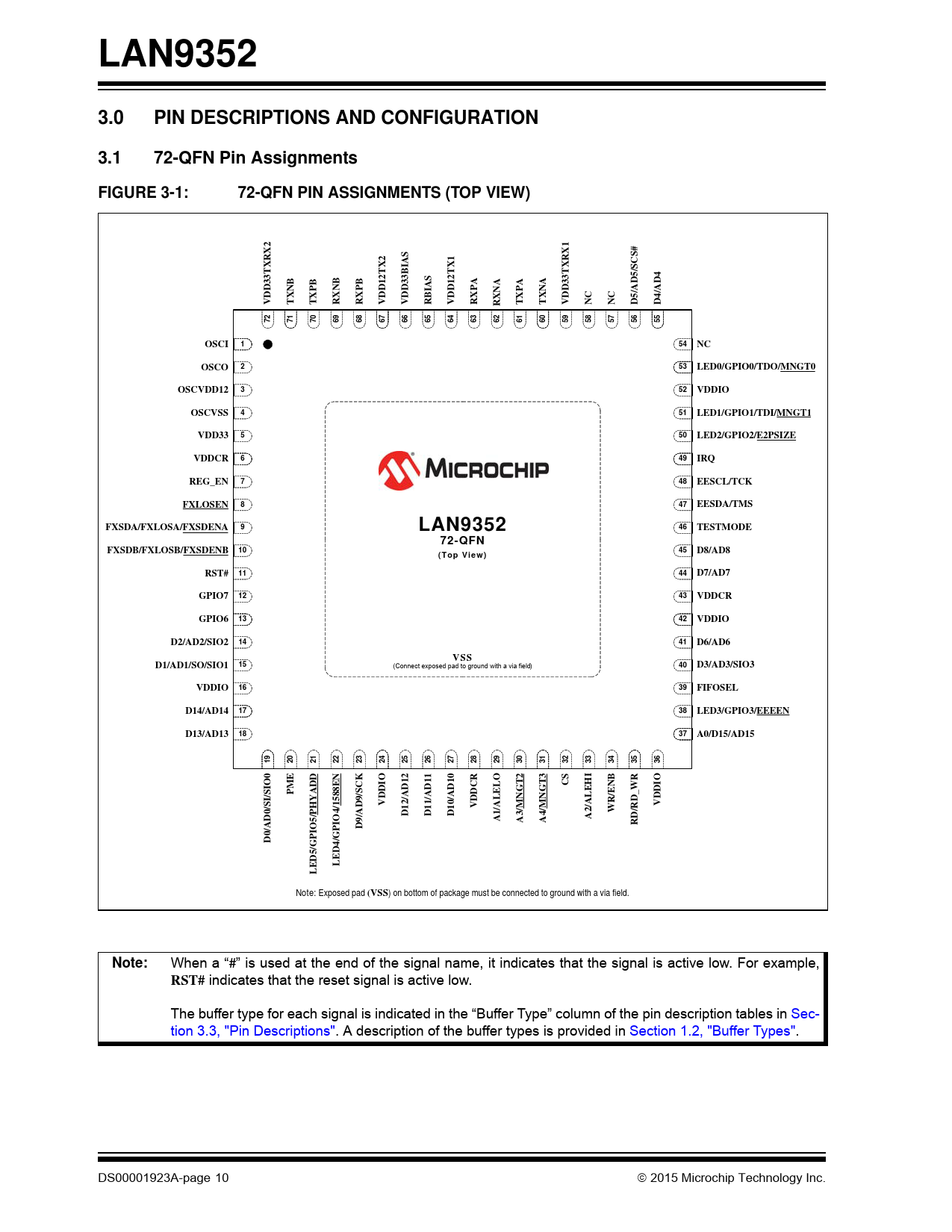

LAN9352. 3.0. PIN DESCRIPTIONS AND CONFIGURATION. 3.1. 72-QFN Pin Assignments. FIGURE 3-1:. 72-QFN PIN ASSIGNMENTS (TOP VIEW). XRX2
LAN9352 3.0 PIN DESCRIPTIONS AND CONFIGURATION 3.1 72-QFN Pin Assignments FIGURE 3-1: 72-QFN PIN ASSIGNMENTS (TOP VIEW) XRX2
link to page 18 link to page 18 link to page 6
LAN9352 3.0 PIN DESCRIPTIONS AND CONFIGURATION 3.1 72-QFN Pin Assignments FIGURE 3-1: 72-QFN PIN ASSIGNMENTS (TOP VIEW) # S XRX2 X2 IA X1 XRX1 CS /S 4 33T B 12T 33B 12T 33T D5 D NB PB N PB D D IAS D PA PA NA D /A 5 VD TX TX RX RX VD VD RB VD RX RXNA TX TX VD NC NC D D4/AD 72 71 70 69 68 67 66 65 64 63 62 61 60 59 58 57 56 55 OSCI 1 54 NC OSCO 2 53 LED0/GPIO0/TDO/MNGT0 OSCVDD12 3 52 VDDIO OSCVSS 4 51 LED1/GPIO1/TDI/MNGT1 VDD33 5 50 LED2/GPIO2/E2PSIZE VDDCR 6 49 IRQ REG_EN 7 48 EESCL/TCK FXLOSEN 8 47 EESDA/TMS FXSDA/FXLOSA/FXSDENA 9 LAN9352 46 TESTMODE 72-QFN FXSDB/FXLOSB/FXSDENB 10 45 D8/AD8 ( T o p V i e w ) RST# 11 44 D7/AD7 GPIO7 12 43 VDDCR GPIO6 13 42 VDDIO D2/AD2/SIO2 14 41 D6/AD6 VSS D1/AD1/SO/SIO1 15
(Connect exposed pad to ground with a via field)
40 D3/AD3/SIO3 VDDIO 16 39 FIFOSEL D14/AD14 17 38 LED3/GPIO3/EEEEN D13/AD13 18 37 A0/D15/AD15 19 20 21 22 23 24 25 26 27 28 29 30 31 32 33 34 35 36 E 2 3 N R I O0 IO 12 11 10 T T DD C LO CS IO D D D D G G WR PM D D /SI A A A _ YA LE N N LEH VD D /SI H /1588E D9/SCK A 12/ 11/ 10/ VD M M VD 0 4 /A A WR/ENB /R D D D 1 D A A3/ A4/ A2/ A RD PIO D9/ IO5/P D0/ /G 4 /GP 5 D E L LED Note:
Exposed pad
(VSS
) on bottom of package must be connected to ground with a via field.
Note:
When a “
” is used at the end of the signal name, it indicates that the signal is active low. For example,
RST#
indicates that the reset signal is active low. The buffer type for each signal is indicated in the “Buffer Type” column of the pin description tables in Sec- tion 3.3, "Pin Descriptions". A description of the buffer types is provided in Section 1.2, "Buffer Types". DS00001923A-page 10  2015 Microchip Technology Inc. Document Outline Highlights Target Applications Key Benefits 1.0 Preface TABLE 1-1: General Terms TABLE 1-2: Buffer Types TABLE 1-3: Register Nomenclature 2.0 General Description FIGURE 2-1: Internal Block Diagram 3.0 Pin Descriptions and Configuration FIGURE 3-1: 72-QFN Pin Assignments (Top View) TABLE 3-1: 72-QFN Package Pin Assignments FIGURE 3-2: 80-TQFP-EP Pin Assignments (Top View) TABLE 3-2: 80-TQFP-EP Package Pin Assignments TABLE 3-3: LAN Port A Pin Descriptions TABLE 3-4: LAN Port B Pin Descriptions TABLE 3-5: LAN Port A & B Power and Common Pin Descriptions TABLE 3-6: Host Bus Pin Descriptions TABLE 3-7: SPI/SQI Pin Descriptions TABLE 3-8: EEPROM Pin Descriptions TABLE 3-9: GPIO, LED & Configuration Strap Pin Descriptions TABLE 3-10: Miscellaneous Pin Descriptions TABLE 3-11: JTAG Pin Descriptions TABLE 3-12: Core and I/O Power Pin Descriptions 4.0 Power Connections FIGURE 4-1: Power Connections - Regulators Enabled FIGURE 4-2: Power Connections - Regulators Disabled 5.0 Register Map FIGURE 5-1: Register Address Map TABLE 5-1: System Control and Status Registers TABLE 5-2: Read After Write Timing Rules TABLE 5-3: Read After Read Timing Rules 6.0 Clocks, Resets, and Power Management TABLE 6-1: Reset Sources and Affected Device Functionality FIGURE 6-1: PME Pin and PME Interrupt Signal Generation TABLE 6-2: Power Management States 7.0 Configuration Straps TABLE 7-1: Soft-Strap Configuration Strap Definitions TABLE 7-2: Hard-Strap Configuration Strap Definitions TABLE 7-3: HBI Strap Mapping 8.0 System Interrupts FIGURE 8-1: Functional Interrupt Hierarchy TABLE 8-1: Interrupt Registers 9.0 Host Bus Interface FIGURE 9-1: Little Endian Ordering FIGURE 9-2: Big Endian Ordering FIGURE 9-3: Multiplexed Addressing with Dual Phase Latching - 16-Bit Read FIGURE 9-4: Multiplexed Addressing with Dual Phase Latching - 16-Bit Read Without ALEHI FIGURE 9-5: Multiplexed Addressing with Dual Phase Latching - 16-Bit Write FIGURE 9-6: Multiplexed Addressing with Dual Phase Latching - 16-Bit Write Without ALEHI FIGURE 9-7: Multiplexed Addressing with Dual Phase Latching - 16-Bit Reads and Writes Constant Address FIGURE 9-8: Multiplexed Addressing with Dual Phase Latching - 8-Bit Reads FIGURE 9-9: Multiplexed Addressing with Dual Phase Latching - 8-Bit Reads Without ALEHI FIGURE 9-10: Multiplexed Addressing with Dual Phase Latching - 8-Bit Write FIGURE 9-11: Multiplexed Addressing with Dual Phase Latching - 8-Bit Write Without ALEHI FIGURE 9-12: Multiplexed Addressing with Dual Phase Latching - 8-Bit Reads and Writes Constant Address FIGURE 9-13: Multiplexed Addressing with Single Phase Latching - 16-Bit Read FIGURE 9-14: Multiplexed Addressing with Single Phase Latching - 16-Bit Write FIGURE 9-15: Multiplexed Addressing with Single Phase Latching - 16-Bit Reads and Writes Constant Address FIGURE 9-16: Multiplexed Addressing with Single Phase Latching - 8-Bit Read FIGURE 9-17: Multiplexed Addressing with Single Phase Latching - 8-Bit Write FIGURE 9-18: Multiplexed Addressing with Single Phase Latching - 8-Bit Reads and Writes Constant Address FIGURE 9-19: Multiplexed Addressing RD_WR / ENB Control Mode Example - 16- Bit Read FIGURE 9-20: Multiplexed Addressing RD_WR / ENB Control Mode Example - 16- Bit Write FIGURE 9-21: Multiplexed Addressing Read Cycle Timing TABLE 9-1: Multiplexed Addressing Read Cycle Timing Values FIGURE 9-22: Multiplexed Addressing Write Cycle Timing TABLE 9-2: Multiplexed Addressing Write Cycle Timing Values TABLE 9-3: Host Bus Interface Indexed Address Mode Register Map FIGURE 9-23: Little Endian Ordering FIGURE 9-24: Big Endian Ordering FIGURE 9-25: Indexed Addressing Configuration Register Access - 16-Bit Write/ Read FIGURE 9-26: Indexed Addressing Configuration Register Access - 8-Bit Write/ Read FIGURE 9-27: Indexed Addressing Index Register Access - 16-Bit Write/Read FIGURE 9-28: Indexed Addressing Index Register Access - 8-Bit Write/Read FIGURE 9-29: Indexed Addressing Internal Register Data Access - 16-Bit Read FIGURE 9-30: Indexed Addressing Internal Register Data Access - 16-Bit Write FIGURE 9-31: Indexed Addressing Internal Register Data Access - 16-Bit Reads/ Writes Constant Address FIGURE 9-32: Indexed Addressing Internal Register Data Access - 8-Bit Read FIGURE 9-33: Indexed Addressing Internal Register Data Access - 8-Bit Write FIGURE 9-34: Indexed Addressing Internal Register Data Access - 8-Bit Reads/ Writes Constant Address FIGURE 9-35: Indexed Addressing FIFO Direct Select Access - 16-Bit Read FIGURE 9-36: Indexed Addressing FIFO Direct Select Access - 16-Bit Write FIGURE 9-37: Indexed Addressing FIFO Direct Select Access - 16-Bit Burst Read FIGURE 9-38: Indexed Addressing FIFO Direct Select Access - 8-Bit Read FIGURE 9-39: Indexed Addressing FIFO Direct Select Access - 8-Bit Write FIGURE 9-40: Indexed Addressing FIFO Direct Select Access - 8-Bit Burst Read FIGURE 9-41: Indexed Addressing RD_WR / ENB Control Mode Example - 16-Bit Write/Read FIGURE 9-42: Indexed Addressing Read Cycle Timing TABLE 9-4: Indexed Addressing Read Cycle Timing Values FIGURE 9-43: Indexed Addressing FIFO Direct Select Burst Read Cycle Timing TABLE 9-5: Indexed Addressing FIFO Direct Select Burst Read Cycle Timing Values FIGURE 9-44: Indexed Addressing Write Cycle Timing TABLE 9-6: Indexed Addressing Write Cycle Timing Values 10.0 SPI/SQI Slave TABLE 10-1: SPI Instructions TABLE 10-2: SQI Instructions FIGURE 10-1: Enable SQI FIGURE 10-2: SPI Mode Reset SQI FIGURE 10-3: SQI Mode Reset SQI FIGURE 10-4: SPI Read FIGURE 10-5: SPI Fast Read FIGURE 10-6: SQI Fast Read FIGURE 10-7: SPI Dual Output Read FIGURE 10-8: SPI Quad Output Read FIGURE 10-9: SPI Dual I/O Read FIGURE 10-10: SPI Quad I/O Read FIGURE 10-11: SPI Write FIGURE 10-12: SQI Write FIGURE 10-13: SPI Dual Data Write FIGURE 10-14: SPI Quad Data Write FIGURE 10-15: SPI Dual Address / Data Write FIGURE 10-16: SPI Quad Address / Data Write FIGURE 10-17: SPI/SQI Input Timing FIGURE 10-18: SPI/SQI Output Timing TABLE 10-3: SPI/SQI Timing Values 11.0 Host MAC FIGURE 11-1: VLAN Frame TABLE 11-1: Address Filtering Modes TABLE 11-2: Wakeup Frame Filter Register Structure TABLE 11-3: Filter i Byte Mask Bit Definitions TABLE 11-4: Filter i Command Bit Definitions TABLE 11-5: Filter i Offset Bit Definitions TABLE 11-6: Filter i CRC-16 Bit Definitions TABLE 11-7: Wakeup Generation Cases FIGURE 11-2: RXCOE Checksum Calculation FIGURE 11-3: Type II Ethernet Frames FIGURE 11-4: Ethernet Frame With VLAN Tag FIGURE 11-5: Ethernet Frame With Length Field and SNAP Header FIGURE 11-6: Ethernet Frame With VLAN Tag and SNAP Header FIGURE 11-7: Ethernet Frame With Multiple VLAN Tags and SNAP Header TABLE 11-8: TX Checksum Preamble FIGURE 11-8: TX Example Illustrating a Prepended TX Checksum Preamble TABLE 11-9: EEPROM Byte Ordering and Register Correlation FIGURE 11-9: Example EEPROM MAC Address Setup TABLE 11-10: TX/RX FIFO Configurable Sizes TABLE 11-11: Valid TX/RX FIFO Allocations FIGURE 11-10: Simplified Host TX Flow Diagram FIGURE 11-11: TX Buffer Format TABLE 11-12: TX Command 'A' Format TABLE 11-13: TX Command 'B' Format TABLE 11-14: TX DATA Start Offset FIGURE 11-12: TX Example 1 FIGURE 11-13: TX Example 2 FIGURE 11-14: TX Example 3 FIGURE 11-15: Host Receive Routine Using Interrupts FIGURE 11-16: Host Receive Routine Using Polling FIGURE 11-17: RX Packet Format TABLE 11-15: Host MAC & FIFO Interface Logic Registers TABLE 11-16: Backpressure Duration Bit Mapping TABLE 11-17: Host MAC Addressable Registers 12.0 Ethernet PHYs TABLE 12-1: Default PHY Serial MII Addressing FIGURE 12-1: Physical PHY Block Diagram FIGURE 12-2: 100BASE-TX Transmit Data Path TABLE 12-2: 4B/5B Code Table FIGURE 12-3: 100BASE-TX Receive Data Path FIGURE 12-4: Direct Cable Connection vs. Cross-Over Cable Connection TABLE 12-3: Interrupt Management Table TABLE 12-4: Alternative Interrupt Mode Management Table TABLE 12-5: Wakeup Generation Cases FIGURE 12-5: TDR Usage Flow Diagram TABLE 12-6: TDR Propagation Constants TABLE 12-7: Typical Measurement Error for Open Cable (+/- Meters) TABLE 12-8: Typical Measurement Error for Shorted Cable (+/- Meters) TABLE 12-9: Match Case Estimated Cable Length (CBLN) Lookup FIGURE 12-6: Near-end Loopback Block Diagram FIGURE 12-7: Connection Loopback Block Diagram TABLE 12-10: 100BASE-FX LOS, SD and TP Copper Selection PHY A TABLE 12-11: 100BASE-FX LOS, SD and TP Copper Selection PHY B TABLE 12-12: Physical PHY A and B MII Serially Accessible Control and Status Registers TABLE 12-13: 10BASE-T Full Duplex Advertisement Default Value TABLE 12-14: 10BASE-T Half Duplex Advertisement Bit Default Value TABLE 12-15: MODE[2:0] Definitions TABLE 12-16: Auto-MDIX Enable and Auto-MDIX State Bit Functionality TABLE 12-17: MDIX Strap Functionality TABLE 12-18: MMD Registers TABLE 12-19: Virtual PHY MII Serially Addressable Register Index TABLE 12-20: Emulated Link Partner Pause Flow Control Ability Default Values 13.0 Switch Fabric FIGURE 13-1: ALR Table Entry Structure FIGURE 13-2: Switch Engine Transmit Queue Selection FIGURE 13-3: Switch Engine Transmit Queue Calculation FIGURE 13-4: VLAN Table Entry Structure TABLE 13-1: Spanning Tree States TABLE 13-2: Typical Ingress Rate Settings FIGURE 13-5: Switch Engine Ingress Flow Priority Selection FIGURE 13-6: Switch Engine Ingress Flow Priority Calculation TABLE 13-3: Typical Broadcast Rate Settings TABLE 13-4: Typical Egress Rate Settings FIGURE 13-7: Hybrid Port Tagging and Un-Tagging TABLE 13-5: Switch Fabric Flow Control Enable Logic FIGURE 13-8: Switch Fabrics CSR Write Access Flow Diagram FIGURE 13-9: Switch Fabrics CSR Read Access Flow Diagram TABLE 13-6: Switch Fabric Interface Logic Registers TABLE 13-7: SWITCH_MAC_ADDRL, SWITCH_MAC_ADDRH and EEPROM Byte Ordering FIGURE 13-10: Example SWITCH_MAC_ADDL, SWITCH_MAC_ADDRH and EEPROM Setup TABLE 13-8: Switch Fabric CSR to SWITCH_CSR_DIRECT_DATA Address Range Map TABLE 13-9: Indirectly Accessible Switch Control and Status Registers TABLE 13-10: Metering/Color Table Register Descriptions 14.0 I2C Master EEPROM Controller FIGURE 14-1: I2C Cycle FIGURE 14-2: I2C Master Timing TABLE 14-1: I2C Master Timing Values TABLE 14-2: I2C EEPROM Size Ranges FIGURE 14-3: I2C EEPROM Addressing FIGURE 14-4: I2C EEPROM Byte Read FIGURE 14-5: I2C EEPROM Sequential Byte Reads FIGURE 14-6: I2C EEPROM Byte Write FIGURE 14-7: EEPROM Access Flow Diagram TABLE 14-3: EEPROM Contents Format Overview FIGURE 14-8: EEPROM Loader Flow Diagram TABLE 14-4: EEPROM Configuration Bits TABLE 14-5: I2C Master EEPROM Controller Registers 15.0 IEEE 1588 FIGURE 15-1: 1588 Clock Block Diagram FIGURE 15-2: 1588 Clock Event Block Diagram TABLE 15-1: 1588 Control and Status Registers 16.0 General Purpose Timer & Free-Running Clock TABLE 16-1: Miscellaneous Registers 17.0 GPIO/LED Controller TABLE 17-1: LED Operation as a Function of LED_FUN[2:0] = 000b - 011b TABLE 17-2: LED Operation as a Function of LED_FUN[2:0] = 100b - 111b TABLE 17-3: GPIO/LED Registers 18.0 Miscellaneous TABLE 18-1: Miscellaneous Registers 19.0 JTAG TABLE 19-1: IEEE 1149.1 Op Codes FIGURE 19-1: JTAG Timing TABLE 19-2: JTAG Timing Values 20.0 Operational Characteristics TABLE 20-1: 72-PIN QFN Package Thermal Parameters TABLE 20-2: 80-PIN TQFP-EP Package Thermal Parameters TABLE 20-3: Maximum Power Dissipation TABLE 20-4: Current Consumption and Power Dissipation (Regs. Disabled) TABLE 20-5: Current Consumption and Power Dissipation (Regs. Enabled) TABLE 20-6: Non-Variable I/O DC Electrical Characteristics TABLE 20-7: Variable I/O DC Electrical Characteristics TABLE 20-8: 100BASE-TX Transceiver Characteristics TABLE 20-9: 10BASE-T Transceiver Characteristics FIGURE 20-1: Output Equivalent Test Load FIGURE 20-2: Power Sequence Timing - Internal Regulators FIGURE 20-3: Power Sequence Timing - External Regulators TABLE 20-10: Power Sequencing Timing Values FIGURE 20-4: RST# Pin Configuration Strap Latching Timing TABLE 20-11: RST# Pin Configuration Strap Latching Timing Values FIGURE 20-5: Power-On Configuration Strap Latching Timing TABLE 20-12: Power-On Configuration Strap Latching Timing Values TABLE 20-13: Crystal Specifications 21.0 Package Outlines FIGURE 21-1: 72-QFN Package FIGURE 21-2: 72-QFN Package Dimensions FIGURE 21-3: 80-TQFP-EP Package 22.0 Revision History TABLE 22-1: Revision History The Microchip Web Site Product Identification System Worldwide Sales and Service
