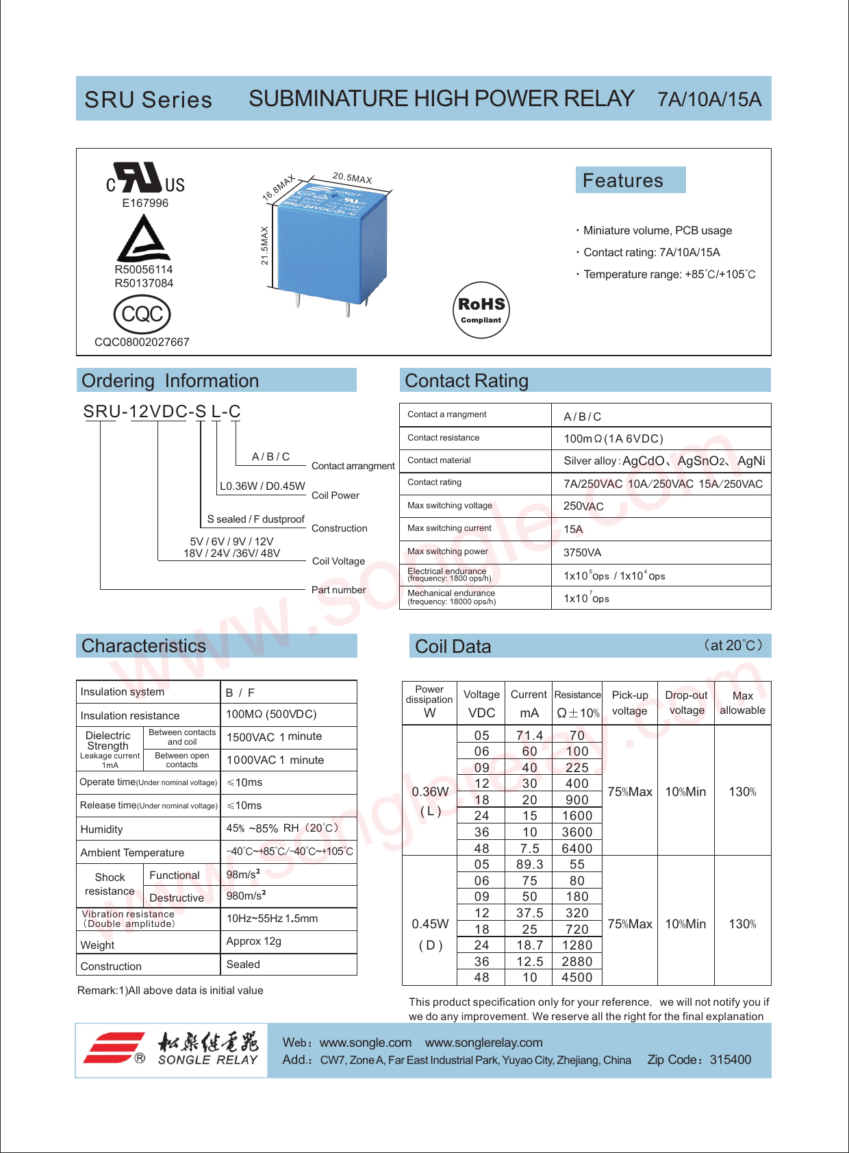

SRU. Series. SUBMINATURE. HIGH. POWER. RELAY. 7A/10A/15A. C. US. 20.5MAX. AX. Features. E167996. 16.8M. X. ·Miniature. volume,. PCB. usage. A. M. .5. ·Contact
Datasheet SRU Songle Relay
SRU Series SUBMINATURE HIGH POWER RELAY 7A/10A/15A C US 20.5MAX AX Features E167996 16.8M X ·Miniature volume, PCB usage A M .5 ·Contact rating: 7A/10A/15A 1 2 R50056114 ·Temperature range: +85℃/+105℃ R50137084 CQC CQC08002027667 Ordering Information Contact Rating SRU-12VDC-S L-C Contact a rrangment A / B / C Contact resistance 100mΩ(1A 6VDC) A / B / C Contact material Silver alloy:AgCdO、AgSnO2、AgNi Contact arrangment Contact rating 7A/250VAC 10A/250VAC 15 L0.36W / D0.45W A/250VAC Coil Power Max switching voltage 250VAC S sealed / F dustproof Construction Max switching current 15A 5V / 6V / 9V / 12V 18V / 24V /36V/ 48V Max switching power 3750VA Coil Voltage Electrical endurance (frequency: 1800 ops/h) 1x10 5ops / 1x10 4ops Part number 7 endurance Mechanical 1x10 ops (frequency: 18000 ops/h) Characteristics Coil Data ( 20 at ℃) Insulation system B / F Power Voltage Current Resistance dissipation Pick-up Drop-out Max Insulation resistance 100MΩ (500VDC) W VDC mA ± Ω 10% voltage voltage allowable Dielectric Between contacts 1500VAC 1 minute 05 71.4 70 Strength and coil 06 60 100 Leakage current Between open 1000VAC 1 minute 1mA contacts 09 40 225 Operate time(Under nominal voltage) ≤10ms 12 30 400 0.36W 75%Max 10%Min 130% 18 20 900 Release time(Under nominal voltage) ≤10ms ( L ) 24 15 1600 Humidity 45% ~85% RH(20℃) 36 10 3600 Ambient Temperature -40℃~+85℃/-40℃~+105℃ 48 7.5 6400 05 89.3 55 Functional 98m/s
²
Shock 06 75 80 resistance Destructive 980m/s
²
09 50 180 Vibration resistance 12 37.5 320 10Hz
55Hz
