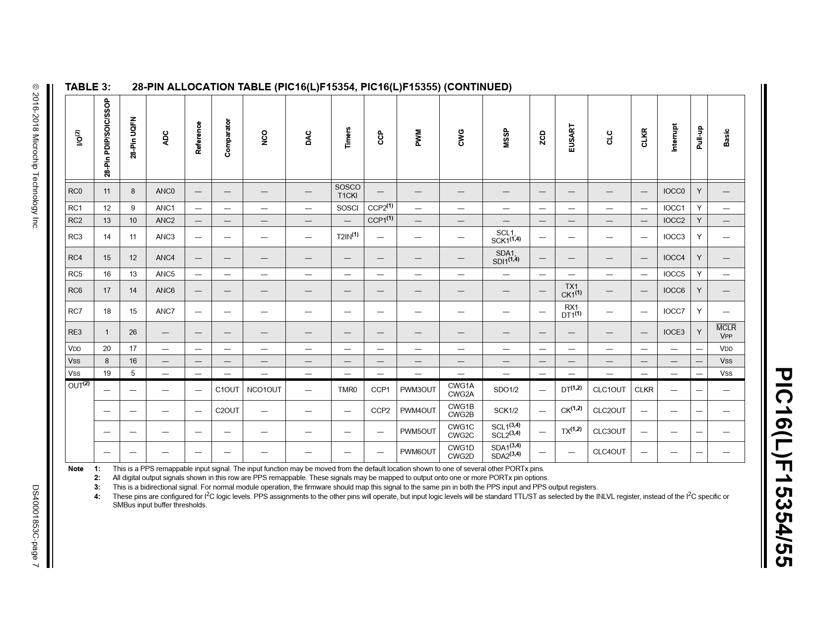

TABLE 3:. 28-PIN ALLOCATION TABLE (PIC16(L)F15354, PIC16(L)F15355) (CONTINUED). P O S. OIC/S. ator. ll-u. asic. I/O. ADC. feren. DAC. ime. CCP
2016-2
TABLE 3: 28-PIN ALLOCATION TABLE (PIC16(L)F15354, PIC16(L)F15355) (CONTINUED) P O S
018 M
FN ce t ) OIC/S Q ator p p O rs P D RT C
i
(2 ar S ru
c
/S U p KR ll-u asic
r
in u
ochip
I/O IP ADC feren NC DAC ime CCP ZC CL ter D P m PWM CWG MS CL B o T EUSA In P P Re C in 28-
T
P
e chnology
28-
SOSCO RC0 11 8 ANC0 ― ― ― ― ― ― ― ― ― ― ― ― IOCC0 Y ― T1CKI RC1 12 9 ANC1 ― ― ― ― SOSCI CCP2
(1)
― ― ― ― ― ― ― IOCC1 Y ― Inc RC2 13 10 ANC2 ― ― ― ― ― CCP1
(1)
― ― ― ― ― ― ― IOCC2 Y ― . SCL1, RC3 14 11 ANC3 ― ― ― ― T2IN
(1)
― ― ― SCK1
(1,4)
― ― ― ― IOCC3 Y ― SDA1, RC4 15 12 ANC4 ― ― ― ― ― ― ― ― SDI1
(1,4)
― ― ― ― IOCC4 Y ― RC5 16 13 ANC5 ― ― ― ― ― ― ― ― ― ― ― ― ― IOCC5 Y ― TX1 RC6 17 14 ANC6 ― ― ― ― ― ― ― ― ― ― CK1
(1)
― ― IOCC6 Y ― RX1 RC7 18 15 ANC7 ― ― ― ― ― ― ― ― ― ― DT1
(1)
― ― IOCC7 Y ― MCLR RE3 1 26 — ― ― ― ― ― ― ― ― ― ― ― ― ― IOCE3 Y VPP VDD 20 17 ― ― ― ― ― ― ― ― ― ― ― ― ― ― ― ― VDD VSS 8 16 ― ― ― ― ― ― ― ― ― ― ― ― ― ― ― ― VSS
PIC16(L)F1535
VSS 19 5 ― ― ― ― ― ― ― ― ― ― ― ― ― ― ― ― VSS OUT
(2)
CWG1A ― ― ― ― C1OUT NCO1OUT ― TMR0 CCP1 PWM3OUT SDO1/2 ― DT
(1,2)
CLC1OUT CLKR ― ― ― CWG2A CWG1B ― ― ― ― C2OUT ― ― ― CCP2 PWM4OUT SCK1/2 ― CK
(1,2)
CLC2OUT ― ― ― ― CWG2B CWG1C SCL1
(3,4)
― ― ― ― ― ― ― ― ― PWM5OUT CWG2C SCL2
(3,4)
― TX
(1,2)
CLC3OUT ― ― ― ― CWG1D SDA1
(3,4)
― ― ― ― ― ― ― ― ― PWM6OUT CWG2D SDA2
(3,4)
― ― CLC4OUT ― ― ― ―
Note 1:
This is a PPS remappable input signal. The input function may be moved from the default location shown to one of several other PORTx pins. DS40001853C
2:
Al digital output signals shown in this row are PPS remappable. These signals may be mapped to output onto one or more PORTx pin options.
3:
This is a bidirectional signal. For normal module operation, the firmware should map this signal to the same pin in both the PPS input and PPS output registers.
4:
These pins are configured for I2C logic levels. PPS assignments to the other pins will operate, but input logic levels will be standard TTL/ST as selected by the INLVL register, instead of the I2C specific or SMBus input buffer thresholds.
