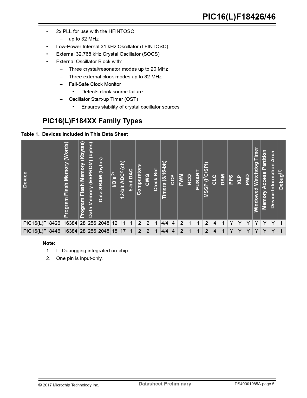

PIC16(L)F18426/46. • 2x PLL for use with the HFINTOSC. – up to 32 MHz. Low-Power Internal 31 kHz Oscillator (LFINTOSC)
PIC16(L)F18426/46 • 2x PLL for use with the HFINTOSC – up to 32 MHz Low-Power Internal 31 kHz Oscillator (LFINTOSC)
PIC16(L)F18426/46
– up to 32 MHz
External 32.768 kHz Crystal Oscillator (SOCS)
External Oscillator Block with:
– Three crystal/resonator modes up to 20 MHz
– Three external clock modes up to 32 MHz
– Fail-Safe Clock Monitor
• Detects clock source failure
Oscillator Start-up Timer (OST)
• Ensures stability of crystal oscillator sources – PIC16(L)F184XX Family Types 1 2 4 1 Y Y Y Y Y Y I PIC16(L)F18446 16384 28 256 2048 18 17 1 2 2 1 4/4 4 2 1 1 2 4 1 Y Y Y Y Y Y I Note: 
1. I -Debugging integrated on-chip.
2. One pin is input-only. © 2017 Microchip Technology Inc. Datasheet Preliminary DS40001985A-page 5 Debug(1) DSM Device Information Area CLC Memory Access Partition MSSP (I2C/SPI) Windowed Watchdog Timer EUSART 1 PMD NCO 2 XLP PWM 1 4/4 4 PPS CCP Timers (8/16-bit) CWG
2 Clock Ref Comparators
2 I/O’s(2) PIC16(L)F18426 16384 28 256 2048 12 11 1 Device 5-bit DAC 12-bit ADC2 (ch) Data SRAM (bytes) Data Memory (EEPROM) (bytes) Program Flash Memory (Kbytes) Program Flash Memory (Words) Table 1. Devices Included In This Data Sheet
