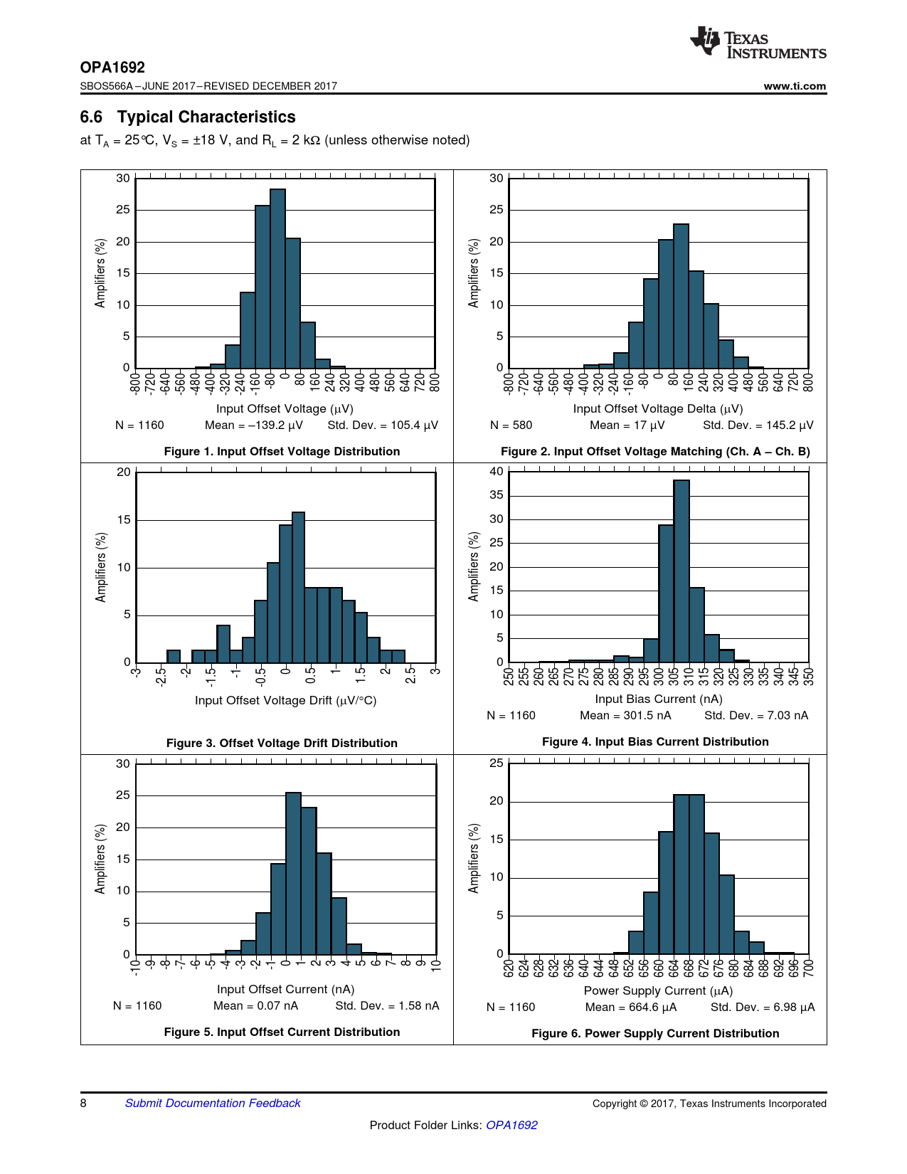

OPA1692. www.ti.com. 6.6 Typical Characteristics. Figure 1. Input Offset Voltage Distribution
OPA1692 www.ti.com 6.6 Typical Characteristics Figure 1 Input Offset Voltage Distribution
OPA1692
SBOS566A – JUNE 2017 – REVISED DECEMBER 2017
at TA = 25°C, VS = ±18 V, and RL = 2 kΩ (unless otherwise noted) 30 30 25 25 ) 20 ) 20 (% (% ifiers 15 ifiers 15 pl pl m m A 10 A 10 5 5 0 0 0 0 0 0 0 0 0 0 0 0 0 0 0 0 0 0 0 0 0 0 0 0 0 0 0 0 0 0 0 0 0 0 0 0 0 0 0 0 0 0 0 0 0 2 4 6 8 0 2 4 6 -8 8 0 2 4 6 8 0 2 4 6 -8 8 -8 -7 -6 -5 -4 -4 -3 -2 -1 16 24 32 40 48 56 64 72 80 -8 -7 -6 -5 -4 -4 -3 -2 -1 16 24 32 40 48 56 64 72 80 Input Offset Voltage (PV) Input Offset Voltage Delta (PV) N = 1160 Mean = –139.2 µV Std. Dev. = 105.4 µV N = 580 Mean = 17 µV Std. Dev. = 145.2 µV
Figure 1. Input Offset Voltage Distribution Figure 2. Input Offset Voltage Matching (Ch. A – Ch. B)
20 40 35 15 30 ) (% 25 s (%) er 10 ifiers 20 plifi pl m 15 Am A 5 10 5 0 0 -3 0 1 2 3 0 5 0 5 0 5 0 5 0 5 0 5 0 5 0 5 0 5 0 5 0 -2.5 -2 -1.5 -1 -0.5 0.5 1.5 2.5 25 25 26 26 27 27 28 28 29 29 30 30 31 31 32 32 33 33 34 34 35 Input Offset Voltage Drift (PV/qC) Input Bias Current (nA) N = 1160 Mean = 301.5 nA Std. Dev. = 7.03 nA
Figure 3. Offset Voltage Drift Distribution Figure 4. Input Bias Current Distribution
30 25 25 20 ) 20 (% (%) 15 ers ifi 15 ifiers pl pl m 10 Am 10 A 5 5 0 0 0 0 0 4 8 2 6 0 4 8 2 6 0 4 8 2 6 0 4 8 2 6 0 -9 -8 -7 -6 -5 -4 -3 -2 -1 0 1 2 3 4 5 6 7 8 9 -1 1 62 62 62 63 63 64 64 64 65 65 66 66 66 67 67 68 68 68 69 69 70 Input Offset Current (nA) Power Supply Current (PA) N = 1160 Mean = 0.07 nA Std. Dev. = 1.58 nA N = 1160 Mean = 664.6 µA Std. Dev. = 6.98 µA
Figure 5. Input Offset Current Distribution Figure 6. Power Supply Current Distribution
