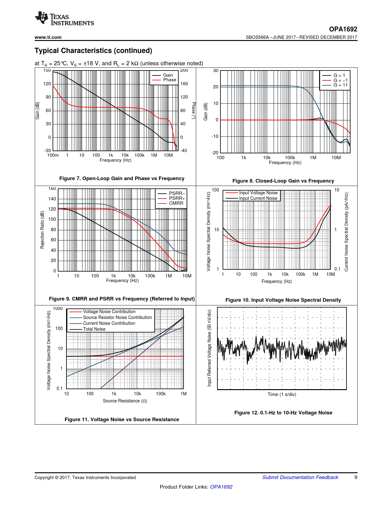

Typical Characteristics (continued)
at TA = 25°C, VS = ±18 V, and RL = 2 kΩ (unless otherwise noted) 150 200 30 Gain G = 1 Phase G = 1 120 160 20 G = 11 90 120 ) Ph ) 10 B a se ( 60 80 (dB in (d n a q G ) Gai 0 30 40 -10 0 0 -30 -40 -20 100m 1 10 100 1k 10k 100k 1M 10M 100 1k 10k 100k 1M 10M Frequency (Hz) Frequency (Hz)
Figure 7. Open-Loop Gain and Phase vs Frequency Figure 8. Closed-Loop Gain vs Frequency
160 100 10 PSRR ] Input Voltage Noise ] 140 PSRR ¥+ Input Current Noise ¥+ CMRR Q9 S$ ) 120 W\ W\ (dB 100 HQVL HQVL tio Ra 80 UDO' 10 1 UDO' n ctio SHFW SHFW e 60 6 6 ej R 40 RLVH RLVH 1 1 20 ROWDJH XUUHQW 9 1 0.1 0 & 1 10 100 1k 10k 100k 1M 10M 1 10 100 1k 10k 100k 1M 10M Frequency (Hz) Frequency (Hz) C001
Figure 9. CMRR and PSRR vs Frequency (Referred to Input) Figure 10. Input Voltage Noise Spectral Density
1000 ] Voltage Noise Contribution v) ¥+ Source Resistor Noise Contribution Q9 Current Noise Contribution 0 nV/di 100 5 W\ Total Noise e ( is HQVL o e N UDO' 10 ltag o SHFW 6 V red RLVH 1 er 1 ef R t ROWDJH Inpu 9 0.1 10 100 1k 10k 100k 1M Time (1 s/div) Source Resistance (O) C001
Figure 12. 0.1-Hz to 10-Hz Voltage Noise Figure 11. Voltage Noise vs Source Resistance
