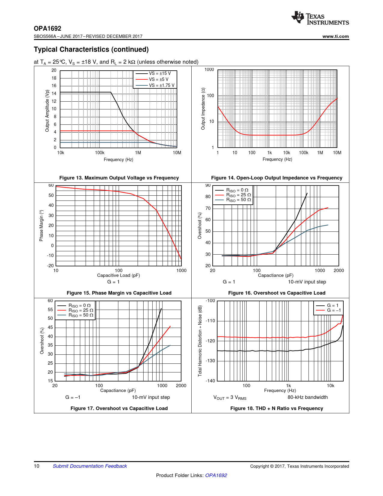

OPA1692. www.ti.com. Typical Characteristics (continued). Figure 13. Maximum Output Voltage vs Frequency
OPA1692 www.ti.com Typical Characteristics (continued) Figure 13 Maximum Output Voltage vs Frequency
OPA1692
SBOS566A – JUNE 2017 – REVISED DECEMBER 2017
at TA = 25°C, VS = ±18 V, and RL = 2 kΩ (unless otherwise noted) 20 1000 VS = ±15 V 18 VS = ±5 V 16 VS = ±1.75 V ) p 14 (O (V 100 ce e 12 n d a d litu 10 e p p m Im A 8 t t u u 10 tp tp 6 Ou Ou 4 2 0 1 10k 100k 1M 10M 1 10 100 1k 10k 100k 1M 10M Frequency (Hz) Frequency (Hz) C001 C001
Figure 13. Maximum Output Voltage vs Frequency Figure 14. Open-Loop Output Impedance vs Frequency
60 90 RISO = 0 : 50 80 RISO = 25 : RISO = 50 : 40 70 (q) n 30 rgi t ( 60 20 Ma se 50 a h 10 Overshoo P 40 0 -10 30 -20 20 10 100 1000 20 100 1000 2000 Capacitive Load (pF) Capactiance (pF) G = 1 G = 1 10-mV input step
Figure 15. Phase Margin vs Capacitive Load Figure 16. Overshoot vs Capacitive Load
60 -100 RISO = 0 : G = 1 55 RISO = 25 : (dB) G = 1 RISO = 50 : 50 se oi -110 N ) 45 t ( 40 tion or -120 35 Dist Overshoo 30 rmonic -130 25 Ha al 20 ot T 15 -140 20 100 1000 2000 100 1k 10k Capactiance (pF) Frequency (Hz) G = –1 10-mV input step VOUT = 3 VRMS 80-kHz bandwidth
Figure 17. Overshoot vs Capacitive Load Figure 18. THD + N Ratio vs Frequency
