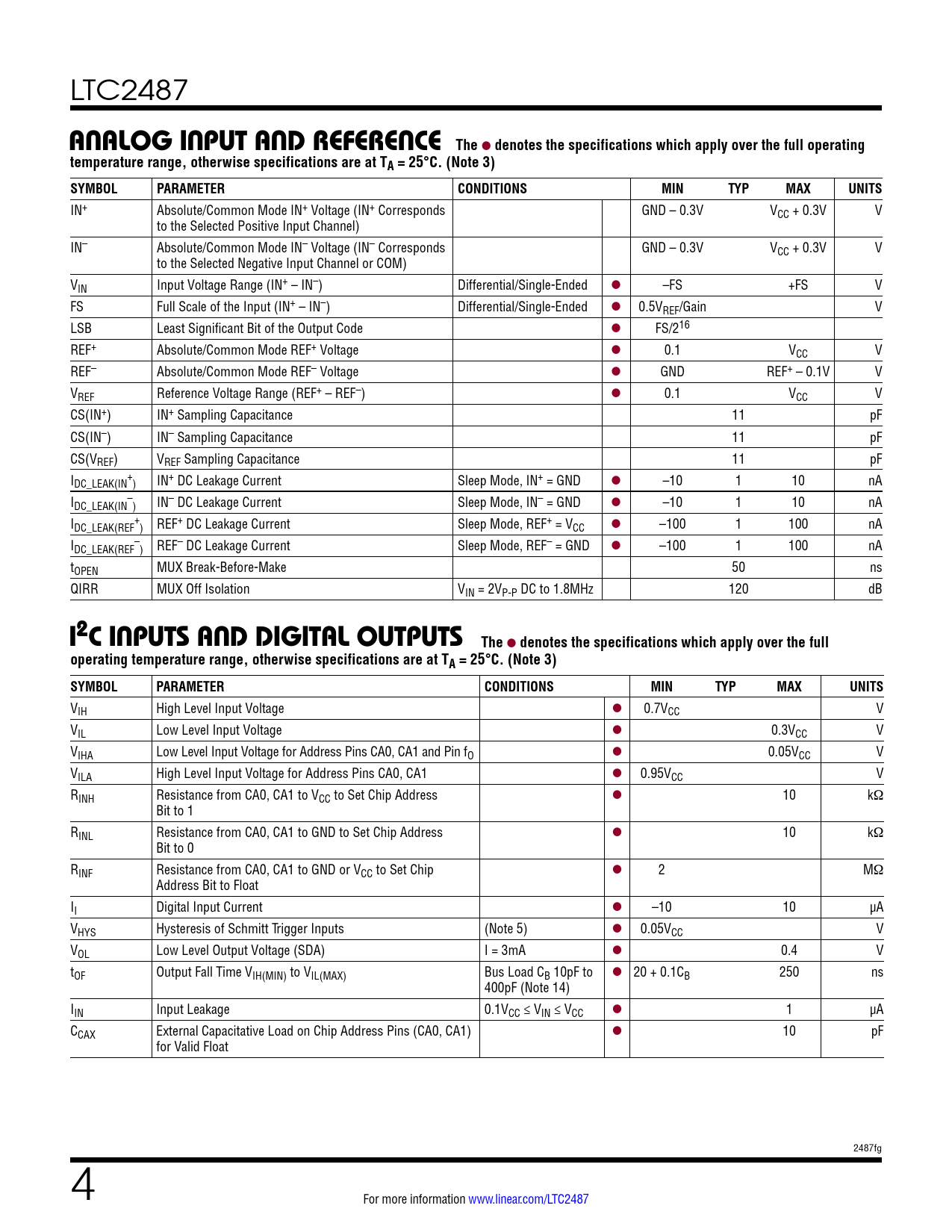

ANALOG. INPUT AND REFERENCE The. denotes the specifications which apply over the full operating
ANALOG INPUT AND REFERENCE The denotes the specifications which apply over the full operating
LTC2487
l
denotes the specifications which apply over the full operating temperature range, otherwise specifications are at TA = 25°C. (Note 3) SYMBOL PARAMETER CONDITIONS MIN TYP MAX UNITS
IN+ Absolute/Common Mode IN+ Voltage (IN+ Corresponds GND – 0.3V VCC + 0.3V V to the Selected Positive Input Channel) IN– Absolute/Common Mode IN– Voltage (IN– Corresponds GND – 0.3V VCC + 0.3V V to the Selected Negative Input Channel or COM) VIN Input Voltage Range (IN+ – IN–) Differential/Single-Ended l –FS +FS V FS Full Scale of the Input (IN+ – IN–) Differential/Single-Ended l 0.5VREF/Gain V LSB Least Significant Bit of the Output Code l FS/216 REF+ Absolute/Common Mode REF+ Voltage l 0.1 VCC V REF– Absolute/Common Mode REF– Voltage l GND REF+ – 0.1V V VREF Reference Voltage Range (REF+ – REF–) l 0.1 VCC V CS(IN+) IN+ Sampling Capacitance 11 pF CS(IN–) IN– Sampling Capacitance 11 pF CS(VREF) VREF Sampling Capacitance 11 pF I + DC_LEAK(IN ) IN+ DC Leakage Current Sleep Mode, IN+ = GND l –10 1 10 nA I – DC_LEAK(IN ) IN– DC Leakage Current Sleep Mode, IN– = GND l –10 1 10 nA I + DC_LEAK(REF ) REF+ DC Leakage Current Sleep Mode, REF+ = VCC l –100 1 100 nA I – DC_LEAK(REF ) REF– DC Leakage Current Sleep Mode, REF– = GND l –100 1 100 nA tOPEN MUX Break-Before-Make 50 ns QIRR MUX Off Isolation VIN = 2VP-P DC to 1.8MHz 120 dB
I2 C INPUTS AND DIGITAL OUTPUTS The
l
VIH High Level Input Voltage l 0.7VCC V VIL Low Level Input Voltage l 0.3VCC V VIHA Low Level Input Voltage for Address Pins CA0, CA1 and Pin fO l 0.05VCC V VILA High Level Input Voltage for Address Pins CA0, CA1 l 0.95VCC V RINH Resistance from CA0, CA1 to VCC to Set Chip Address l 10 kW Bit to 1 RINL Resistance from CA0, CA1 to GND to Set Chip Address l 10 kW Bit to 0 RINF Resistance from CA0, CA1 to GND or VCC to Set Chip l 2 MW Address Bit to Float II Digital Input Current l –10 10 µA VHYS Hysteresis of Schmitt Trigger Inputs (Note 5) l 0.05VCC V VOL Low Level Output Voltage (SDA) I = 3mA l 0.4 V tOF Output Fall Time VIH(MIN) to VIL(MAX) Bus Load CB 10pF to l 20 + 0.1CB 250 ns 400pF (Note 14) IIN Input Leakage 0.1VCC ≤ VIN ≤ VCC l 1 µA CCAX External Capacitative Load on Chip Address Pins (CA0, CA1) l 10 pF for Valid Float 2487fg 4 For more information www.linear.com/LTC2487 Document Outline Features Applications Typical Application Description Absolute Maximum Ratings Order Information Pin Configuration Electrical Characteristics (Normal Speed) Electrical Characteristics (2x Speed) Converter Characteristics Analog Input and Reference I2C Inputs and Digital Outputs Power Requirements Digital Inputs and Digital Outputs I2C Timing Characteristics Typical Performance Characteristics Functional Block Diagram Applications Information Package Description Revision History Typical Application Related Parts
