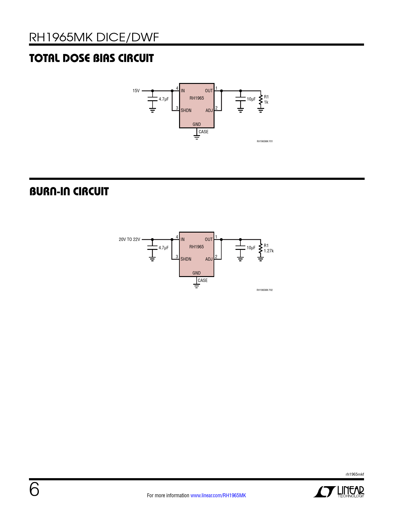

Pages / Page8 / 6 — total Dose bias circuit. burn-in circuit
File Format / SizePDF / 571 Kb
total Dose bias circuit burn-in circuit
RH1965MK DICE/DWF
4 15V IN OUT 1 4.7µF RH1965 10µF R1 1k 3 SHDN ADJ 2 GND CASE RH1965MK F01
burn-in circuit
4 20V TO 22V IN OUT 1 4.7µF RH1965 10µF R1 1.27k 3 SHDN ADJ 2 GND CASE RH1965MK F02 rh1965mkf 6 For more information www.linear.com/RH1965MK Document Outline Features Description Dice Pinout Absolute Maximum Ratings Table 1: DICE/DWF Electrical Test Limits Table 2: Electrical Characteristics Table 3: Electrical Characteristics Table 4. Post Burn-In Endpoints and Delta Limit Requirements Table 5. Electrical Test Requirements Total Dose Bias Circuit Burn-In Circuit Typical Performance Characteristics
