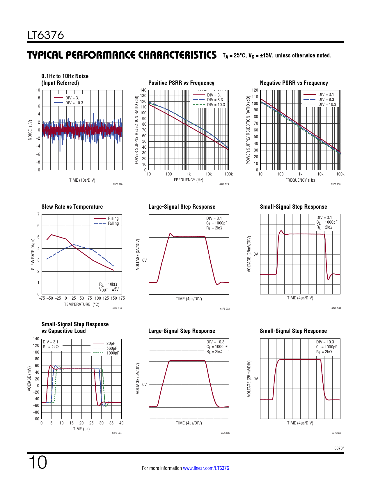

TYPICAL PERFORMANCE CHARACTERISTICS TA = 25°C, VS = ±15V, unless otherwise noted. 0.1Hz to 10Hz Noise. (Input Referred)
TYPICAL PERFORMANCE CHARACTERISTICS TA = 25°C, VS = ±15V, unless otherwise noted 0.1Hz to 10Hz Noise (Input Referred)
LT6376
TYPICAL PERFORMANCE CHARACTERISTICS TA = 25°C, VS = ±15V, unless otherwise noted. 0.1Hz to 10Hz Noise (Input Referred) Positive PSRR vs Frequency Negative PSRR vs Frequency
10 140 120 130 DIV = 3.1 DIV = 3.1 8 DIV = 3.1 110 DIV = 8.3 DIV = 8.3 DIV = 10.3 120 100 6 DIV = 10.3 DIV = 10.3 110 TIO (dB) TIO (dB) 90 4 100 90 80 V) 2 80 70 0 70 60 60 NOISE (µ –2 Y REJECTION RA Y REJECTION RA 50 50 40 –4 40 30 –6 30 20 20 –8 POWER SUPPL 10 POWER SUPPL 10 –10 0 0 10 100 1k 10k 100k 10 100 1k 10k 100k TIME (10s/DIV) FREQUENCY (Hz) FREQUENCY (Hz) 6376 G28 6376 G29 6376 G30
Slew Rate vs Temperature Large-Signal Step Response Small-Signal Step Response
7 Rising DIV = 3.1 DIV = 3.1 Falling C 6 CL = 1000pF L = 1000pF RL = 2kΩ RL = 2kΩ 5 /µs) /DIV) 4 /DIV) TE (V 0V 3 0V TAGE (5V TAGE (25mV SLEW RA VOL 2 VOL 1 RL = 10kΩ VOUT = ±5V 0–75 –50 –25 0 25 50 75 100 125 150 175 TIME (4µs/DIV) TIME (4µs/DIV) TEMPERATURE (°C) 6376 G31 6376 G32 6376 G33
Small-Signal Step Response vs Capacitive Load Large-Signal Step Response Small-Signal Step Response
140 DIV = 3.1 20pF DIV = 10.3 DIV = 10.3 120 RL = 2kΩ 560pF CL = 1000pF CL = 1000pF 100 1000pF RL = 2kΩ RL = 2kΩ 80 60 /DIV) 40 /DIV) 20 0V TAGE (mV) 0 0V TAGE (5V VOL TAGE (25mV –20 VOL VOL –40 –60 –80 –100 0 5 10 15 20 25 30 35 40 TIME (4µs/DIV) TIME (4µs/DIV) TIME (µs) 6376 G34 6376 G35 6376 G36 6376f 10 For more information www.linear.com/LT6376 Document Outline FEATURES DESCRIPTION APPLICATIONS TYPICAL APPLICATION ABSOLUTE MAXIMUM RATINGS PIN CONFIGURATION ORDER INFORMATION E LECTRICAL CHARACTERISTICS TYPICAL PERFORMANCE CHARACTERISTICS PIN FUNCTIONS BLOCK DIAGRAM APPLICATIONS INFORMATION TYPICAL APPLICATIONS PACKAGE DESCRIPTION TYPICAL APPLICATION RELATED PARTS
