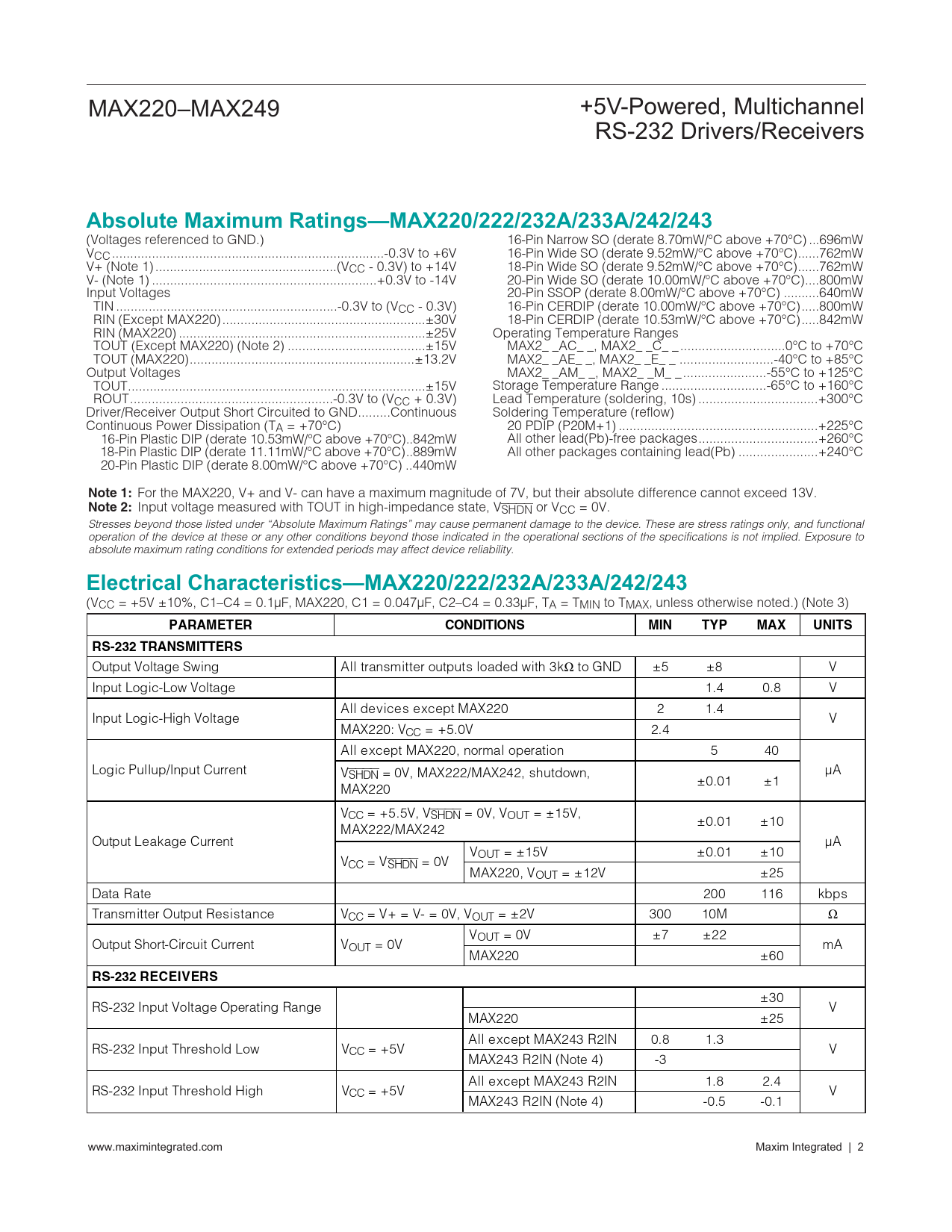

MAX220–MAX249 +5V-Powered, Multichannel RS-232 Drivers/Receivers
Absolute Maximum Ratings—MAX220/222/232A/233A/242/243
(Voltages referenced to GND.) 16-Pin Narrow SO (derate 8.70mW/°C above +70°C) ...696mW VCC ...-0.3V to +6V 16-Pin Wide SO (derate 9.52mW/°C above +70°C)..762mW V+ (Note 1) ..(VCC - 0.3V) to +14V 18-Pin Wide SO (derate 9.52mW/°C above +70°C)..762mW V- (Note 1) ..+0.3V to -14V 20-Pin Wide SO (derate 10.00mW/°C above +70°C)..800mW Input Voltages 20-Pin SSOP (derate 8.00mW/°C above +70°C) ..640mW TIN ...-0.3V to (VCC - 0.3V) 16-Pin CERDIP (derate 10.00mW/°C above +70°C)...800mW RIN (Except MAX220) ..±30V 18-Pin CERDIP (derate 10.53mW/°C above +70°C)...842mW RIN (MAX220) ..±25V Operating Temperature Ranges TOUT (Except MAX220) (Note 2) ..±15V MAX2_ _AC_ _, MAX2_ _C_ _ ...0°C to +70°C TOUT (MAX220)..±13.2V MAX2_ _AE_ _, MAX2_ _E_ _ ..-40°C to +85°C Output Voltages MAX2_ _AM_ _, MAX2_ _M_ _ ...-55°C to +125°C TOUT..±15V Storage Temperature Range ...-65°C to +160°C ROUT..-0.3V to (VCC + 0.3V) Lead Temperature (soldering, 10s) ...+300°C Driver/Receiver Output Short Circuited to GND...Continuous Soldering Temperature (reflow) Continuous Power Dissipation (TA = +70°C) 20 PDIP (P20M+1) ...+225°C 16-Pin Plastic DIP (derate 10.53mW/°C above +70°C)..842mW All other lead(Pb)-free packages...+260°C 18-Pin Plastic DIP (derate 11.11mW/°C above +70°C)..889mW All other packages containing lead(Pb) ..+240°C 20-Pin Plastic DIP (derate 8.00mW/°C above +70°C) ..440mW
Note 1:
For the MAX220, V+ and V- can have a maximum magnitude of 7V, but their absolute difference cannot exceed 13V.
Note 2:
Input voltage measured with TOUT in high-impedance state, VSHDN or VCC = 0V. Stresses beyond those listed under “Absolute Maximum Ratings” may cause permanent damage to the device. These are stress ratings only, and functional operation of the device at these or any other conditions beyond those indicated in the operational sections of the specifications is not implied. Exposure to absolute maximum rating conditions for extended periods may affect device reliability.
Electrical Characteristics—MAX220/222/232A/233A/242/243
(VCC = +5V ±10%, C1–C4 = 0.1µF‚ MAX220, C1 = 0.047µF, C2–C4 = 0.33µF, TA = TMIN to TMAX‚ unless otherwise noted.) (Note 3)
PARAMETER CONDITIONS MIN TYP MAX UNITS RS-232 TRANSMITTERS
Output Voltage Swing All transmitter outputs loaded with 3k to GND ±5 ±8 V Input Logic-Low Voltage 1.4 0.8 V All devices except MAX220 2 1.4 Input Logic-High Voltage V MAX220: VCC = +5.0V 2.4 All except MAX220, normal operation 5 40 Logic Pullup/lnput Current VSHDN = 0V, MAX222/MAX242, shutdown, μA ±0.01 ±1 MAX220 VCC = +5.5V, VSHDN = 0V, VOUT = ±15V, ±0.01 ±10 MAX222/MAX242 Output Leakage Current μA VOUT = ±15V ±0.01 ±10 VCC = VSHDN = 0V MAX220, VOUT = ±12V ±25 Data Rate 200 116 kbps Transmitter Output Resistance VCC = V+ = V- = 0V, VOUT = ±2V 300 10M VOUT = 0V ±7 ±22 Output Short-Circuit Current VOUT = 0V mA MAX220 ±60
RS-232 RECEIVERS
±30 RS-232 Input Voltage Operating Range V MAX220 ±25 All except MAX243 R2IN 0.8 1.3 RS-232 Input Threshold Low VCC = +5V V MAX243 R2IN (Note 4) -3 All except MAX243 R2IN 1.8 2.4 RS-232 Input Threshold High VCC = +5V V MAX243 R2IN (Note 4) -0.5 -0.1 www.maximintegrated.com Maxim Integrated | 2
