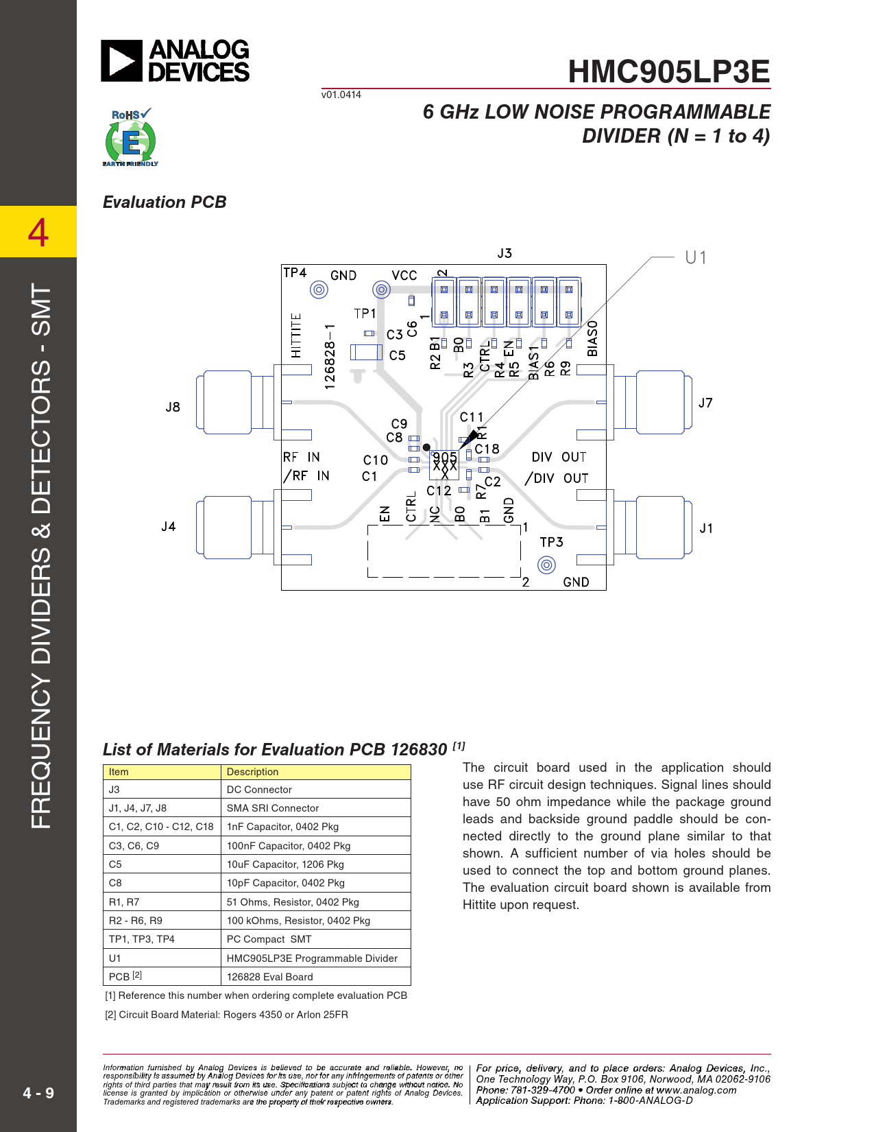

HMC905LP3E. 6 GHz LOW NOISE PROGRAMMABLE. DIVIDER (N = 1 to 4). Evaluation PCB. List of Materials for Evaluation PCB 126830 [1]
HMC905LP3E 6 GHz LOW NOISE PROGRAMMABLE DIVIDER (N = 1 to 4) Evaluation PCB List of Materials for Evaluation PCB 126830 [1]
HMC905LP3E
v01.0414
4 4 T T M M S - S S - S R R O O T T C C E E T T E E S & D S & D R R E E ID ID IV IV Y D Y D C C N N E E U
U Q Item Description The circuit board used in the application should Q E J3 DC Connector use RF circuit design techniques. Signal lines should E R have 50 ohm impedance while the package ground J1, J4, J7, J8 SMA SRI Connector R F leads and backside ground paddle should be con- C1, C2, C10 - C12, C18 1nF Capacitor, 0402 Pkg F nected directly to the ground plane similar to that C3, C6, C9 100nF Capacitor, 0402 Pkg shown. A sufficient number of via holes should be C5 10uF Capacitor, 1206 Pkg used to connect the top and bottom ground planes. C8 10pF Capacitor, 0402 Pkg The evaluation circuit board shown is available from R1, R7 51 Ohms, Resistor, 0402 Pkg Hittite upon request. R2 - R6, R9 100 kOhms, Resistor, 0402 Pkg TP1, TP3, TP4 PC Compact SMT U1 HMC905LP3E Programmable Divider PCB [2] 126828 Eval Board [1] Reference this number when ordering complete evaluation PCB [2] Circuit Board Material: Rogers 4350 or Arlon 25FR Info F rmoatr p ion rfiurcne is , d hed ebly ivAe n r al y a og D n evd t ice o p s is bla eli c eve o ed t rd o b e e ras: H ccuratite tiatne M d reli iac bl reo . w Ho av wev e C er, n o o For price, delivery, and to place orders: Analog Devices, Inc., responsibility is assumed by Analog Devices for its use, nor for any infringements of patents or other rporation, 20 Alpha Road, Chelmsford, MA 01824 One Technology Way, P.O. Box 9106, Norwood, MA 02062-9106 Phone: 978-250-3343 Fax: 978-250-3373 O rights of third parties that may result from its use. Specifications subject to change without notice. No P rd hone e r O : 7 n 81- -3li 2n 9 e a -47 t w 0 w 0 • O w rd .h e it r o t niltie n .c e ao t m
