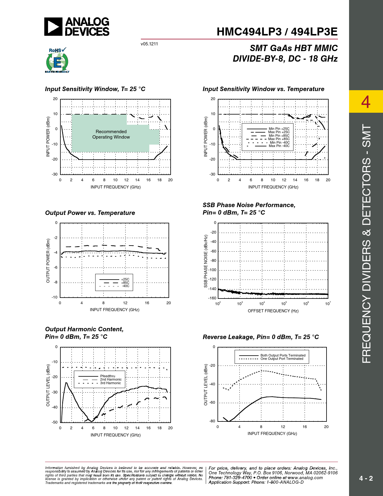

HMC494LP3 / 494LP3E. SMT GaAs HBT MMIC. DIVIDE-BY-8, DC - 18 GHz. Input Sensitivity Window, T= 25 °C
HMC494LP3 / 494LP3E SMT GaAs HBT MMIC DIVIDE-BY-8, DC - 18 GHz Input Sensitivity Window, T= 25 °C
HMC494LP3 / 494LP3E
v05.1211
SMT GaAs HBT MMIC DIVIDE-BY-8, DC - 18 GHz Input Sensitivity Window, T= 25 °C Input Sensitivity Window vs. Temperature
4 20 20 4 10 10 ) m m t dB dB ( 0 ( R 0 Min Pin +25C Recommended R t M E Max Pin +25C E W Operating Window Min Pin +85C W Max Pin +85C M s PO -10 Min Pin -40C PO T -10 T Max Pin -40C s U U P P s - IN IN -20 -20 s - r -30 -30 r o 0 2 4 6 8 10 12 14 16 18 20 0 2 4 6 8 10 12 14 16 18 20 o t INPUT FREQUENCY (GHz) INPUT FREQUENCY (GHz) t c c e e t
SSB Phase Noise Performance,
t e
Output Power vs. Temperature Pin= 0 dBm, T= 25 °C
e 0 0 -20 s & D -2 -40 (dBm) s & D r -4 -60 r e -80 e iD POWER -6 -100 iD iv +25C OUTPUT -120 -8 +85C iv -40C SSB PHASE NOISE (dBc/Hz) -140 y D -10 -160 0 4 8 12 16 20 y D c 102 103 104 105 106 107 INPUT FREQUENCY (GHz) OFFSET FREQUENCY (Hz) c n n e e u
Output Harmonic Content,
u q
Pin= 0 dBm, T= 25 °C Reverse Leakage, Pin= 0 dBm, T= 25 °C
q e 0 0 e r Both Output Ports Terminated r F One Output Port Terminated -10 F -20 (dBm) -20 Pfeedthru 2nd Harmonic 3rd Harmonic -40 LEVEL -30 -60 OUTPUT LEVEL (dBm) OUTPUT -40 -50 -80 0 2 4 6 8 10 12 14 16 18 20 0 4 8 12 16 20 INPUT FREQUENCY (GHz) INPUT FREQUENCY (GHz) Info F rmoatr p ion rfiurcne is , d hed ebly ivAe n r al y a og D n evd t ice o p s is bla eli c eve o ed t rd o b e e ras: H ccuratite tiatne M d reli iac bl reo . w Ho av wev e C er, n o o For price, delivery, and to place orders: Analog Devices, Inc., responsibility is assumed by Analog Devices for its use, nor for any infringements of patents or other rporation, 20 Alpha Road, Chelmsford, MA 01824 One Technology Way, P.O. Box 9106, Norwood, MA 02062-9106 Phone: 978-250-3343 Fax: 978-250-3373 O rights of third parties that may result from its use. Specifications subject to change without notice. No P rd ho e ne r O : 7 n 81- -3li 2n 9 e a -47 t w 0 w 0 • O w rd .h e it r o tniltie n .c e ao t m license is granted by implication or otherwise under any patent or patent rights of Analog Devices. www.analog.com
