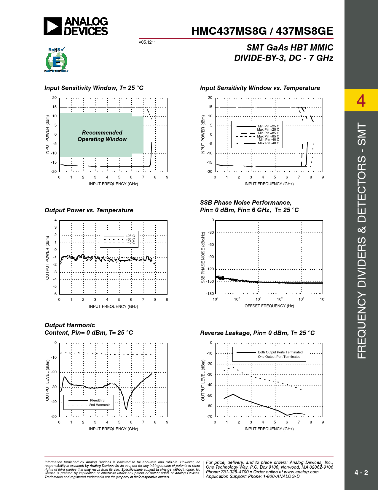

DescriptionSMT 4 SMT GaAs HBT MMIC DIVIDE-BY-3, DC - 7 GHz
Pages / Page6 / 2 — HMC437MS8G / 437MS8GE. SMT GaAs HBT MMIC. DIVIDE-BY-3, DC - 7 GHz. Input …

HMC437MS8G / 437MS8GE. SMT GaAs HBT MMIC. DIVIDE-BY-3, DC - 7 GHz. Input Sensitivity Window, T= 25 °C
HMC437MS8G / 437MS8GE SMT GaAs HBT MMIC DIVIDE-BY-3, DC - 7 GHz Input Sensitivity Window, T= 25 °C
v05.1211
SMT GaAs HBT MMIC DIVIDE-BY-3, DC - 7 GHz Input Sensitivity Window, T= 25 °C Input Sensitivity Window vs. Temperature
4 20 20 15 15 4 ) 10 ) m 10 m t dB dB ( 5 ( 5 R Min Pin +25 C R Max Pin +25 C t M WE 0
Recommended
WE 0 Min Pin +85 C Max Pin +85 C Min Pin -40 C M s
Operating Window
PO PO T -5 T -5 Max Pin -40 C U U s P P s - -10 IN -10 IN -15 -15 s - r -20 -20 r o 0 1 2 3 4 5 6 7 8 9 0 1 2 3 4 5 6 7 8 9 o t INPUT FREQUENCY (GHz) INPUT FREQUENCY (GHz) t c c e e t
SSB Phase Noise Performance,
t e
Output Power vs. Temperature Pin= 0 dBm, Fin= 6 GHz, T= 25 °C
e 4 0 3 -30 s & D 2 +25 C +85 C 1 -40 C -60 s & D r (dBc/Hz) 0 r e -1 -90 NOISE e iD -2 -120 iD iv -3 PHASE OUTPUT POWER (dBm) -4 iv SSB -150 -5 y D -6 -180 0 1 2 3 4 5 6 7 8 9 102 103 104 105 106 107 y D c INPUT FREQUENCY (GHz) OFFSET FREQUENCY (Hz) c n n e e u
Output Harmonic
u q
Content, Pin= 0 dBm, T= 25 °C Reverse Leakage, Pin= 0 dBm, T= 25 °C
q e 0 0 e r -10 Both Output Ports Terminated r F -10 One Output Port Terminated F -20 -20 -30 -40 -30 -50 OUTPUT LEVEL (dBm) Pfeedthru OUTPUT LEVEL (dBm) -40 2nd Harmonic -60 -50 -70 0 1 2 3 4 5 6 7 8 9 0 1 2 3 4 5 6 7 8 9 INPUT FREQUENCY (GHz) INPUT FREQUENCY (GHz) Info F rmoatr p ion rfiurcne is , d hed ebly ivAe n r al y a og D n evd t ice o p s is bla eli c eve o ed t rd o b e e ras: H ccuratite tiatne M d reli iac bl reo . w Ho av wev e C er, n o o For price, delivery, and to place orders: Analog Devices, Inc., responsibility is assumed by Analog Devices for its use, nor for any infringements of patents or other rporation, 20 Alpha Road, Chelmsford, MA 01824 One Technology Way, P.O. Box 9106, Norwood, MA 02062-9106 Phone: 978-250-3343 Fax: 978-250-3373 O rights of third parties that may result from its use. Specifications subject to change without notice. No P rd ho e ne r O : 7 n 81- -3li 2n 9 e a -47 t w 0 w 0 • O w rd .h e it r o tniltie n .c e ao t m license is granted by implication or otherwise under any patent or patent rights of Analog Devices. www.analog.com
