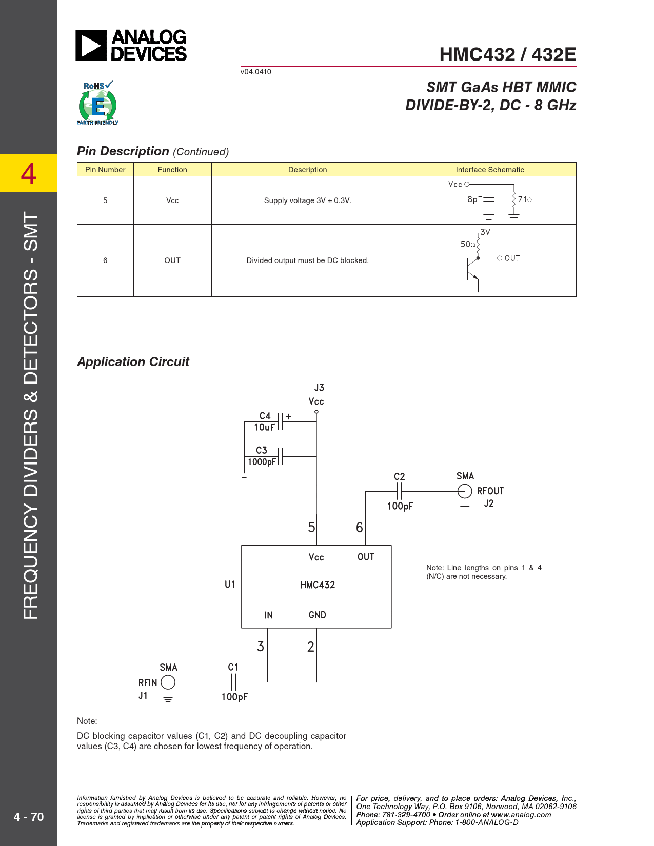

HMC432 / 432E. SMT GaAs HBT MMIC. DIVIDE-BY-2, DC - 8 GHz. Pin Description. Application Circuit. 4 - 70
HMC432 / 432E SMT GaAs HBT MMIC DIVIDE-BY-2, DC - 8 GHz Pin Description Application Circuit 4 - 70
HMC432 / 432E
v04.0410
(Continued) 4 Pin Number Function Description Interface Schematic 5 Vcc Supply voltage 3V ± 0.3V. T 6 OUT Divided output must be DC blocked. S - SM R O T C E T E
Application Circuit
& D S R E ID IV Y D NC E U Note: Line lengths on pins 1 & 4 Q (N/C) are not necessary. E R F Note: DC blocking capacitor values (C1, C2) and DC decoupling capacitor values (C3, C4) are chosen for lowest frequency of operation. Info F rmoatr pr ion f iurcne, de ished b ly iv A e n r al y o a g D n evd to p ices is bla eli c eve o ed t rde o be ras: H ccuratite tiatne M d reli iacr ble ow . Ho av wev e C er, n o o rpo Fora r t p iro ic n e ,, 2 d 0 eli A ve lrpha R y, and toad, C o place hoel rd m er s s fo : Ard, MA 01 nalog Devic 8 e 2 s 4 , Inc., responsibility is assumed by Analog Devices for its use, nor for any infringements of patents or other One Technology Way, P.O. Box 9106, Norwood, MA 02062-9106 Phone: 978-250-3343 Fax: 978-250-3373 O rights of third parties that may result from its use. Specifications subject to change without notice. No P rde hone r O : 7 n 81- -3li 2n 9 e a -47 t w 0 w 0 • O w rd .ehit r o t nilte in .c e ao t m
