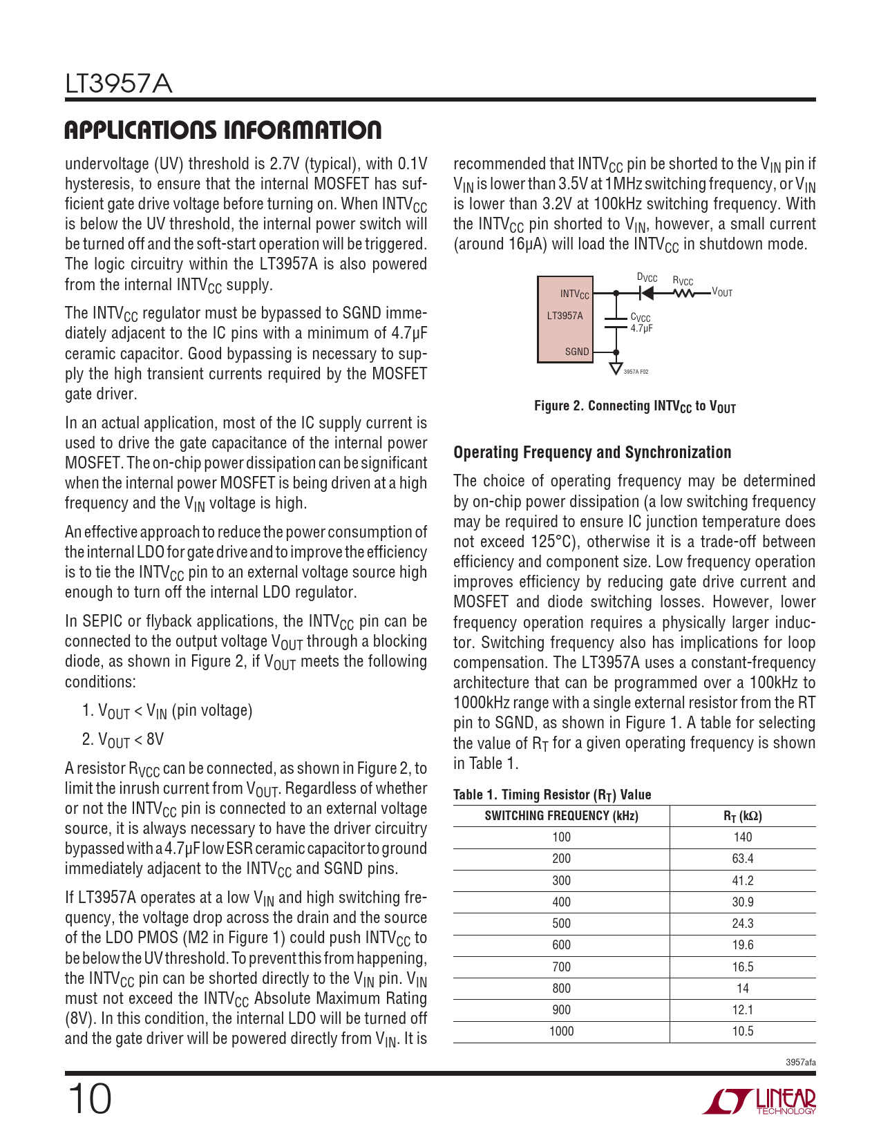

undervoltage (UV) threshold is 2.7V (typical), with 0.1V recommended that INTVCC pin be shorted to the VIN pin if hysteresis, to ensure that the internal MOSFET has suf- VIN is lower than 3.5V at 1MHz switching frequency, or VIN ficient gate drive voltage before turning on. When INTVCC is lower than 3.2V at 100kHz switching frequency. With is below the UV threshold, the internal power switch will the INTVCC pin shorted to VIN, however, a small current be turned off and the soft-start operation will be triggered. (around 16μA) will load the INTVCC in shutdown mode. The logic circuitry within the LT3957A is also powered D from the internal INTV VCC RVCC CC supply. V INTV OUT CC The INTVCC regulator must be bypassed to SGND imme- LT3957A CVCC diately adjacent to the IC pins with a minimum of 4.7μF 4.7μF ceramic capacitor. Good bypassing is necessary to sup- SGND ply the high transient currents required by the MOSFET 3957A F02 gate driver.
Figure 2. Connecting INTVCC to VOUT
