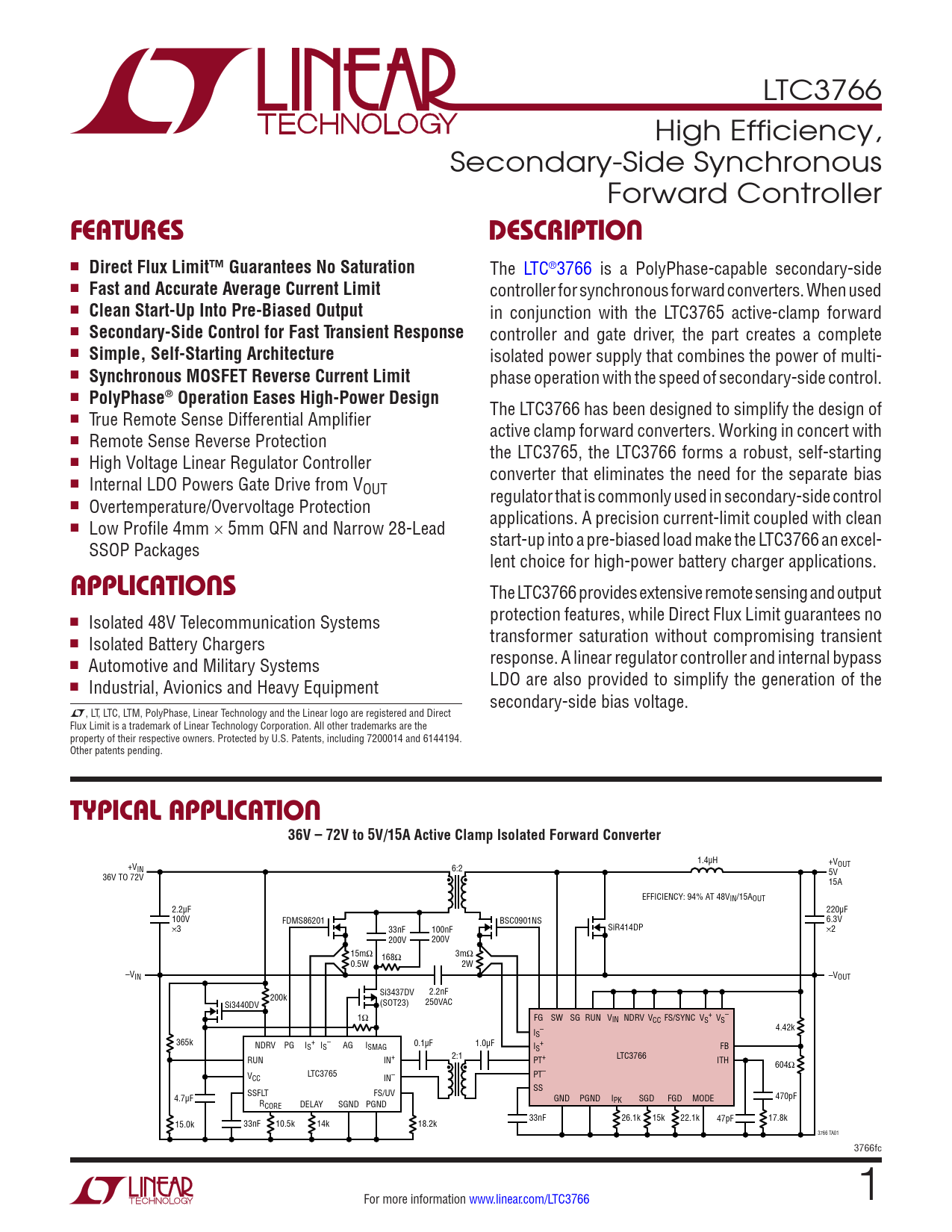

TYPICAL APPLICATION 36V – 72V to 5V/15A Active Clamp Isolated Forward Converter
1.4µH +V +VOUT IN 6:2 36V TO 72V 5V • • 15A EFFICIENCY: 94% AT 48VIN/15AOUT 2.2µF 220µF 100V FDMS86201 BSC0901NS 6.3V SiR414DP ×3 33nF 100nF ×2 200V 200V 15mΩ 3mΩ 168Ω 0.5W 2W –VIN –VOUT Si3437DV 2.2nF 200k (SOT23) Si3440DV 250VAC 1Ω FG SW SG RUN V + – IN NDRV VCC FS/SYNC VS VS I – 4.42k S 365k NDRV PG I + I – AG I 0.1µF S S SMAG 1.0µF I + S FB RUN IN+ 2:1 PT+ LTC3766 ITH 604Ω • • V LTC3765 PT– CC IN– SS SSFLT FS/UV 4.7µF GND PGND I 470pF PK SGD FGD MODE RCORE DELAY SGND PGND 33nF 26.1k 15k 22.1k 47pF 17.8k 15.0k 33nF 10.5k 14k 18.2k 3766 TA01 3766fc For more information www.linear.com/LTC3766 1 Document Outline Features Applications Description Typical Application Absolute Maximum Ratings Pin Configuration Order Information Electrical Characteristics Typical Performance Characteristics Pin Functions Block Diagram Timing Diagram Operation Applications Information Typical Applications Package Description Typical Application Related Parts Features Applications Typical Application Description Absolute Maximum Ratings Pin Configuration Order Information Electrical Characteristics Typical Performance Characteristics Pin Functions Block Diagram Timing Diagram Operation Applications Information Typical Applications Typical Applications Typical Applications Package Description Revision History Typical Application Related Parts
