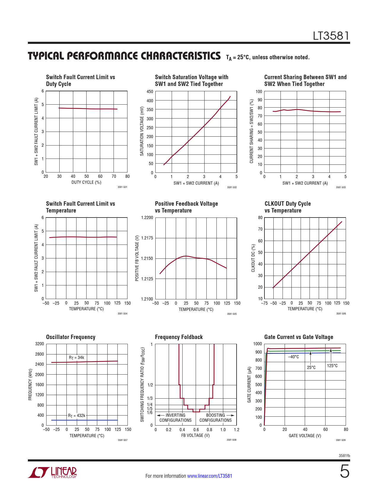

TYPICAL PERFORMANCE CHARACTERISTICS TA = 25°C, unless otherwise noted. Switch Fault Current Limit vs
TYPICAL PERFORMANCE CHARACTERISTICS TA = 25°C, unless otherwise noted Switch Fault Current Limit vs
LT3581
TYPICAL PERFORMANCE CHARACTERISTICS TA = 25°C, unless otherwise noted. Switch Fault Current Limit vs Switch Saturation Voltage with Current Sharing Between SW1 and Duty Cycle SW1 and SW2 Tied Together SW2 When Tied Together
6 450 100 400 90 5 350 80 4 70 300 TAGE (mV) 60 250 T CURRENT LIMIT (A) 3 50 200 AUL TION VOL 40 2 150 TURA 30 + SW2 F SA 100 1 20 SW1 50 CURRENT SHARING = SW2/SW1 (%) 10 0 0 0 20 30 40 50 60 70 80 0 1 2 3 4 5 0 1 2 3 4 5 DUTY CYCLE (%) SW1 + SW2 CURRENT (A) SW1 + SW2 CURRENT (A) 3581 G01 3581 G02 3581 G03
Switch Fault Current Limit vs Positive Feedback Voltage CLKOUT Duty Cycle Temperature vs Temperature vs Temperature
6 1.2200 80 5 70 1.2175 60 4 50 T CURRENT LIMIT (A) 3 1.2150 40 AUL 2 CLKOUT DC (%) 30 + SW2 F POSITIVE FB VOLTAGE (V) 1.2125 1 20 SW1 0 1.2100 10 –50 –25 0 25 50 75 100 125 150 –50 –25 0 25 50 75 100 125 150 –75 –50 –25 0 25 50 75 100 125 150 TEMPERATURE (°C) TEMPERATURE (°C) TEMPERATURE (°C) 3581 G04 3581 G05 3581 G06
