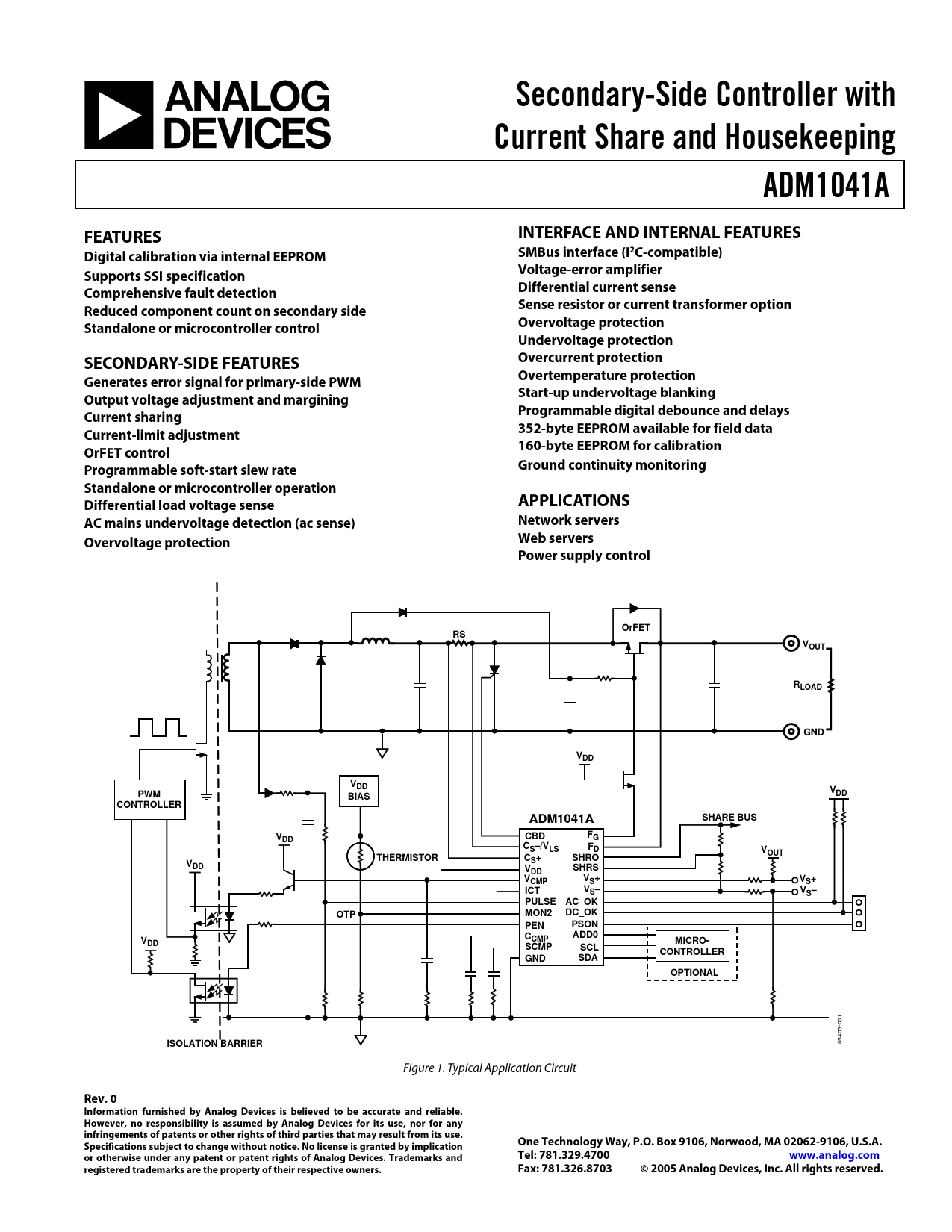

DescriptionSecondary-Side Controller with Current Share and Housekeeping
Pages / Page56 / 1 — Secondary-Side Controller with. Current Share and Housekeeping. ADM1041A. …
Secondary-Side Controller with. Current Share and Housekeeping. ADM1041A. FEATURES. INTERFACE AND INTERNAL FEATURES
Datasheet ADM1041A Analog Devices
Secondary-Side Controller with Current Share and Housekeeping ADM1041A FEATURES INTERFACE AND INTERNAL FEATURES Digital calibration via internal EEPROM SMBus interface (I2C-compatible) Supports SSI specification Voltage-error amplifier Comprehensive fault detection Differential current sense Reduced component count on secondary side Sense resistor or current transformer option Standalone or microcontroller control Overvoltage protection Undervoltage protection SECONDARY-SIDE FEATURES Overcurrent protection Overtemperature protection Generates error signal for primary-side PWM Start-up undervoltage blanking Output voltage adjustment and margining Programmable digital debounce and delays Current sharing 352-byte EEPROM available for field data Current-limit adjustment 160-byte EEPROM for calibration OrFET control Programmable soft-start slew rate Ground continuity monitoring Standalone or microcontroller operation Differential load voltage sense APPLICATIONS AC mains undervoltage detection (ac sense) Network servers Overvoltage protection Web servers Power supply control OrFET RS VOUT RLOAD GND VDD VDD PWM V BIAS DD CONTROLLER SHARE BUS ADM1041A V CBD F DD G CS–/VLS FD VOUT THERMISTOR C SHRO V S+ DD V SHRS DD V V V CMP S+ S+ ICT VS– VS– PULSE AC_OK OTP MON2 DC_OK PEN PSON CCMP ADD0 V MICRO- DD SCMP SCL CONTROLLER GND SDA OPTIONAL ISOLATION BARRIER
05405-001 Figure 1. Typical Application Circuit
