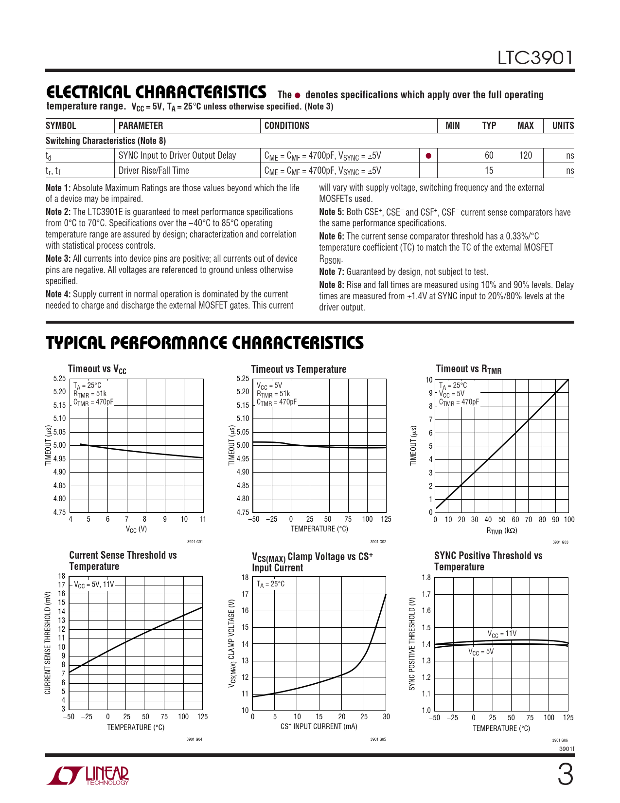

ELECTRICAL CHARACTERISTICS The. denotes specifications which apply over the full operating
ELECTRICAL CHARACTERISTICS The denotes specifications which apply over the full operating
LTC3901
denotes specifications which apply over the full operating temperature range. VCC = 5V, TA = 25
C unless otherwise specified. (Note 3) SYMBOL PARAMETER CONDITIONS MIN TYP MAX UNITS Switching Characteristics (Note 8)
td SYNC Input to Driver Output Delay CME = CMF = 4700pF, VSYNC = ±5V ● 60 120 ns tr, tf Driver Rise/Fall Time CME = CMF = 4700pF, VSYNC = ±5V 15 ns

W U TYPICAL PERFOR A CE CHARACTERISTICS Timeout vs VCC Timeout vs Temperature Timeout vs RTMR
5.25 5.25 10 TA = 25°C V T CC = 5V A = 25°C 5.20 5.20 R R 9 TMR = 51k V TMR = 51k CC = 5V C C C 5.15 TMR = 470pF 5.15 TMR = 470pF 8 TMR = 470pF 5.10 5.10 7 s) s) s) µ 5.05 µ 5.05 µ 6 5.00 5.00 5 4.95 4.95 4 TIMEOUT ( TIMEOUT ( TIMEOUT ( 4.90 4.90 3 4.85 4.85 2 4.80 4.80 1 4.75 4.75 0 4 5 6 7 8 9 10 11 –50 –25 0 25 50 75 100 125 0 10 20 30 40 50 60 70 80 90 100 VCC (V) TEMPERATURE (°C) RTMR (kΩ) 3901 G01 3901 G02 3901 G03
Current Sense Threshold vs VCS(MAX) Clamp Voltage vs CS+ SYNC Positive Threshold vs Temperature Input Current Temperature
18 18 1.8 17 VCC = 5V, 11V TA = 25°C 16 17 1.7 15 14 16 1.6 13 12 15 1.5 V 11 CC = 11V 10 14 1.4 V 9 CC = 5V CLAMP VOLTAGE (V) 13 1.3 8 7 12 1.2 6 CS(MAX)V SYNC POSITIVE THRESHOLD (V) CURRENT SENSE THRESHOLD (mV) 5 11 1.1 4 3 10 1.0 –50 –25 0 25 50 75 100 125 0 5 10 15 20 25 30 –50 –25 0 25 50 75 100 125 TEMPERATURE ( CS+ INPUT CURRENT (mA) °C) TEMPERATURE (°C) 3901 G04 3901 G05 3901 G06 3901f 3
