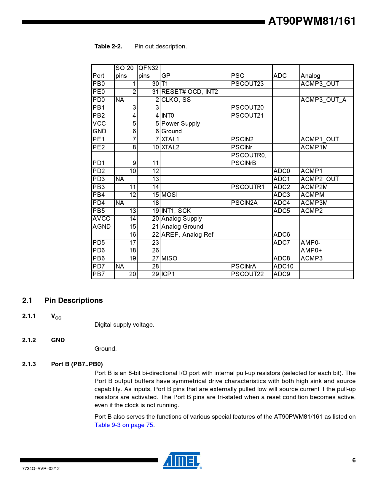

AT90PWM81/161 Table 2-2.
Pin out description. SO 20 QFN32 Port pins pins GP PSC ADC Analog PB0 1 30 T1 PSCOUT23 ACMP3_OUT PE0 2 31 RESET# OCD, INT2 PD0 NA 2 CLKO, SS ACMP3_OUT_A PB1 3 3 PSCOUT20 PB2 4 4 INT0 PSCOUT21 VCC 5 5 Power Supply GND 6 6 Ground PE1 7 7 XTAL1 PSCIN2 ACMP1_OUT PE2 8 10 XTAL2 PSCINr ACMP1M PSCOUTR0, PD1 9 11 PSCINrB PD2 10 12 ADC0 ACMP1 PD3 NA 13 ADC1 ACMP2_OUT PB3 11 14 PSCOUTR1 ADC2 ACMP2M PB4 12 15 MOSI ADC3 ACMPM PD4 NA 18 PSCIN2A ADC4 ACMP3M PB5 13 19 INT1, SCK ADC5 ACMP2 AVCC 14 20 Analog Supply AGND 15 21 Analog Ground 16 22 AREF, Analog Ref ADC6 PD5 17 23 ADC7 AMP0- PD6 18 26 AMP0+ PB6 19 27 MISO ADC8 ACMP3 PD7 NA 28 PSCINrA ADC10 PB7 20 29 ICP1 PSCOUT22 ADC9
2.1 Pin Descriptions 2.1.1 VCC
Digital supply voltage.
2.1.2 GND
Ground.
2.1.3 Port B (PB7..PB0)
Port B is an 8-bit bi-directional I/O port with internal pull-up resistors (selected for each bit). The Port B output buffers have symmetrical drive characteristics with both high sink and source capability. As inputs, Port B pins that are externally pulled low will source current if the pull-up resistors are activated. The Port B pins are tri-stated when a reset condition becomes active, even if the clock is not running. Port B also serves the functions of various special features of the AT90PWM81/161 as listed on Table 9-3 on page 75.
