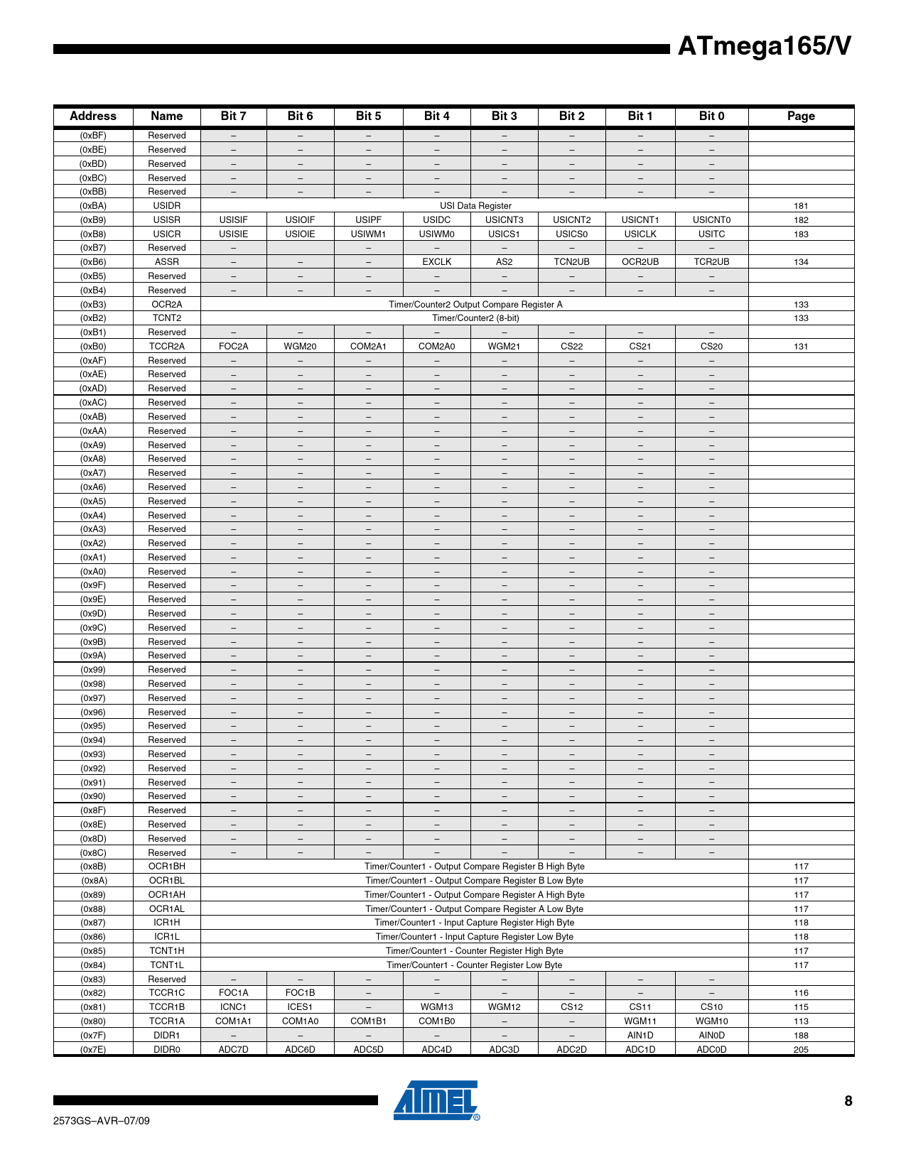

ATmega165/V. Address. Name. Bit 7. Bit 6. Bit 5. Bit 4. Bit 3. Bit 2. Bit 1. Bit 0. Page
ATmega165/V Address Name Bit 7 Bit 6 Bit 5 Bit 4 Bit 3 Bit 2 Bit 1 Bit 0 Page
(0xBF) Reserved – – – – – – – – (0xBE) Reserved – – – – – – – – (0xBD) Reserved – – – – – – – – (0xBC) Reserved – – – – – – – – (0xBB) Reserved – – – – – – – – (0xBA) USIDR USI Data Register 181 (0xB9) USISR USISIF USIOIF USIPF USIDC USICNT3 USICNT2 USICNT1 USICNT0 182 (0xB8) USICR USISIE USIOIE USIWM1 USIWM0 USICS1 USICS0 USICLK USITC 183 (0xB7) Reserved – – – – – – – (0xB6) ASSR – – – EXCLK AS2 TCN2UB OCR2UB TCR2UB 134 (0xB5) Reserved – – – – – – – – (0xB4) Reserved – – – – – – – – (0xB3) OCR2A Timer/Counter2 Output Compare Register A 133 (0xB2) TCNT2 Timer/Counter2 (8-bit) 133 (0xB1) Reserved – – – – – – – – (0xB0) TCCR2A FOC2A WGM20 COM2A1 COM2A0 WGM21 CS22 CS21 CS20 131 (0xAF) Reserved – – – – – – – – (0xAE) Reserved – – – – – – – – (0xAD) Reserved – – – – – – – – (0xAC) Reserved – – – – – – – – (0xAB) Reserved – – – – – – – – (0xAA) Reserved – – – – – – – – (0xA9) Reserved – – – – – – – – (0xA8) Reserved – – – – – – – – (0xA7) Reserved – – – – – – – – (0xA6) Reserved – – – – – – – – (0xA5) Reserved – – – – – – – – (0xA4) Reserved – – – – – – – – (0xA3) Reserved – – – – – – – – (0xA2) Reserved – – – – – – – – (0xA1) Reserved – – – – – – – – (0xA0) Reserved – – – – – – – – (0x9F) Reserved – – – – – – – – (0x9E) Reserved – – – – – – – – (0x9D) Reserved – – – – – – – – (0x9C) Reserved – – – – – – – – (0x9B) Reserved – – – – – – – – (0x9A) Reserved – – – – – – – – (0x99) Reserved – – – – – – – – (0x98) Reserved – – – – – – – – (0x97) Reserved – – – – – – – – (0x96) Reserved – – – – – – – – (0x95) Reserved – – – – – – – – (0x94) Reserved – – – – – – – – (0x93) Reserved – – – – – – – – (0x92) Reserved – – – – – – – – (0x91) Reserved – – – – – – – – (0x90) Reserved – – – – – – – – (0x8F) Reserved – – – – – – – – (0x8E) Reserved – – – – – – – – (0x8D) Reserved – – – – – – – – (0x8C) Reserved – – – – – – – – (0x8B) OCR1BH Timer/Counter1 - Output Compare Register B High Byte 117 (0x8A) OCR1BL Timer/Counter1 - Output Compare Register B Low Byte 117 (0x89) OCR1AH Timer/Counter1 - Output Compare Register A High Byte 117 (0x88) OCR1AL Timer/Counter1 - Output Compare Register A Low Byte 117 (0x87) ICR1H Timer/Counter1 - Input Capture Register High Byte 118 (0x86) ICR1L Timer/Counter1 - Input Capture Register Low Byte 118 (0x85) TCNT1H Timer/Counter1 - Counter Register High Byte 117 (0x84) TCNT1L Timer/Counter1 - Counter Register Low Byte 117 (0x83) Reserved – – – – – – – – (0x82) TCCR1C FOC1A FOC1B – – – – – – 116 (0x81) TCCR1B ICNC1 ICES1 – WGM13 WGM12 CS12 CS11 CS10 115 (0x80) TCCR1A COM1A1 COM1A0 COM1B1 COM1B0 – – WGM11 WGM10 113 (0x7F) DIDR1 – – – – – – AIN1D AIN0D 188 (0x7E) DIDR0 ADC7D ADC6D ADC5D ADC4D ADC3D ADC2D ADC1D ADC0D 205
8
