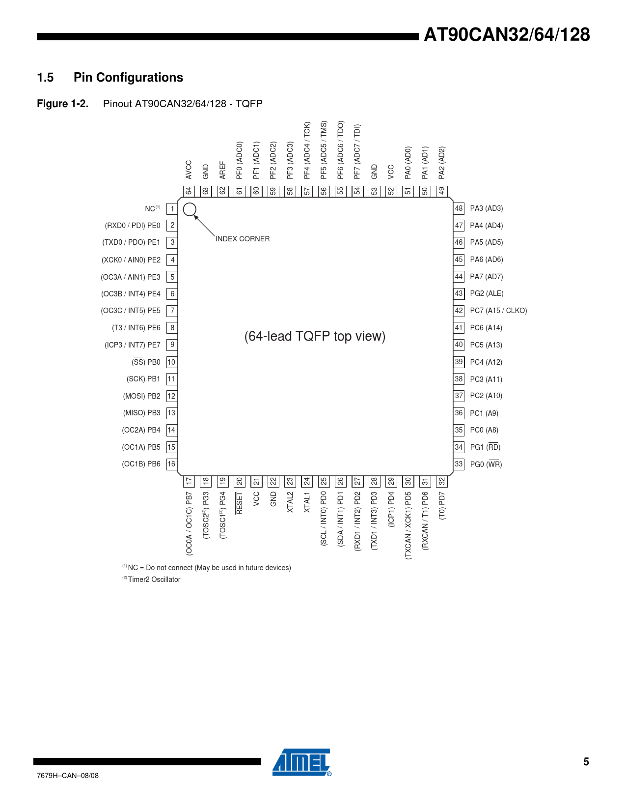

AT90CAN32/64/128. 1.5. Pin Configurations. Figure 1-2
AT90CAN32/64/128 1.5 Pin Configurations Figure 1-2
AT90CAN32/64/128 1.5 Pin Configurations Figure 1-2.
Pinout AT90CAN32/64/128 - TQFP AVCC GND AREF PF0 (ADC0) PF1 (ADC1) PF2 (ADC2) PF3 (ADC3) PF4 (ADC4 / TCK) PF5 (ADC5 / TMS) PF6 (ADC6 / TDO) PF7 (ADC7 / TDI) GND VCC PA0 (AD0) PA1 (AD1) PA2 (AD2) 64 63 62 61 60 59 58 57 56 55 54 53 52 51 50 49 NC(1) 1 48 PA3 (AD3) (RXD0 / PDI) PE0 2 47 PA4 (AD4) INDEX CORNER (TXD0 / PDO) PE1 3 46 PA5 (AD5) (XCK0 / AIN0) PE2 4 45 PA6 (AD6) (OC3A / AIN1) PE3 5 44 PA7 (AD7) (OC3B / INT4) PE4 6 43 PG2 (ALE) (OC3C / INT5) PE5 7 42 PC7 (A15 / CLKO) (T3 / INT6) PE6 8 41 PC6 (A14) (64-lead TQFP top view) (ICP3 / INT7) PE7 9 40 PC5 (A13) (SS) PB0 10 39 PC4 (A12) (SCK) PB1 11 38 PC3 (A11) (MOSI) PB2 12 37 PC2 (A10) (MISO) PB3 13 36 PC1 (A9) (OC2A) PB4 14 35 PC0 (A8) (OC1A) PB5 15 34 PG1 (RD) (OC1B) PB6 16 33 PG0 (WR) 17 18 19 20 21 22 23 24 25 26 27 28 29 30 31 32 VCC GND (2) (2) XTAL2 XTAL1 RESET (T0) PD7 (ICP1) PD4 (TOSC2 ) PG3 (TOSC1 ) PG4 (SCL / INT0) PD0 (SDA / INT1) PD1 (RXD1 / INT2) PD2 (TXD1 / INT3) PD3 (RXCAN / T1) PD6 (OC0A / OC1C) PB7 (TXCAN / XCK1) PD5 NC = Do not connect (May be used in future devices) (1) Timer2 Oscillator (2)
5
