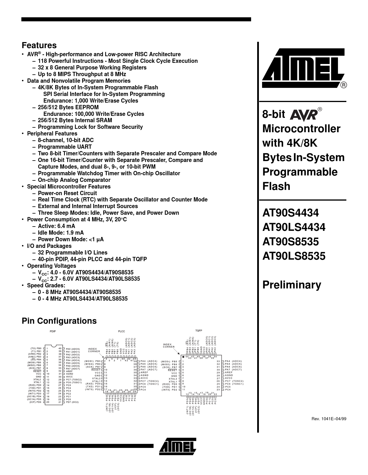

Features. AVR® - High-performance and Low-power RISC Architecture
Datasheet AT90S4434, AT90LS4434, AT90S8535, AT90LS8535 - Preliminary Atmel
Features
AVR® - High-performance and Low-power RISC Architecture – 118 Powerful Instructions - Most Single Clock Cycle Execution – 32 x 8 General Purpose Working Registers – Up to 8 MIPS Throughput at 8 MHz
Data and Nonvolatile Program Memories – 4K/8K Bytes of In-System Programmable Flash SPI Serial Interface for In-System Programming Endurance: 1,000 Write/Erase Cycles – 256/512 Bytes EEPROM Endurance: 100,000 Write/Erase Cycles 8-bit – 256/512 Bytes Internal SRAM – Programming Lock for Software Security Microcontroller
Peripheral Features – 8-channel, 10-bit ADC with 4K/8K – Programmable UART – Two 8-bit Timer/Counters with Separate Prescaler and Compare Mode – One 16-bit Timer/Counter with Separate Prescaler, Compare and Bytes In-System Capture Modes, and dual 8-, 9-, or 10-bit PWM – Programmable Watchdog Timer with On-chip Oscillator Programmable – On-chip Analog Comparator
Special Microcontroller Features Flash – Power-on Reset Circuit – Real Time Clock (RTC) with Separate Oscillator and Counter Mode – External and Internal Interrupt Sources – Three Sleep Modes: Idle, Power Save, and Power Down AT90S4434
Power Consumption at 4 MHz, 3V, 20
C – Active: 6.4 mA AT90LS4434 – Idle Mode: 1.9 mA – Power Down Mode: <1 µA AT90S8535
I/O and Packages – 32 Programmable I/O Lines AT90LS8535 – 40-pin PDIP, 44-pin PLCC and 44-pin TQFP
Operating Voltages – VCC: 4.0 - 6.0V AT90S4434/AT90S8535 – V : 2.7 - 6.0V AT90LS4434/AT90LS8535 CC
Speed Grades: Preliminary – 0 - 8 MHz AT90S4434/AT90S8535 – 0 - 4 MHz AT90LS4434/AT90LS8535 Pin Configurations
Rev. 1041E–04/99
1
