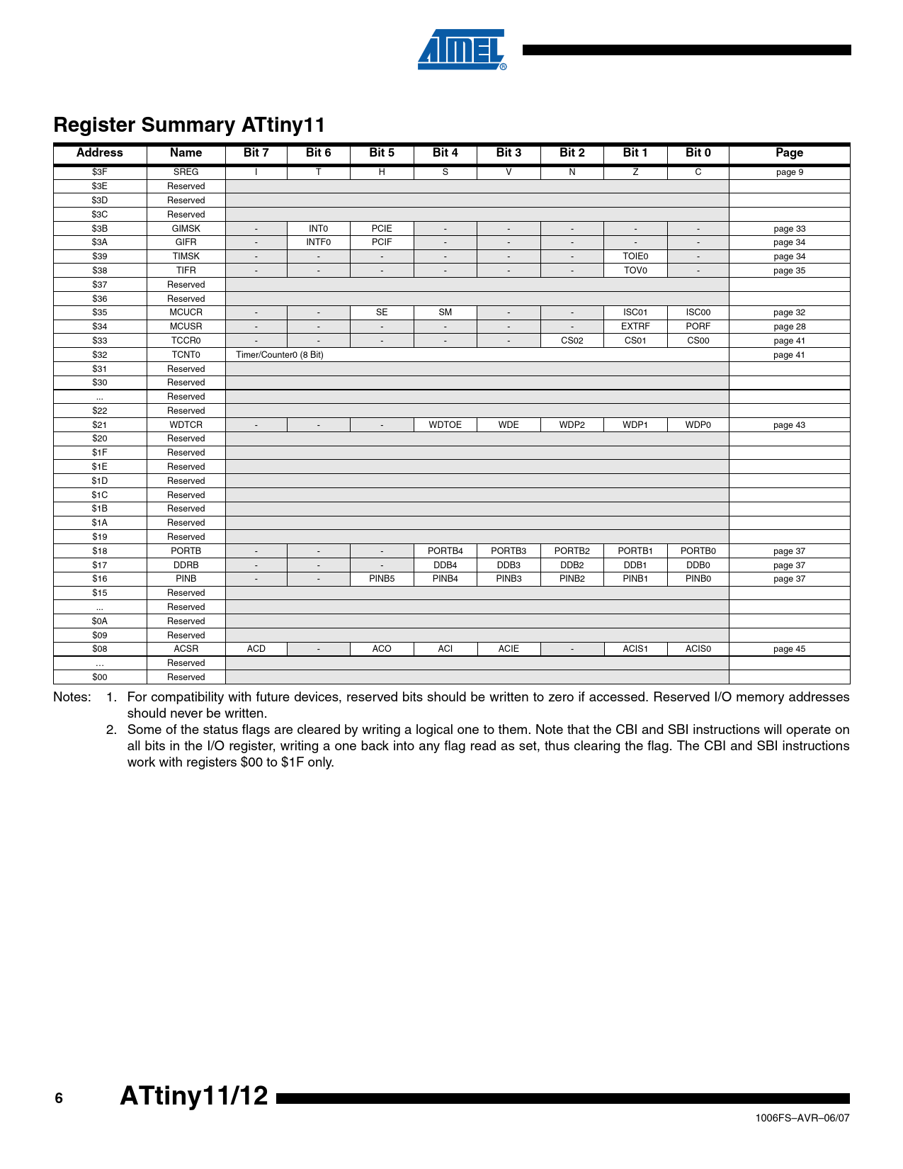

Register Summary ATtiny11. Address. Name. Bit 7. Bit 6. Bit 5. Bit 4. Bit 3. Bit 2. Bit 1. Bit 0. Page. ATtiny11/12
Register Summary ATtiny11 Address Name Bit 7 Bit 6 Bit 5 Bit 4 Bit 3 Bit 2 Bit 1 Bit 0 Page ATtiny11/12
$3F SREG I T H S V N Z C page 9 $3E Reserved $3D Reserved $3C Reserved $3B GIMSK - INT0 PCIE - - - - - page 33 $3A GIFR - INTF0 PCIF - - - - - page 34 $39 TIMSK - - - - - - TOIE0 - page 34 $38 TIFR - - - - - - TOV0 - page 35 $37 Reserved $36 Reserved $35 MCUCR - - SE SM - - ISC01 ISC00 page 32 $34 MCUSR - - - - - - EXTRF PORF page 28 $33 TCCR0 - - - - - CS02 CS01 CS00 page 41 $32 TCNT0 Timer/Counter0 (8 Bit) page 41 $31 Reserved $30 Reserved ... Reserved $22 Reserved $21 WDTCR - - - WDTOE WDE WDP2 WDP1 WDP0 page 43 $20 Reserved $1F Reserved $1E Reserved $1D Reserved $1C Reserved $1B Reserved $1A Reserved $19 Reserved $18 PORTB - - - PORTB4 PORTB3 PORTB2 PORTB1 PORTB0 page 37 $17 DDRB - - - DDB4 DDB3 DDB2 DDB1 DDB0 page 37 $16 PINB - - PINB5 PINB4 PINB3 PINB2 PINB1 PINB0 page 37 $15 Reserved ... Reserved $0A Reserved $09 Reserved $08 ACSR ACD - ACO ACI ACIE - ACIS1 ACIS0 page 45 … Reserved $00 Reserved Notes: 1. For compatibility with future devices, reserved bits should be written to zero if accessed. Reserved I/O memory addresses should never be written. 2. Some of the status flags are cleared by writing a logical one to them. Note that the CBI and SBI instructions will operate on all bits in the I/O register, writing a one back into any flag read as set, thus clearing the flag. The CBI and SBI instructions work with registers $00 to $1F only.
