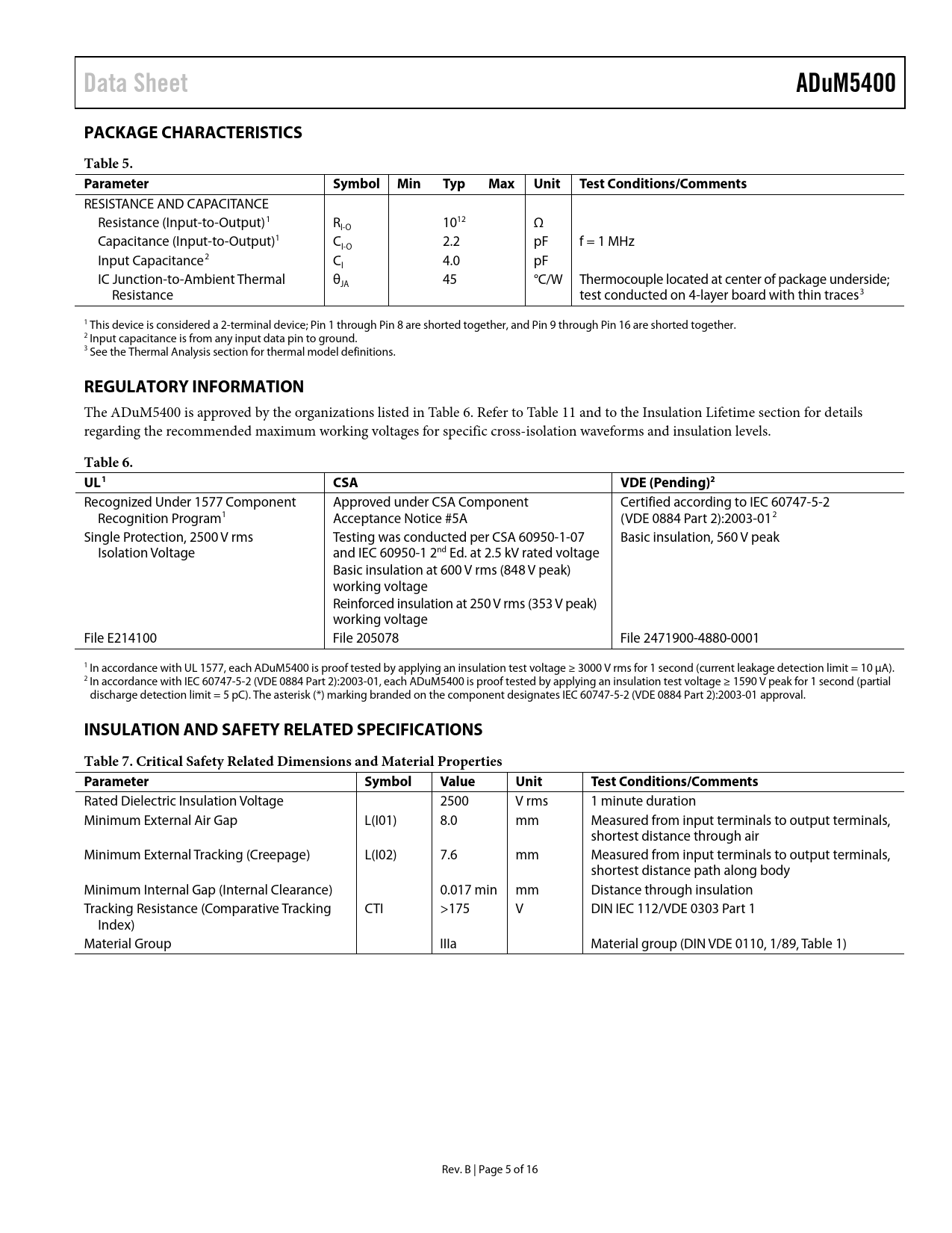

Data Sheet. ADuM5400. PACKAGE CHARACTERISTICS. Table 5. Parameter. Symbol Min. Typ. Max. Unit. Test Conditions/Comments
Data Sheet ADuM5400 PACKAGE CHARACTERISTICS Table 5 Parameter Symbol Min Typ Max Unit Test Conditions/Comments
link to page 15 link to page 5 link to page 7 link to page 15 link to page 5 link to page 5 link to page 5 link to page 5 link to page 5 link to page 5 link to page 5
Data Sheet ADuM5400 PACKAGE CHARACTERISTICS Table 5. Parameter Symbol Min Typ Max Unit Test Conditions/Comments
RESISTANCE AND CAPACITANCE Resistance (Input-to-Output)1 R 1012 Ω I-O Capacitance (Input-to-Output)1 C 2.2 pF f = 1 MHz I-O Input Capacitance2 C 4.0 pF I IC Junction-to-Ambient Thermal θ 45 °C/W Thermocouple located at center of package underside; JA Resistance test conducted on 4-layer board with thin traces3 1 This device is considered a 2-terminal device; Pin 1 through Pin 8 are shorted together, and Pin 9 through Pin 16 are shorted together. 2 Input capacitance is from any input data pin to ground. 3 See the Thermal Analysis section for thermal model definitions.
REGULATORY INFORMATION
The ADuM5400 is approved by the organizations listed in Table 6. Refer to Table 11 and to the Insulation Lifetime section for details regarding the recommended maximum working voltages for specific cross-isolation waveforms and insulation levels.
Table 6. UL1 CSA VDE (Pending)2
Recognized Under 1577 Component Approved under CSA Component Certified according to IEC 60747-5-2 Recognition Program1 Acceptance Notice #5A (VDE 0884 Part 2):2003-012 Single Protection, 2500 V rms Testing was conducted per CSA 60950-1-07 Basic insulation, 560 V peak Isolation Voltage and IEC 60950-1 2nd Ed. at 2.5 kV rated voltage Basic insulation at 600 V rms (848 V peak) working voltage Reinforced insulation at 250 V rms (353 V peak) working voltage File E214100 File 205078 File 2471900-4880-0001 1 In accordance with UL 1577, each ADuM5400 is proof tested by applying an insulation test voltage ≥ 3000 V rms for 1 second (current leakage detection limit = 10 µA). 2 In accordance with IEC 60747-5-2 (VDE 0884 Part 2):2003-01, each ADuM5400 is proof tested by applying an insulation test voltage ≥ 1590 V peak for 1 second (partial discharge detection limit = 5 pC). The asterisk (*) marking branded on the component designates IEC 60747-5-2 (VDE 0884 Part 2):2003-01 approval.
INSULATION AND SAFETY RELATED SPECIFICATIONS Table 7. Critical Safety Related Dimensions and Material Properties Parameter Symbol Value Unit Test Conditions/Comments
Rated Dielectric Insulation Voltage 2500 V rms 1 minute duration Minimum External Air Gap L(I01) 8.0 mm Measured from input terminals to output terminals, shortest distance through air Minimum External Tracking (Creepage) L(I02) 7.6 mm Measured from input terminals to output terminals, shortest distance path along body Minimum Internal Gap (Internal Clearance) 0.017 min mm Distance through insulation Tracking Resistance (Comparative Tracking CTI >175 V DIN IEC 112/VDE 0303 Part 1 Index) Material Group IIIa Material group (DIN VDE 0110, 1/89, Table 1) Rev. B | Page 5 of 16 Document Outline Features Applications General Description Functional Block Diagram Table of Contents Revision History Specifications Electrical Characteristics Package Characteristics Regulatory Information Insulation and Safety Related Specifications IEC 60747-5-2 (VDE 0884, Part 2):2003-01 Insulation Characteristics Recommended Operating Conditions Absolute Maximum Ratings ESD Caution Pin Configuration and Function Descriptions Typical Performance Characteristics Terminology Applications Information PCB Layout EMI Considerations Propagation Delay Parameters DC Correctness and Magnetic Field Immunity Power Consumption Power Considerations Thermal Analysis Insulation Lifetime Outline Dimensions Ordering Guide
