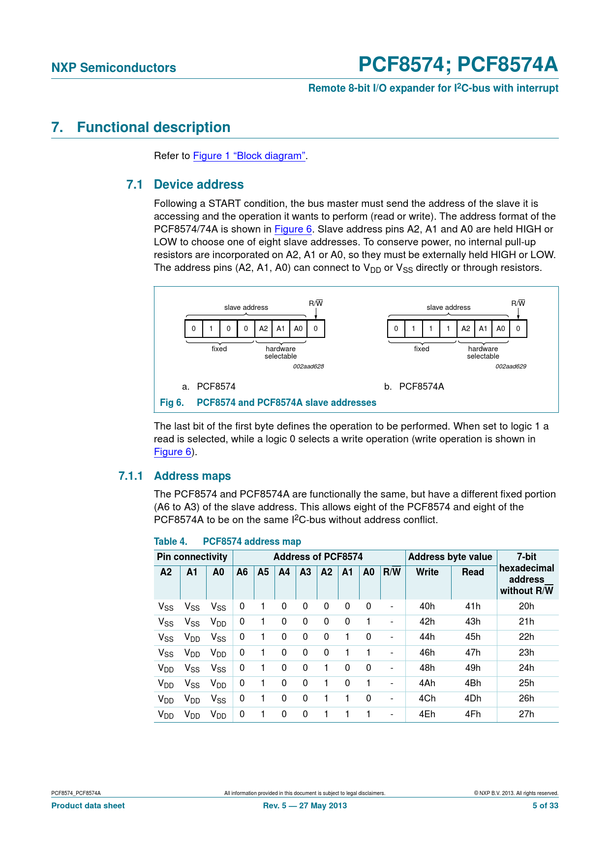

NXP Semiconductors PCF8574; PCF8574A Remote 8-bit I/O expander for I2C-bus with interrupt 7. Functional description
Refer to Figure 1 “Block diagram”.
7.1 Device address
Following a START condition, the bus master must send the address of the slave it is accessing and the operation it wants to perform (read or write). The address format of the PCF8574/74A is shown in Figure 6. Slave address pins A2, A1 and A0 are held HIGH or LOW to choose one of eight slave addresses. To conserve power, no internal pull-up resistors are incorporated on A2, A1 or A0, so they must be externally held HIGH or LOW. The address pins (A2, A1, A0) can connect to VDD or VSS directly or through resistors. R/W R/W slave address slave address 0 1 0 0 A2 A1 A0 0 0 1 1 1 A2 A1 A0 0 fixed hardware fixed hardware selectable selectable 002aad628 002aad629 a. PCF8574 b. PCF8574A
Fig 6. PCF8574 and PCF8574A slave addresses
The last bit of the first byte defines the operation to be performed. When set to logic 1 a read is selected, while a logic 0 selects a write operation (write operation is shown in Figure 6).
7.1.1 Address maps
The PCF8574 and PCF8574A are functionally the same, but have a different fixed portion (A6 to A3) of the slave address. This allows eight of the PCF8574 and eight of the PCF8574A to be on the same I2C-bus without address conflict.
Table 4. PCF8574 address map Pin connectivity Address of PCF8574 Address byte value 7-bit hexadecimal A2 A1 A0 A6 A5 A4 A3 A2 A1 A0 R/W Write Read address without R/W
VSS VSS VSS 0 1 0 0 0 0 0 - 40h 41h 20h VSS VSS VDD 0 1 0 0 0 0 1 - 42h 43h 21h VSS VDD VSS 0 1 0 0 0 1 0 - 44h 45h 22h VSS VDD VDD 0 1 0 0 0 1 1 - 46h 47h 23h VDD VSS VSS 0 1 0 0 1 0 0 - 48h 49h 24h VDD VSS VDD 0 1 0 0 1 0 1 - 4Ah 4Bh 25h VDD VDD VSS 0 1 0 0 1 1 0 - 4Ch 4Dh 26h VDD VDD VDD 0 1 0 0 1 1 1 - 4Eh 4Fh 27h PCF8574_PCF8574A All information provided in this document is subject to legal disclaimers. © NXP B.V. 2013. All rights reserved.
