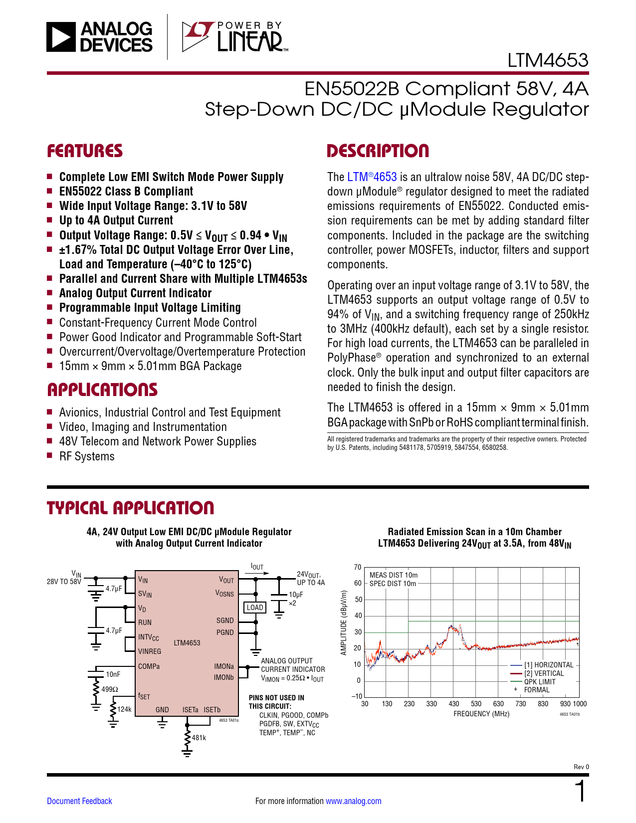

TYPICAL APPLICATION 4A, 24V Output Low EMI DC/DC μModule Regulator Radiated Emission Scan in a 10m Chamber with Analog Output Current Indicator LTM4653 Delivering 24VOUT at 3.5A, from 48VIN
IOUT 70 VIN 24V V OUT, MEAS DIST 10m 28V TO 58V IN VOUT UP TO 4A 60 SPEC DIST 10m 4.7μF SVIN VOSNS 10µF ×2 50 VD LOAD 40 RUN SGND 4.7μF 30 INTV PGND CC LTM4653 VINREG 20 AMPLITUDE (dBµV/m) ANALOG OUTPUT COMPa IMONa 10 CURRENT INDICATOR [1] HORIZONTAL 10nF [2] VERTICAL IMONb VIMON = 0.25Ω • IOUT 0 QPK LIMIT 499Ω + FORMAL fSET
PINS NOT USED IN
–10
THIS CIRCUIT:
30 130 230 330 430 530 630 730 830 930 1000 124k GND ISETa ISETb CLKIN, PGOOD, COMPb FREQUENCY (MHz) 4653 TA01b 4653 TA01a PGDFB, SW, EXTVCC TEMP+, TEMP–, NC 481k Rev 0 Document Feedback For more information www.analog.com 1 Document Outline Features Applications Typical Application Description Absolute Maximum Ratings Order Information Pin Configuration Electrical Characteristics Typical Performance Characteristics Pin Functions Test Circuit Decoupling Requirements Operation Operation Operation Applications Information Typical Applications Package Photograph Package Description Typical Application Related Parts
