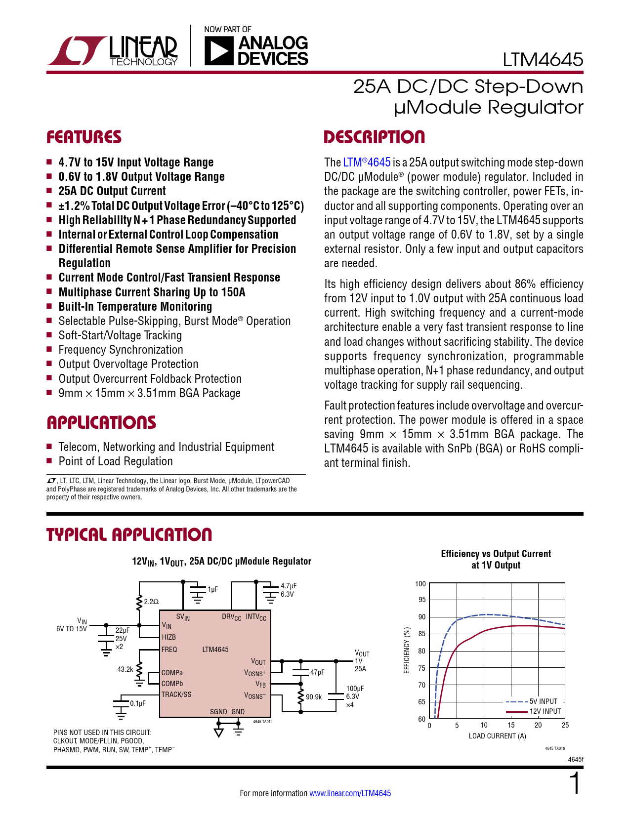

current. High switching frequency and a current-mode n Selectable Pulse-Skipping, Burst Mode® Operation architecture enable a very fast transient response to line n Soft-Start/Voltage Tracking and load changes without sacrificing stability. The device n Frequency Synchronization supports frequency synchronization, programmable n Output Overvoltage Protection multiphase operation, N+1 phase redundancy, and output n Output Overcurrent Foldback Protection voltage tracking for supply rail sequencing. n 9mm × 15mm × 3.51mm BGA Package Fault protection features include overvoltage and overcur- rent protection. The power module is offered in a space

Typical applicaTion Efficiency vs Output Current 12VIN, 1VOUT, 25A DC/DC µModule Regulator at 1V Output
4.7µF 100 1µF 6.3V 2.2Ω 95 SVIN V DRVCC INTVCC 90 IN VIN 6V TO 15V 22µF 85 25V HIZB ×2 FREQ LTM4645 VOUT 80 VOUT 1V 43.2k 75 COMPa V 25A OSNS+ 47pF EFFICIENCY (%) COMPb VFB 100µF 70 TRACK/SS VOSNS– 90.9k 6.3V 0.1µF ×4 65 5V INPUT SGND GND 12V INPUT 60 4645 TA01a 0 5 10 15 20 25 PINS NOT USED IN THIS CIRCUIT: LOAD CURRENT (A) CLKOUT, MODE/PLLIN, PGOOD, PHASMD, PWM, RUN, SW, TEMP+, TEMP– 4645 TA01b 4645f For more information www.linear.com/LTM4645 1 Document Outline Features Applications Description Typical Application Absolute Maximum Ratings Pin Configuration Order Information Electrical Characteristics Typical Performance Characteristics Pin Functions Block Diagram Decoupling Requirements Operation Applications Information Typical Applications Package Description Package Photo Design Resources Related Parts
