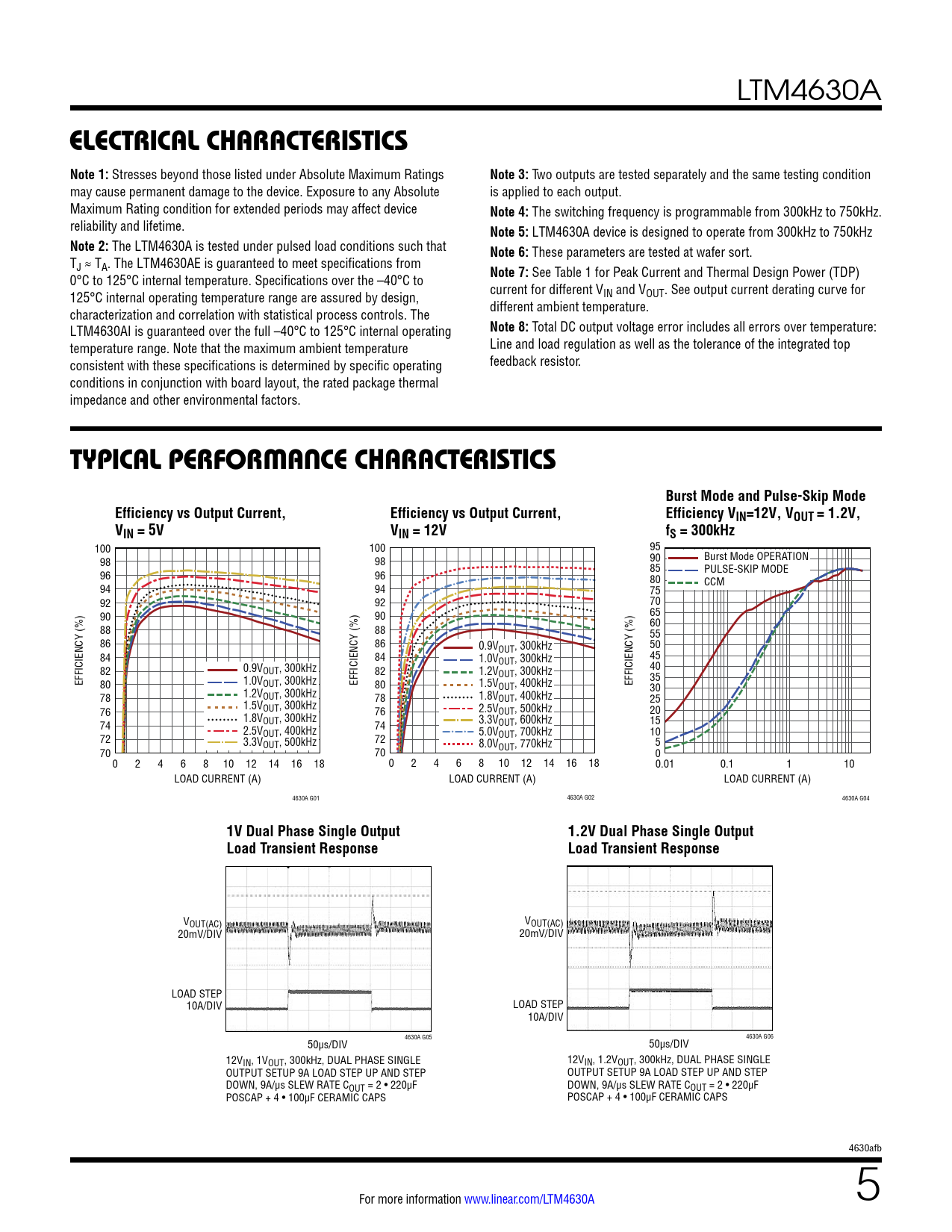

ELECTRICAL CHARACTERISTICS. Note 1:. Note 3:. Note 4:. Note 5:. Note 2:. Note 6:. Note 7:. Note 8:. TYPICAL PERFORMANCE CHARACTERISTICS
ELECTRICAL CHARACTERISTICS Note 1: Note 3: Note 4: Note 5: Note 2: Note 6: Note 7: Note 8: TYPICAL PERFORMANCE CHARACTERISTICS
Note 3:
Two outputs are tested separately and the same testing condition may cause permanent damage to the device. Exposure to any Absolute is applied to each output. Maximum Rating condition for extended periods may affect device
Note 4:
The switching frequency is programmable from 300kHz to 750kHz. reliability and lifetime.
Note 5:
LTM4630A device is designed to operate from 300kHz to 750kHz
Note 2:
The LTM4630A is tested under pulsed load conditions such that
Note 6:
These parameters are tested at wafer sort. TJ ≈ TA. The LTM4630AE is guaranteed to meet specifications from 0°C to 125°C internal temperature. Specifications over the –40°C to
Note 7:
See Table 1 for Peak Current and Thermal Design Power (TDP) 125°C internal operating temperature range are assured by design, current for different VIN and VOUT. See output current derating curve for characterization and correlation with statistical process controls. The different ambient temperature. LTM4630AI is guaranteed over the full –40°C to 125°C internal operating
Note 8:
Total DC output voltage error includes all errors over temperature: temperature range. Note that the maximum ambient temperature Line and load regulation as well as the tolerance of the integrated top consistent with these specifications is determined by specific operating feedback resistor. conditions in conjunction with board layout, the rated package thermal impedance and other environmental factors.
TYPICAL PERFORMANCE CHARACTERISTICS Burst Mode and Pulse-Skip Mode Efficiency vs Output Current, Efficiency vs Output Current, Efficiency VIN=12V, VOUT = 1.2V, VIN = 5V VIN = 12V fS = 300kHz
100 100 95 98 98 90 Burst Mode OPERATION 85 PULSE-SKIP MODE 96 96 80 CCM 94 94 75 92 92 70 90 90 65 60 88 88 55 86 86 0.9VOUT, 300kHz 50 84 84 1.0V 45 OUT, 300kHz 82 0.9VOUT, 300kHz 82 1.2V 40 OUT, 300kHz EFFICIENCY (%) 35 80 1.0VOUT, 300kHz EFFICIENCY (%) 80 1.5VOUT, 400kHz EFFICIENCY (%) 30 78 1.2VOUT, 300kHz 78 1.8VOUT, 400kHz 25 76 1.5VOUT, 300kHz 2.5VOUT, 500kHz 20 1.8V 76 74 OUT, 300kHz 3.3VOUT, 600kHz 15 2.5V 74 5.0V 10 72 OUT, 400kHz OUT, 700kHz 3.3V 72 OUT, 500kHz 8.0V 5 70 70 OUT, 770kHz 0 0 2 4 6 8 10 12 14 16 18 0 2 4 6 8 10 12 14 16 18 0.01 0.1 1 10 LOAD CURRENT (A) LOAD CURRENT (A) LOAD CURRENT (A) 4630A G01 4630A G02 4630A G04
1V Dual Phase Single Output 1.2V Dual Phase Single Output Load Transient Response Load Transient Response
VOUT(AC) VOUT(AC) 20mV/DIV 20mV/DIV LOAD STEP 10A/DIV LOAD STEP 10A/DIV 4630A G05 4630A G06 50µs/DIV 50µs/DIV 12VIN, 1VOUT, 300kHz, DUAL PHASE SINGLE 12VIN, 1.2VOUT, 300kHz, DUAL PHASE SINGLE OUTPUT SETUP 9A LOAD STEP UP AND STEP OUTPUT SETUP 9A LOAD STEP UP AND STEP DOWN, 9A/µs SLEW RATE COUT = 2 • 220µF DOWN, 9A/µs SLEW RATE COUT = 2 • 220µF POSCAP + 4 • 100µF CERAMIC CAPS POSCAP + 4 • 100µF CERAMIC CAPS 4630afb For more information www.linear.com/LTM4630A 5 Document Outline Description Typical Application Absolute Maximum Ratings Pin Configuration Electrical Characteristics Typical Performance Characteristics Pin Functions Operation Applications Information Related Parts
