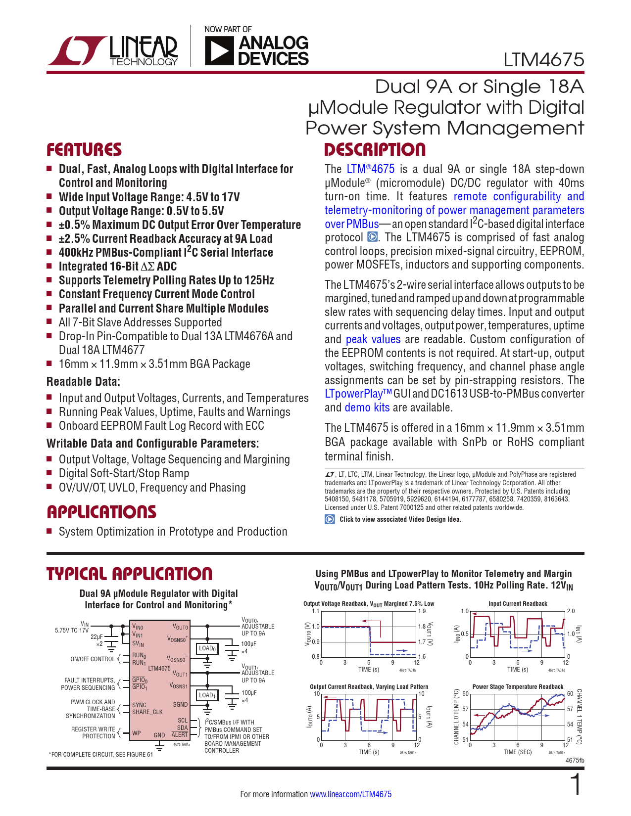

Typical applicaTion Using PMBus and LTpowerPlay to Monitor Telemetry and Margin V Dual 9A µModule Regulator with Digital OUT0/VOUT1 During Load Pattern Tests. 10Hz Polling Rate. 12VIN Interface for Control and Monitoring* Output Voltage Readback, VOUT Margined 7.5% Low Input Current Readback
1.1 1.9 1.0 2.0 V V OUT0, V IN V OUT1 I IN0 VOUT0 ADJUSTABLE 1.0 1.8 IN1 5.75V TO 17V (V) (A) (A) 22µF V UP TO 9A IN1 0.5 1.0 V + (V) OSNS0 ×2 SV 0.9 1.7 I IN0 IN 100µF V OUT0 LOAD0 ×4 ON/OFF CONTROL RUN0 V – OSNS0 0.8 1.6 0 0 RUN1 V 0 3 6 9 12 0 3 6 9 12 LTM4675 OUT1, V TIME (s) 4675 TA01b TIME (s) 4675 TA01d OUT1 ADJUSTABLE FAULT INTERRUPTS, GPIO0 UP TO 9A POWER SEQUENCING V GPIO OSNS1 1
Output Current Readback, Varying Load Pattern Power Stage Temperature Readback
