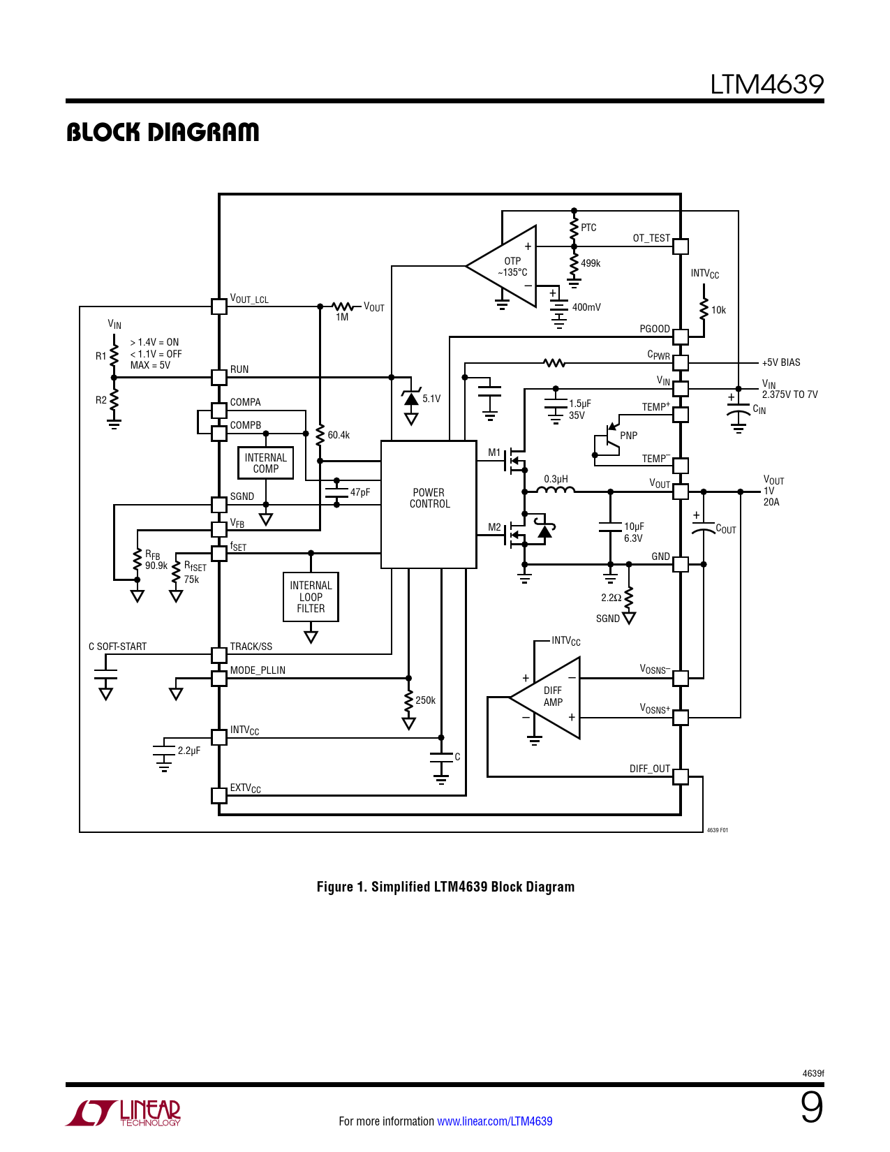

BLOCK DIAGRAM. Figure 1. Simplified LTM4639 Block Diagram
LTM4639
BLOCK DIAGRAM
PTC OT_TEST + OTP 499k ~135°C INTVCC – V + OUT_LCL VOUT 400mV 10k V 1M IN PGOOD > 1.4V = ON R1 < 1.1V = OFF CPWR +5V BIAS MAX = 5V RUN VIN VIN R2 5.1V + 2.375V TO 7V COMPA 1.5µF TEMP+ C 35V IN COMPB 60.4k PNP M1 INTERNAL TEMP– COMP 0.3µH V V OUT OUT 47pF POWER SGND 1V CONTROL 20A + VFB M2 10µF COUT 6.3V fSET RFB GND 90.9k RfSET 75k INTERNAL LOOP 2.2Ω FILTER SGND C SOFT-START INTV TRACK/SS CC MODE_PLLIN + – VOSNS– DIFF 250k – AMP + VOSNS+ INTVCC 2.2µF C DIFF_OUT EXTVCC 4639 F01
