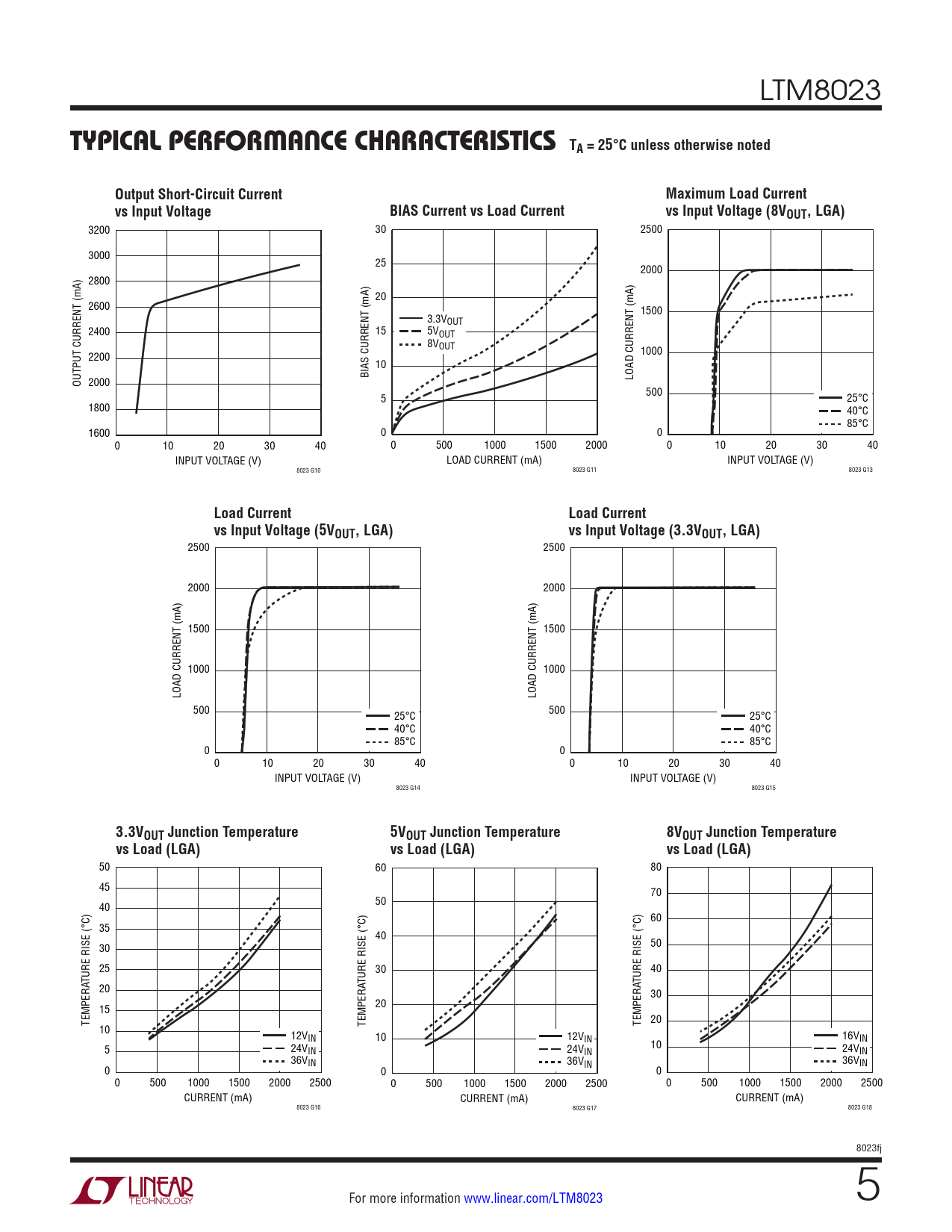

TYPICAL PERFORMANCE CHARACTERISTICS TA = 25°C unless otherwise noted. Output Short-Circuit Current. Maximum Load Current
TYPICAL PERFORMANCE CHARACTERISTICS TA = 25°C unless otherwise noted Output Short-Circuit Current Maximum Load Current
LTM8023
TYPICAL PERFORMANCE CHARACTERISTICS TA = 25°C unless otherwise noted Output Short-Circuit Current Maximum Load Current vs Input Voltage BIAS Current vs Load Current vs Input Voltage (8VOUT, LGA)
3200 30 2500 3000 25 2000 2800 20 2600 1500 3.3VOUT 2400 15 5VOUT 8VOUT 1000 2200 10 BIAS CURRENT (mA) LOAD CURRENT (mA) OUTPUT CURRENT (mA) 2000 500 5 25°C 1800 40°C 85°C 1600 0 0 0 10 20 30 40 0 500 1000 1500 2000 0 10 20 30 40 INPUT VOLTAGE (V) LOAD CURRENT (mA) INPUT VOLTAGE (V) 8023 G10 8023 G11 8023 G13
Load Current Load Current vs Input Voltage (5VOUT, LGA) vs Input Voltage (3.3VOUT, LGA)
2500 2500 2000 2000 1500 1500 1000 1000 LOAD CURRENT (mA) LOAD CURRENT (mA) 500 25°C 500 25°C 40°C 40°C 85°C 85°C 0 0 0 10 20 30 40 0 10 20 30 40 INPUT VOLTAGE (V) INPUT VOLTAGE (V) 8023 G14 8023 G15
3.3VOUT Junction Temperature 5VOUT Junction Temperature 8VOUT Junction Temperature vs Load (LGA) vs Load (LGA) vs Load (LGA)
50 60 80 45 70 40 50 60 35 40 30 50 25 30 40 TURE RISE (°C) TURE RISE (°C) TURE RISE (°C) 20 30 15 20 TEMPERA TEMPERA TEMPERA 20 10 12VIN 10 12VIN 16VIN 5 24V 10 IN 24VIN 24VIN 36VIN 36V 36VIN 0 IN 0 0 0 500 1000 1500 2000 2500 0 500 1000 1500 2000 2500 0 500 1000 1500 2000 2500 CURRENT (mA) CURRENT (mA) CURRENT (mA) 8023 G16 8023 G17 8023 G18 8023fj For more information www.linear.com/LTM8023 5
