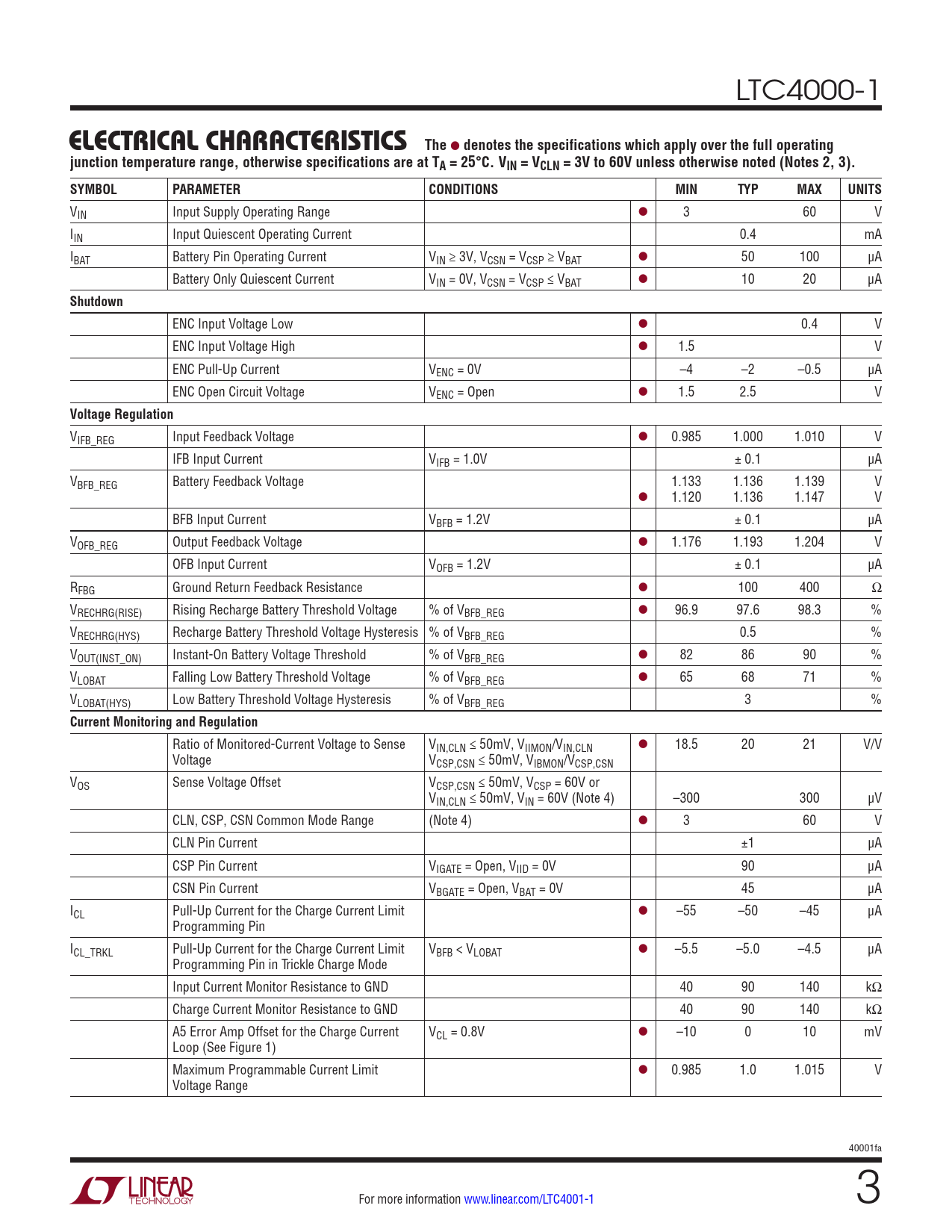

e lecTrical characTerisTics The. denotes the specifications which apply over the full operating
e lecTrical characTerisTics The denotes the specifications which apply over the full operating
LTC4000-1
l
denotes the specifications which apply over the full operating junction temperature range, otherwise specifications are at TA = 25°C. VIN = VCLN = 3V to 60V unless otherwise noted (Notes 2, 3). SYMBOL PARAMETER CONDITIONS MIN TYP MAX UNITS
VIN Input Supply Operating Range l 3 60 V IIN Input Quiescent Operating Current 0.4 mA IBAT Battery Pin Operating Current VIN ≥ 3V, VCSN = VCSP ≥ VBAT l 50 100 µA Battery Only Quiescent Current VIN = 0V, VCSN = VCSP ≤ VBAT l 10 20 μA
Shutdown
ENC Input Voltage Low l 0.4 V ENC Input Voltage High l 1.5 V ENC Pull-Up Current VENC = 0V –4 –2 –0.5 µA ENC Open Circuit Voltage VENC = Open l 1.5 2.5 V
Voltage Regulation
VIFB_REG Input Feedback Voltage l 0.985 1.000 1.010 V IFB Input Current VIFB = 1.0V ± 0.1 µA VBFB_REG Battery Feedback Voltage 1.133 1.136 1.139 V l 1.120 1.136 1.147 V BFB Input Current VBFB = 1.2V ± 0.1 µA VOFB_REG Output Feedback Voltage l 1.176 1.193 1.204 V OFB Input Current VOFB = 1.2V ± 0.1 µA RFBG Ground Return Feedback Resistance l 100 400 Ω VRECHRG(RISE) Rising Recharge Battery Threshold Voltage % of VBFB_REG l 96.9 97.6 98.3 % VRECHRG(HYS) Recharge Battery Threshold Voltage Hysteresis % of VBFB_REG 0.5 % VOUT(INST_ON) Instant-On Battery Voltage Threshold % of VBFB_REG l 82 86 90 % VLOBAT Falling Low Battery Threshold Voltage % of VBFB_REG l 65 68 71 % VLOBAT(HYS) Low Battery Threshold Voltage Hysteresis % of VBFB_REG 3 %
Current Monitoring and Regulation
