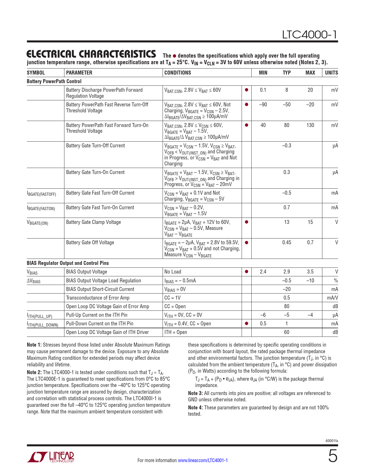

e lecTrical characTerisTics The. denotes the specifications which apply over the full operating
e lecTrical characTerisTics The denotes the specifications which apply over the full operating
LTC4000-1
l
denotes the specifications which apply over the full operating junction temperature range, otherwise specifications are at TA = 25°C. VIN = VCLN = 3V to 60V unless otherwise noted (Notes 2, 3). SYMBOL PARAMETER CONDITIONS MIN TYP MAX UNITS Battery PowerPath Control
Battery Discharge PowerPath Forward VBAT,CSN, 2.8V ≤ VBAT ≤ 60V l 0.1 8 20 mV Regulation Voltage Battery PowerPath Fast Reverse Turn-Off VBAT,CSN, 2.8V ≤ VBAT ≤ 60V, Not l –90 –50 –20 mV Threshold Voltage Charging, VBGATE = VCSN – 2.5V, ∆IBGATE/∆VBAT,CSN ≥ 100μA/mV Battery PowerPath Fast Forward Turn-On VBAT,CSN, 2.8V ≤ VCSN ≤ 60V, l 40 80 130 mV Threshold Voltage VBGATE = VBAT – 1.5V, ∆IBGATE/∆ VBAT,CSN ≥ 100μA/mV Battery Gate Turn-Off Current VBGATE = VCSN – 1.5V, VCSN ≥ VBAT, –0.3 μA VOFB < VOUT(INST_ON) and Charging in Progress, or VCSN = VBAT and Not Charging Battery Gate Turn-On Current VBGATE = VBAT – 1.5V, VCSN ≥ VBAT, 0.3 μA VOFB > VOUT(INST_ON) and Charging in Progress, or VCSN = VBAT – 20mV IBGATE(FASTOFF) Battery Gate Fast Turn-Off Current VCSN = VBAT + 0.1V and Not –0.5 mA Charging, VBGATE = VCSN – 5V IBGATE(FASTON) Battery Gate Fast Turn-On Current VCSN = VBAT – 0.2V, 0.7 mA VBGATE = VBAT – 1.5V VBGATE(ON) Battery Gate Clamp Voltage IBGATE = 2μA, VBAT = 12V to 60V, l 13 15 V VCSN = VBAT – 0.5V, Measure VBAT – VBGATE Battery Gate Off Voltage IBGATE = – 2μA, VBAT = 2.8V to 59.5V, l 0.45 0.7 V VCSN = VBAT + 0.5V and not Charging, Measure VCSN – VBGATE
BIAS Regulator Output and Control Pins
VBIAS BIAS Output Voltage No Load l 2.4 2.9 3.5 V ∆VBIAS BIAS Output Voltage Load Regulation IBIAS = – 0.5mA –0.5 –10 % BIAS Output Short-Circuit Current VBIAS = 0V –20 mA Transconductance of Error Amp CC = 1V 0.5 mA/V Open Loop DC Voltage Gain of Error Amp CC = Open 80 dB IITH(PULL_UP) Pull-Up Current on the ITH Pin VITH = 0V, CC = 0V –6 –5 –4 μA IITH(PULL_DOWN) Pull-Down Current on the ITH Pin VITH = 0.4V, CC = Open l 0.5 1 mA Open Loop DC Voltage Gain of ITH Driver ITH = Open 60 dB
Note 1:
Stresses beyond those listed under Absolute Maximum Ratings these specifications is determined by specific operating conditions in may cause permanent damage to the device. Exposure to any Absolute conjunction with board layout, the rated package thermal impedance Maximum Rating condition for extended periods may affect device and other environmental factors. The junction temperature (TJ, in °C) is reliability and lifetime. calculated from the ambient temperature (TA, in °C) and power dissipation
Note 2:
The LTC4000-1 is tested under conditions such that T (P J ≈ TA. D, in Watts) according to the following formula: The LTC4000E-1 is guaranteed to meet specifications from 0°C to 85°C TJ = TA + (PD • θJA), where θJA (in °C/W) is the package thermal junction temperature. Specifications over the –40°C to 125°C operating impedance. junction temperature range are assured by design, characterization
Note 3:
All currents into pins are positive; all voltages are referenced to and correlation with statistical process controls. The LTC4000I-1 is GND unless otherwise noted. guaranteed over the full –40°C to 125°C operating junction temperature
Note 4:
These parameters are guaranteed by design and are not 100% range. Note that the maximum ambient temperature consistent with tested. 40001fa For more information www.linear.com/LTC4001-1 5 Document Outline Features Applications Description Typical Application Absolute Maximum Ratings Pin Configuration Order Information Electrical Characteristics Typical Performance Characteristics Pin Functions Block Diagram Operation Applications Information Typical Applications Package Description Typical Application Related Parts
