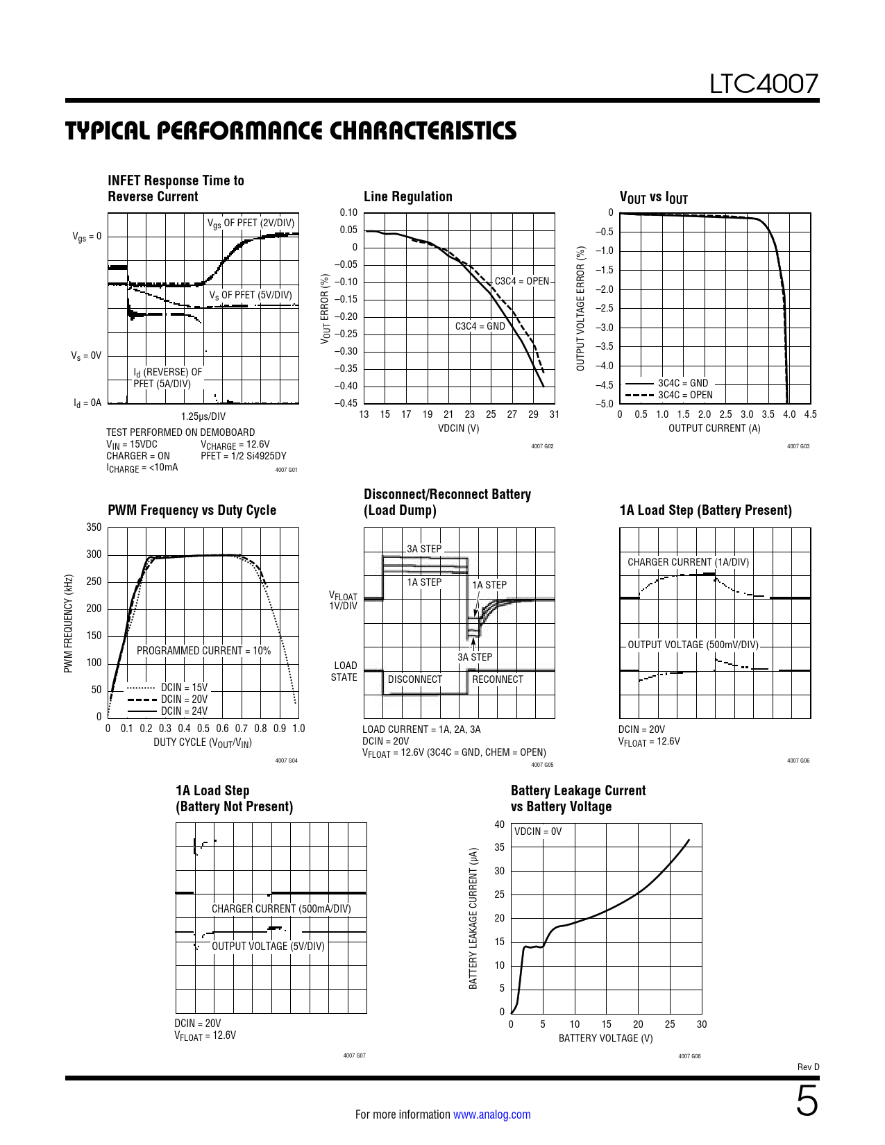

TYPICAL PERFORMANCE CHARACTERISTICS. INFET Response Time to. Reverse Current. Line Regulation. VOUT vs IOUT
LTC4007
TYPICAL PERFORMANCE CHARACTERISTICS INFET Response Time to Reverse Current Line Regulation VOUT vs IOUT
0.10 0 Vgs OF PFET (2V/DIV) V 0.05 –0.5 gs = 0 0 –1.0 –0.05 –1.5 –0.10 C3C4 = OPEN V –2.0 s OF PFET (5V/DIV) –0.15 –2.5 ERROR (%) –0.20 C3C4 = GND –3.0 –0.25 V OUT –3.5 V –0.30 s = 0V –4.0 I –0.35 OUTPUT VOLTAGE ERROR (%) d (REVERSE) OF PFET (5A/DIV) –0.40 –4.5 3C4C = GND 3C4C = OPEN Id = 0A –0.45 –5.0 1.25µs/DIV 13 15 17 19 21 23 25 27 29 31 0 0.5 1.0 1.5 2.0 2.5 3.0 3.5 4.0 4.5 TEST PERFORMED ON DEMOBOARD VDCIN (V) OUTPUT CURRENT (A) VIN = 15VDC VCHARGE = 12.6V 4007 G02 4007 G03 CHARGER = ON PFET = 1/2 Si4925DY ICHARGE = <10mA 4007 G01
Disconnect/Reconnect Battery PWM Frequency vs Duty Cycle (Load Dump) 1A Load Step (Battery Present)
350 300 3A STEP CHARGER CURRENT (1A/DIV) 250 1A STEP 1A STEP VFLOAT 200 1V/DIV 150 PROGRAMMED CURRENT = 10% OUTPUT VOLTAGE (500mV/DIV) 100 3A STEP PWM FREQUENCY (kHz) LOAD STATE DISCONNECT RECONNECT 50 DCIN = 15V DCIN = 20V DCIN = 24V 0 0 0.1 0.2 0.3 0.4 0.5 0.6 0.7 0.8 0.9 1.0 LOAD CURRENT = 1A, 2A, 3A DCIN = 20V DUTY CYCLE (VOUT/VIN) DCIN = 20V VFLOAT = 12.6V VFLOAT = 12.6V (3C4C = GND, CHEM = OPEN) 4007 G04 4007 G06 4007 G05
1A Load Step Battery Leakage Current (Battery Not Present) vs Battery Voltage
40 VDCIN = 0V 35 30 25 CHARGER CURRENT (500mA/DIV) 20 OUTPUT VOLTAGE (5V/DIV) 15 10 BATTERY LEAKAGE CURRENT (µA) 5 0 DCIN = 20V 0 5 10 15 20 25 30 VFLOAT = 12.6V BATTERY VOLTAGE (V) 4007 G07 4007 G08 Rev D For more information www.analog.com 5 Document Outline Description Typical Application Absolute Maximum Ratings Electrical Characteristics Typical Performance Characteristics Pin Functions Block Diagram Operation Applications Information Package Description Typical Application Related Parts Features Applications Typical Application Description Absolute Maximum Ratings Order Information Electrical Characteristics Pin Configuration Electrical Characteristics Typical Performance Characteristics Pin Functions Block Diagram Test Circuit Operation Applications Information Package Description Revision History Typical Application Related Parts
