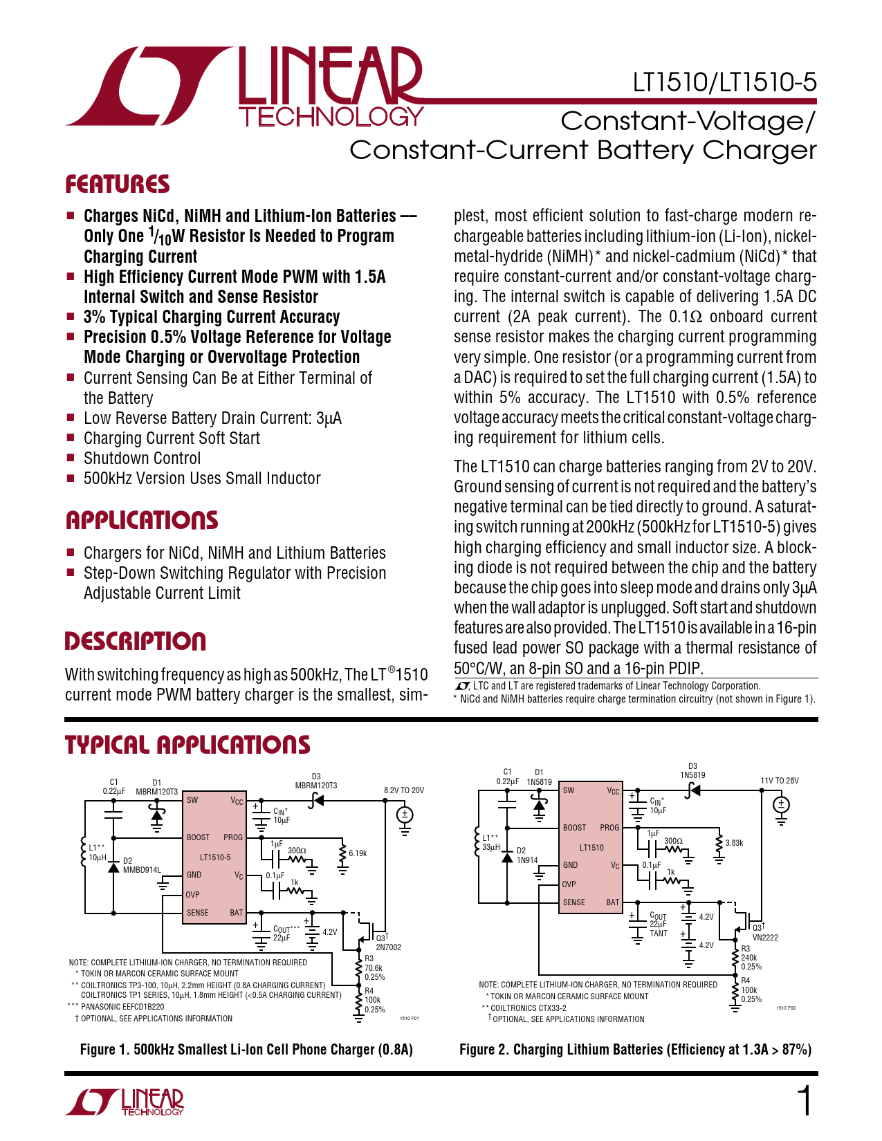

U TYPICAL APPLICATIONS
D3 C1 D3 D1 1N5819 C1 D1 0.22µF 1N5819 11V TO 28V MBRM120T3 0.22µF MBRM120T3 8.2V TO 20V SW VCC + SW VCC + CIN* + C – IN* + 10µF 10µF – BOOST PROG 1µF BOOST PROG L1** 1µF 300Ω 3.83k L1** 300Ω 33µH LT1510 6.19k D2 10µH LT1510-5 D2 1N914 GND V 0.1µF MMBD914L C GND V 1k C 0.1µF 1k OVP OVP SENSE BAT + SENSE BAT + + COUT 4.2V + 22µF COUT*** Q3† 4.2V TANT + 22µF Q3† VN2222 2N7002 4.2V R3 R3 240k NOTE: COMPLETE LITHIUM-ION CHARGER, NO TERMINATION REQUIRED 70.6k 0.25% TOKIN OR MARCON CERAMIC SURFACE MOUNT * 0.25% R4 COILTRONICS TP3-100, 10 ** µH, 2.2mm HEIGHT (0.8A CHARGING CURRENT) NOTE: COMPLETE LITHIUM-ION CHARGER, NO TERMINATION REQUIRED R4 100k COILTRONICS TP1 SERIES, 10µH, 1.8mm HEIGHT (<0.5A CHARGING CURRENT) 100k * TOKIN OR MARCON CERAMIC SURFACE MOUNT 0.25% PANASONIC EEFCD1B220 *** 0.25% ** COILTRONICS CTX33-2 1510 F02 OPTIONAL, SEE APPLICATIONS INFORMATION † 1510 F01 † OPTIONAL, SEE APPLICATIONS INFORMATION
Figure 1. 500kHz Smallest Li-Ion Cell Phone Charger (0.8A) Figure 2. Charging Lithium Batteries (Efficiency at 1.3A > 87%)
