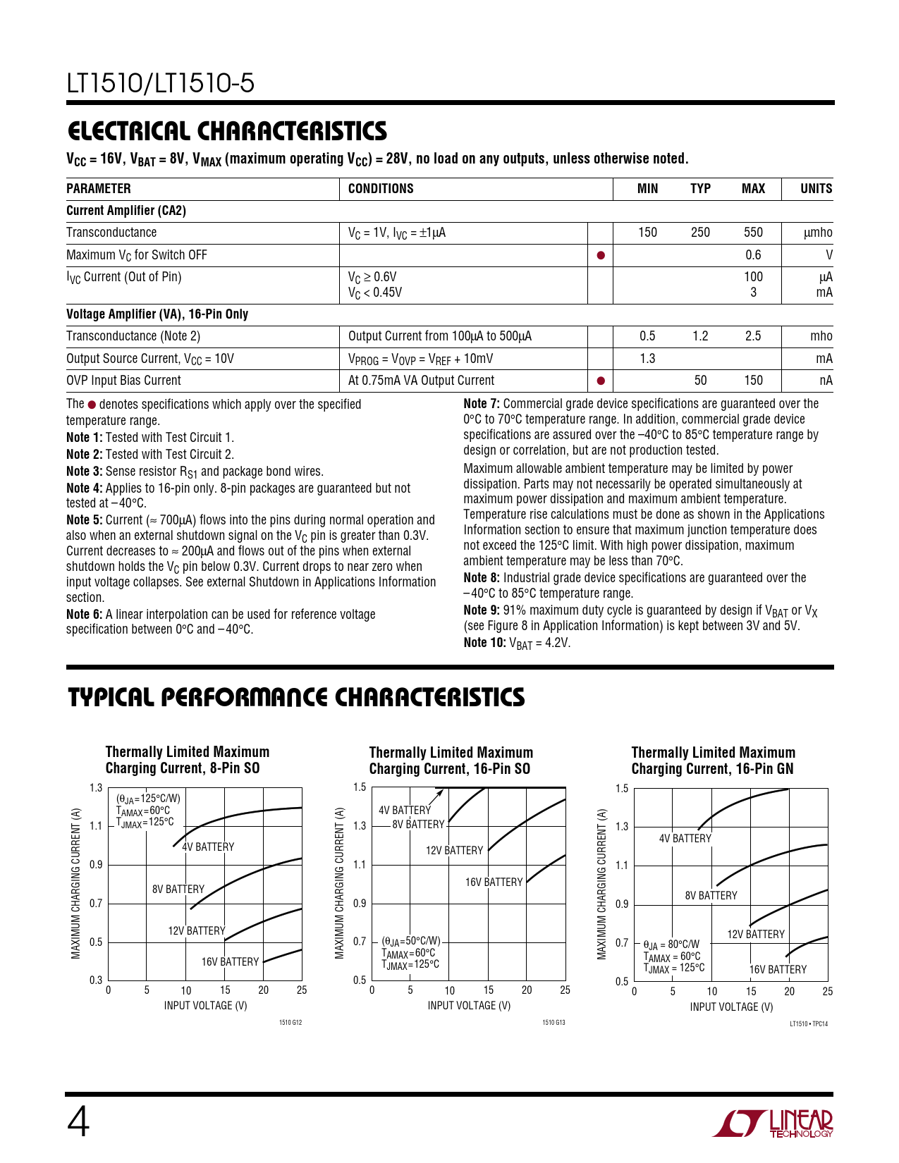

ELECTRICAL CHARACTERISTICS
LT1510/LT1510-5
ELECTRICAL CHARACTERISTICS VCC = 16V, VBAT = 8V, VMAX (maximum operating VCC) = 28V, no load on any outputs, unless otherwise noted. PARAMETER CONDITIONS MIN TYP MAX UNITS Current Amplifier (CA2)
Transconductance VC = 1V, IVC = ±1µA 150 250 550 µmho Maximum VC for Switch OFF ● 0.6 V IVC Current (Out of Pin) VC ≥ 0.6V 100 µA VC < 0.45V 3 mA
Voltage Amplifier (VA), 16-Pin Only
Transconductance (Note 2) Output Current from 100µA to 500µA 0.5 1.2 2.5 mho Output Source Current, VCC = 10V VPROG = VOVP = VREF + 10mV 1.3 mA OVP Input Bias Current At 0.75mA VA Output Current ● 50 150 nA The ● denotes specifications which apply over the specified
Note 7:
Commercial grade device specifications are guaranteed over the temperature range. 0°C to 70°C temperature range. In addition, commercial grade device
Note 1:
Tested with Test Circuit 1. specifications are assured over the –40°C to 85°C temperature range by
Note 2:
Tested with Test Circuit 2. design or correlation, but are not production tested.
Note 3:
Sense resistor R Maximum allowable ambient temperature may be limited by power S1 and package bond wires.
Note 4:
Applies to 16-pin only. 8-pin packages are guaranteed but not dissipation. Parts may not necessarily be operated simultaneously at tested at – 40°C. maximum power dissipation and maximum ambient temperature.
Note 5:
Current (≈ 700µA) flows into the pins during normal operation and Temperature rise calculations must be done as shown in the Applications also when an external shutdown signal on the V Information section to ensure that maximum junction temperature does C pin is greater than 0.3V. Current decreases to ≈ 200µA and flows out of the pins when external not exceed the 125°C limit. With high power dissipation, maximum shutdown holds the V ambient temperature may be less than 70°C. C pin below 0.3V. Current drops to near zero when input voltage collapses. See external Shutdown in Applications Information
Note 8:
Industrial grade device specifications are guaranteed over the section. – 40°C to 85°C temperature range.
Note 6:
A linear interpolation can be used for reference voltage
Note 9:
91% maximum duty cycle is guaranteed by design if VBAT or VX specification between 0°C and – 40°C. (see Figure 8 in Application Information) is kept between 3V and 5V.
Note 10:
VBAT = 4.2V.
W U TYPICAL PERFORMANCE CHARACTERISTICS Thermally Limited Maximum Thermally Limited Maximum Thermally Limited Maximum Charging Current, 8-Pin SO Charging Current, 16-Pin SO Charging Current, 16-Pin GN
1.3 1.5 1.5 (θJA=125°C/W) TAMAX=60°C 4V BATTERY 1.1 TJMAX=125°C 1.3 8V BATTERY 1.3 4V BATTERY 4V BATTERY 12V BATTERY 0.9 1.1 1.1 16V BATTERY 8V BATTERY 8V BATTERY 0.7 0.9 0.9 12V BATTERY 12V BATTERY 0.5 0.7 (θJA=50°C/W) 0.7 θJA = 80°C/W MAXIMUM CHARGING CURRENT (A) MAXIMUM CHARGING CURRENT (A) TAMAX=60°C MAXIMUM CHARGING CURRENT (A) T 16V BATTERY AMAX = 60°C TJMAX=125°C TJMAX = 125°C 16V BATTERY 0.3 0.5 0.5 0 5 10 15 20 25 0 5 10 15 20 25 0 5 10 15 20 25 INPUT VOLTAGE (V) INPUT VOLTAGE (V) INPUT VOLTAGE (V) 1510 G12 1510 G13 LT1510 • TPC14 4
