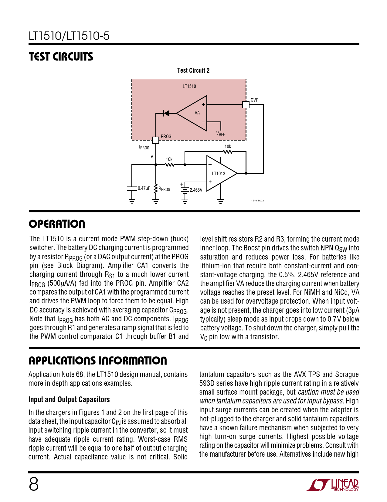

TEST CIRCUITS Test Circuit 2
LT1510 OVP + VA – VREF PROG I 10k PROG 10k – LT1013 + + 0.47µF RPROG 2.465V 1510 TC02
